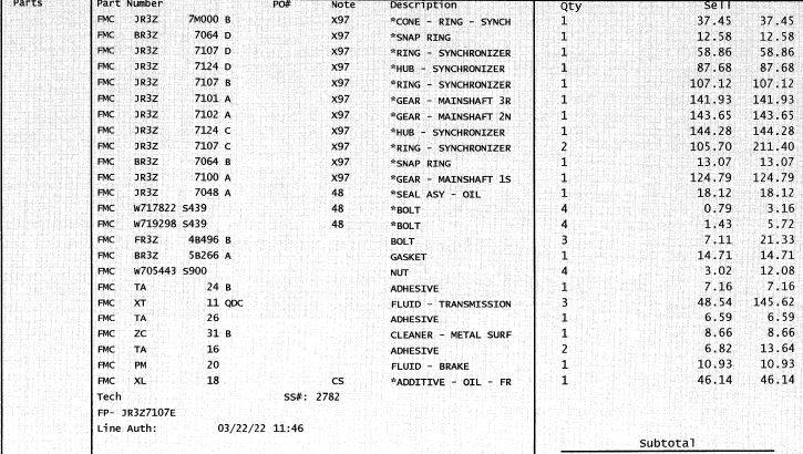

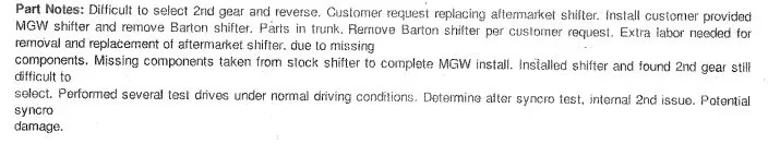

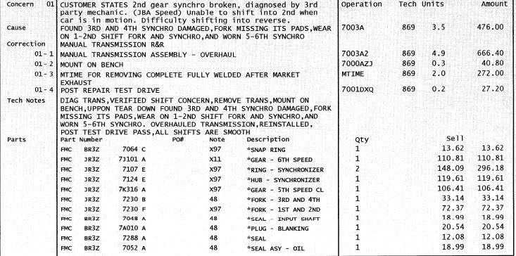

Currently, having issue shifting into 2nd gear in high RPM (>4k or so). I followed most of the steps recommended in the forums such as switching to an MGW and I even got it diagnosed twice, once at a performance shop and the other at the dealer. I've included the logs below.
They say it was a synchro issue and it seems they've replaced a lot of the component but the issue remains.
