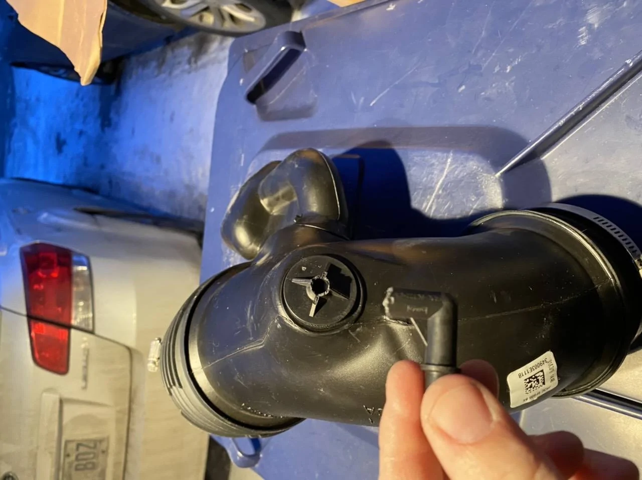

Just received the poorly packaged air box and the small vacuum fitting on the elbow was broken off. Is this fitting still used with the 18+ manifold?
i guess I will try and use some epoxy to glue it back on
not sure if you found your answer but if you are using lockouts then im pretty sure that is plugged.
OK, thanks. I'll cross that road when I get to installing it with the intake manifold. Now the hunt for a deal on the intake manifold and tuner....I love deals
