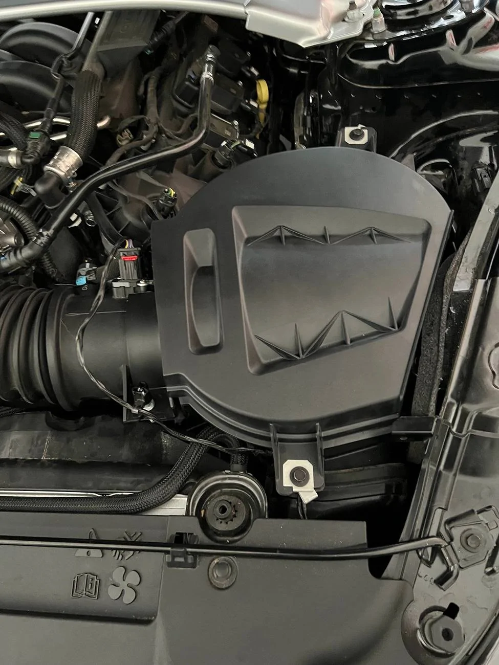

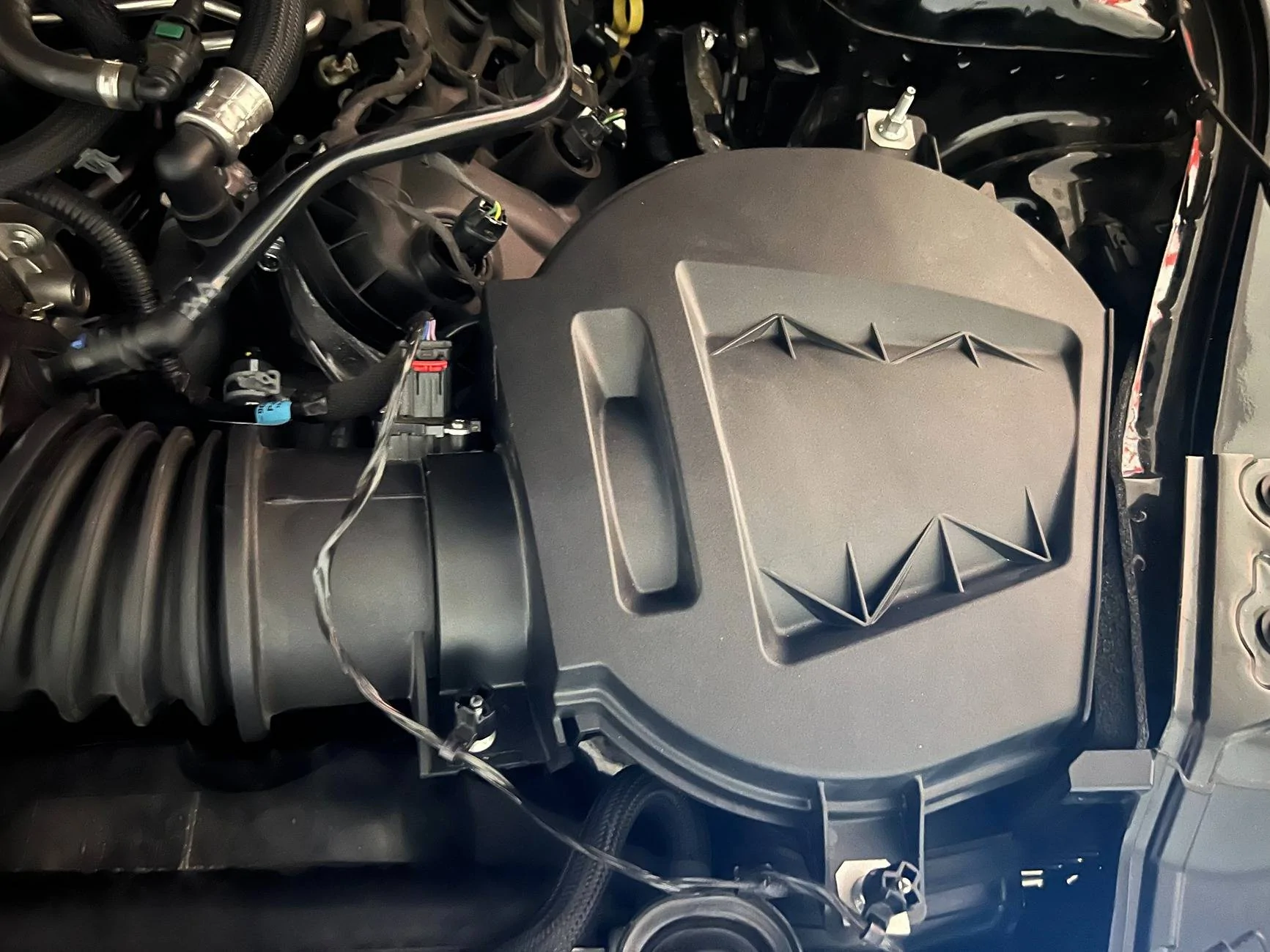

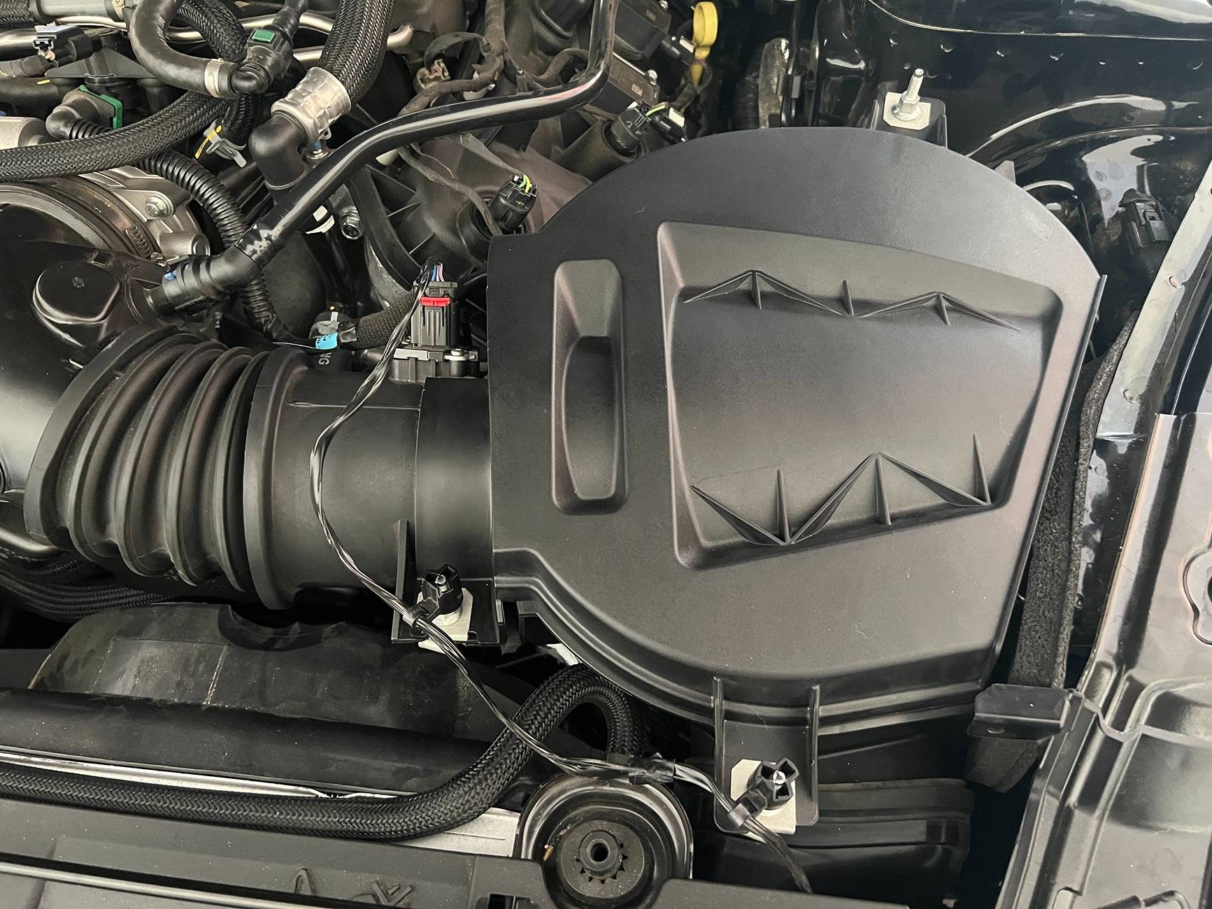

I just installed the GT500 airbox and installed a heat shield.

I removed the black bolts and transferred the other metal clips from my oem airbox, now looks like it could be stock.

Where are you guys getting all the extra wire for the MAF sensor?
That's normal for 22 and 23 mach 1's, they changed the intake slightly and that was one of the changes. Moved the maf to the other side and lengthened the wire. Probably from the carbon trap being in the way or something.

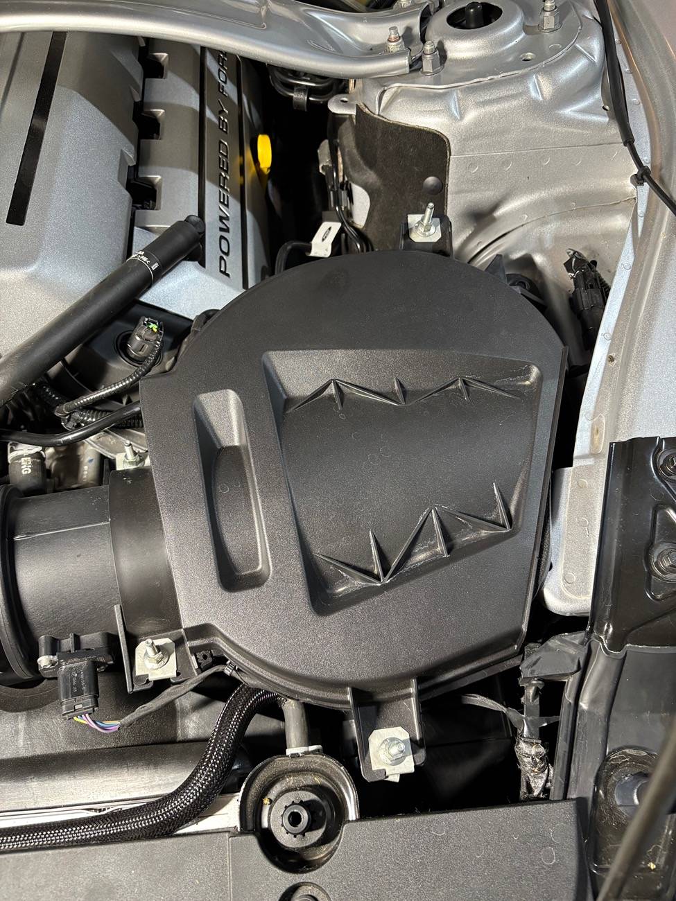

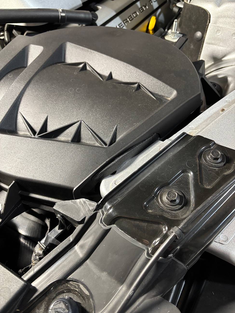

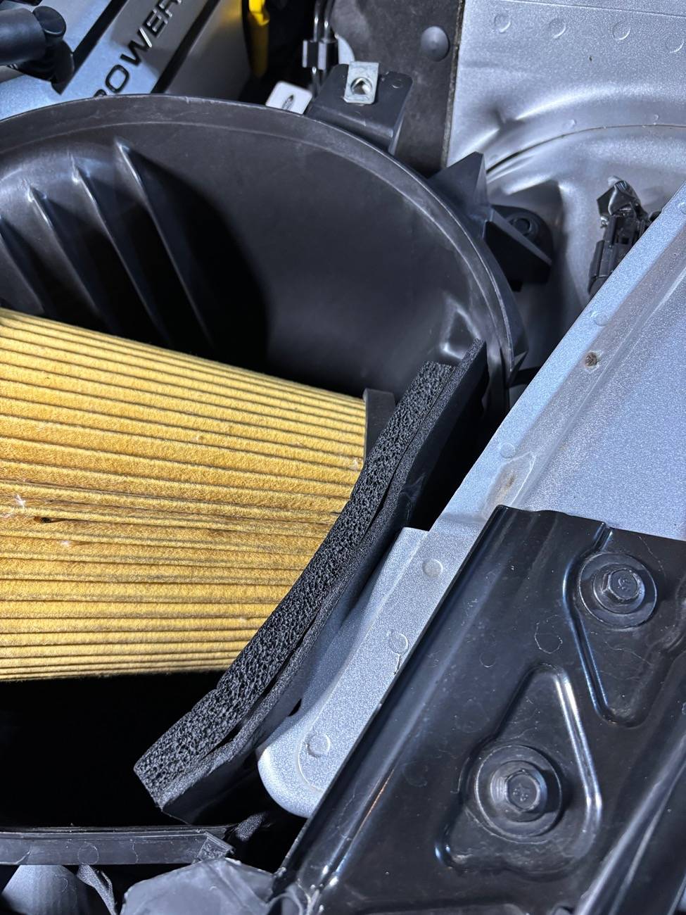

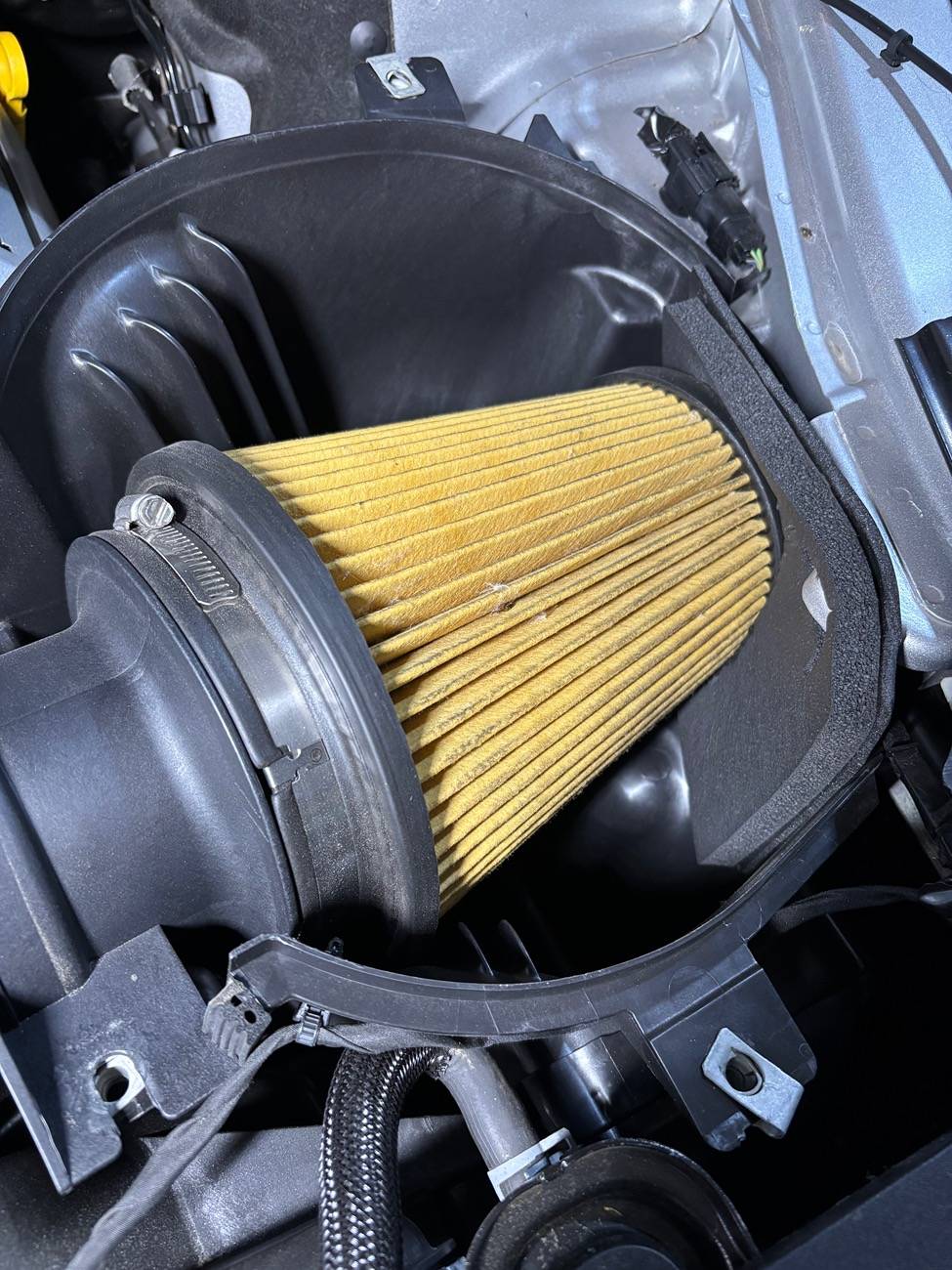

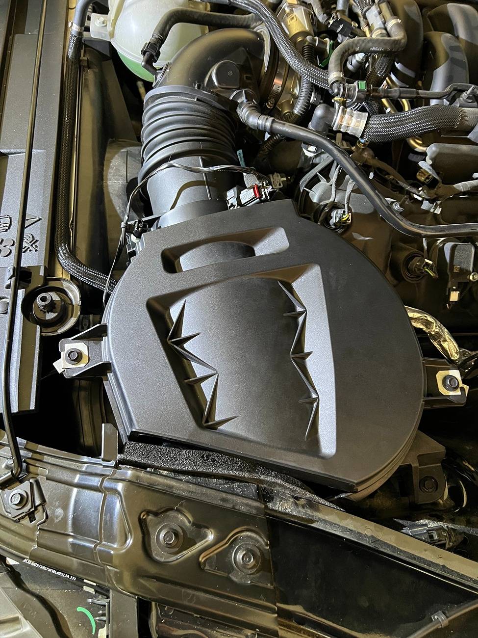

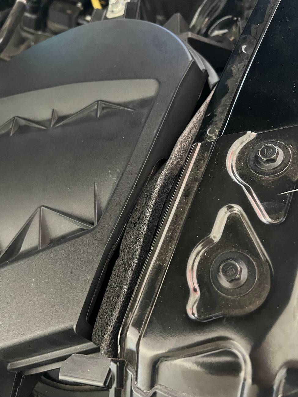

I replaced my air filter and put more insulation under the lid so it may look open but it is not now.
Sorry it took so long. My foam piece is inside the airbox. And the slot still wraps around a frame member. Here are some pictures. Let me know if this works, and I have a 2017, which may be different than your mach1.
