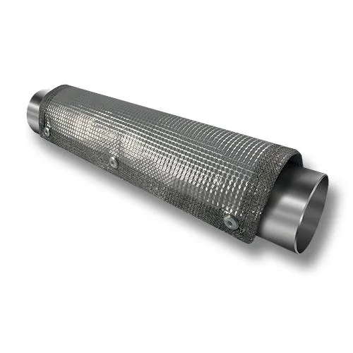

The exhaust radiates an insane amount of heat, think it's literally the hottest thing outside of the engine. I didn't realize how much until I changed my exhaust and started getting crazy heat through the transmission tunnel doing hot laps. The exhaust runs even closer to that nice cast iron diff housing (why do we use cast iron for cooking?) what's needed is some proper heat shielding (not header wrap) to block that radiant heat. It's like if Ford was designing the exhaust to warm up the diff quickly, they did a great job, but unless you're in sub zero temps all the time it's a problem! Motorcycle style standoff heat shields would go miles toward improving the situation, and are not expensive. That plus a fluid change would be the easiest/cheapest/quickest first steps to take.
Couple different clamp-on heat shields can be found here: https://www.thermotec.com/products/heat-shields-and-protection
I ordered some heat shields for testing, just need to figure out how to access the factory temp sensor. I could rig some thermocouples on the outside but that's not oil temp or what the ECU is seeing.
@aleccolin Did you ever test the heat shields? Really liking this idea, especially that first flexible version for the exhaust curve around the diff.
No, I’ve been meaning to follow up but life got in the way and I haven’t even driven my car in while let alone worked on it. My intent is to get this done as soon as the weather breaks and I can get the Mustang on the lift. I’ll definitely report back with (hopefully) something substantive.

I'll be using this wrap. Unfortunately there doesn't appear to be much in the way (any?) flat areas on the entire housing. I'm tempted to bolt on some copper CPU coolers with heat paste if I can find a suitable spot. Doubtful. What would be useful is to mill micro-grooves (say 3mm wide and 2mm deep - not sure how thick that casting is.) into the housing and dramatically increase the surface area of the casing.
