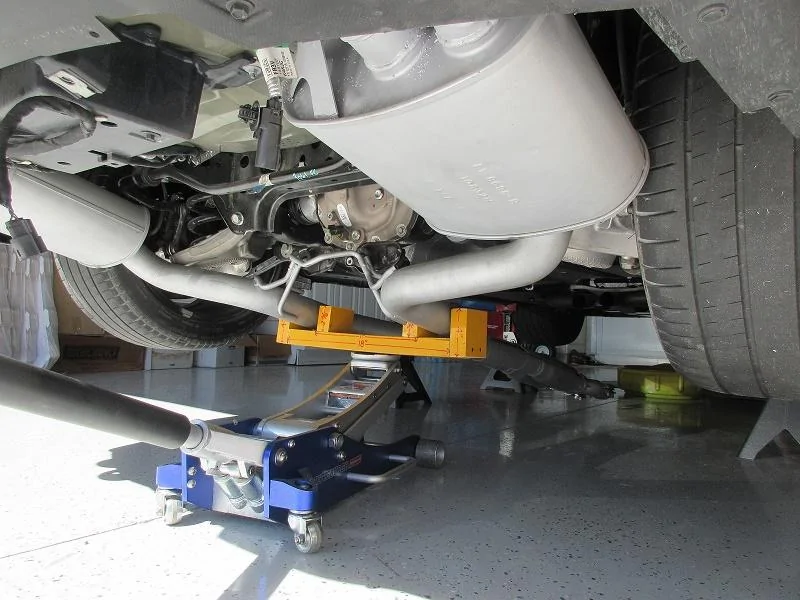

Coupke weeks back I jacked all four corners up and spent several hours under the car.
It is very tight under there.
I know this could be solved simply and cheaply, but so massively busy w work.
Would love to have time to design an “air box” or air curtain for anything putting heat into the pinion, half shafts and case...
Wrap exhaust from cats back to 18” past diff.
Cheap aluminum flashing from Home Depot cut to a pattern to allow a scoop or high temp silicon line feed from front bumper.

Just completed a track weekend after wrapping the exhaust around the diff and switching to Royal Purple 75W140. Temps each day were 80-85 at the highest and pretty humid. I never received even the first warning. Most sessions I ran the full 20 minutes and ran hard for most of it as I was running RE71R tires and they were holding up well for almost all sessions. I ran with Advance Track off. I may still consider the FTB cooler eventually but for my purposes I may be OK without it.
Side note: took second in my class (stock cars running 200TW tires and higher...stock at this event allows quite a few mods short of tunes, power adder, coilovers or big aero and of course tires. My car is stock except I had ST45/43 pads and Motul 600).

What he said. I wrapped the rear sections of the exhaust where it goes around the diff and I did not get a single axle overheat all this year. Last year on any hot day I would get 5 - 6 laps and get an overheat. Nothing else changed, except the addition of a Race Louvers center hood vent. We had plenty of hot days this year but I had no issue. When I wrapped it I figured I was wasting my time so very pleased that it actually helped. I've abandoned any idea of installing a diff cooler, who needs the extra weight, I'm trying to get rid of weight not add more.
