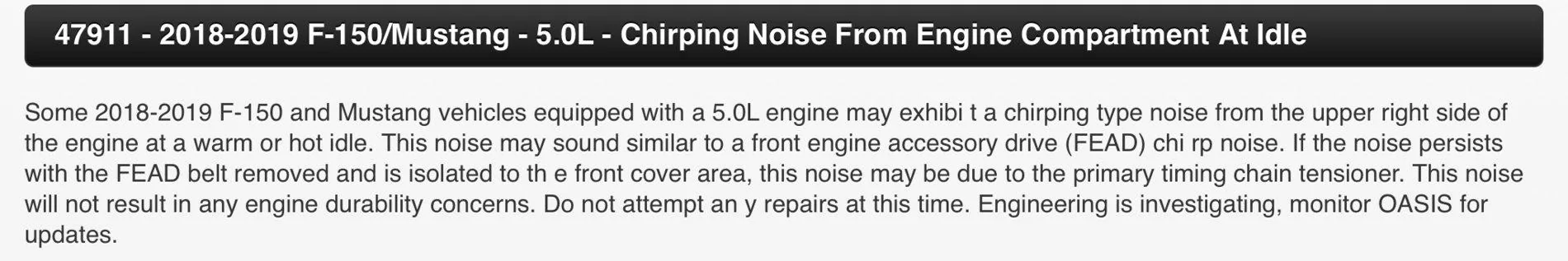

Here ya go, most likely it’s the issue per the SSM:
This below SSM was released for the 2018-19’s regarding 5.0 engine chirping.
Thanks! I haven't tried to find the sound at idle. I normally hear it when I'm driving. Not sure if that is different from what the SSM says.

Certainly isn't there at idle.
