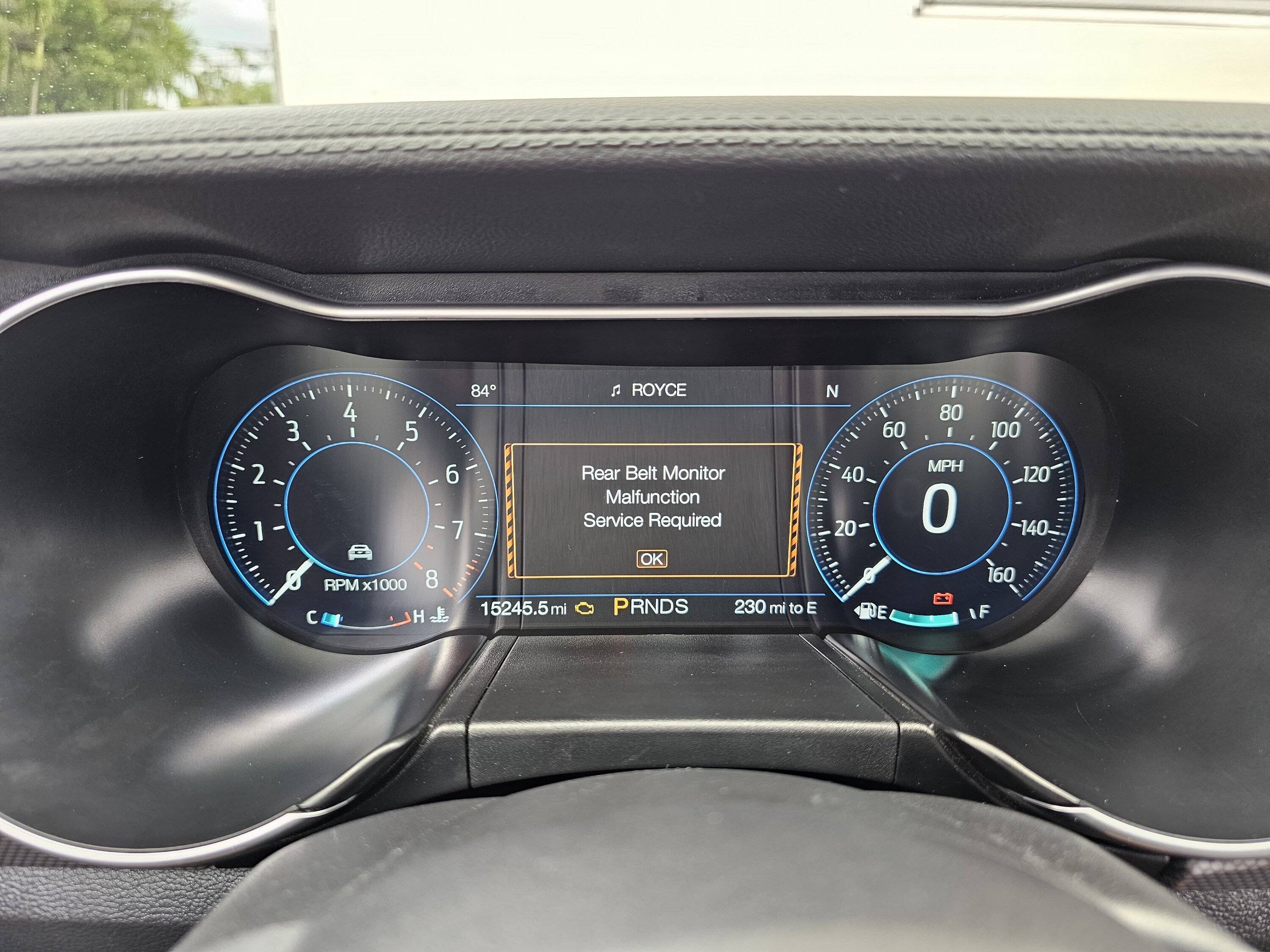

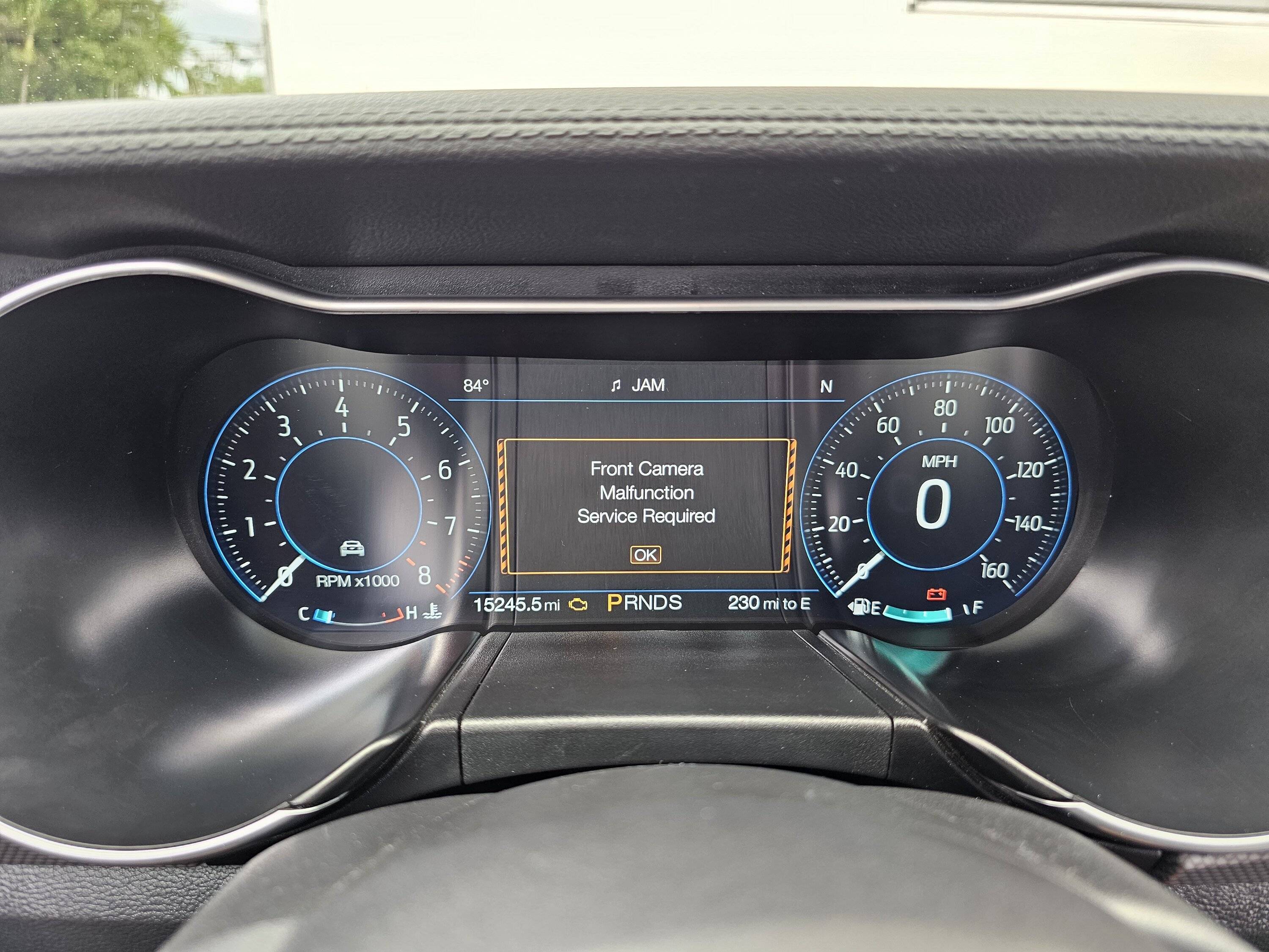

I just did a cluster swap but im getting this errors, any idea where in forscan I can find parameters to disable the front camera and rear belt monitor?
Update: I figure it out, save me $150.

Mustang GT 2018 Royal crimson
how did you fix it? im having the same issue

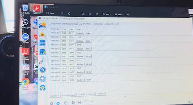

trying to hook up a buddies car and practicing to do mine., in the near future.
The spreadsheet says 720-10-01: XXXX - X * XX 4=Enable 0=Disable for Auto Rev matching.
The list only goes up to 720-07-02 on his car, in IPC (as-built)??
Did you mean 720-01-01: XXXX - X * XX 4=Enable 0=Disable for Auto Rev matching or Do the do 720-08-001 through 720-10-002 and up show up after the digital cluster is hooked up?
