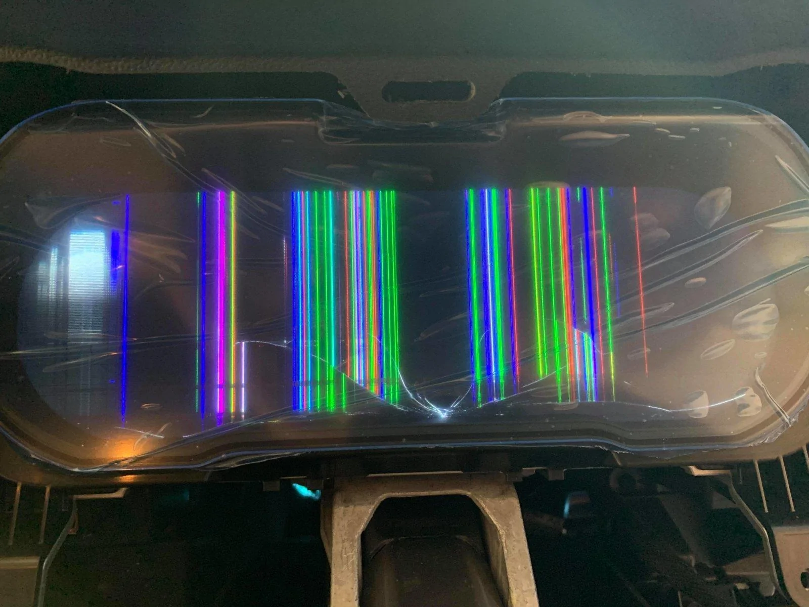

I must be the unluckiest guy here. Ws super excited, bought the dash for USD$895 from ebay, from the link above.
Came cracked.. outside, and the bezel and everything was fine no signs of drop damage.
That sucks man. I hope they replace it for you. Please keep us posted

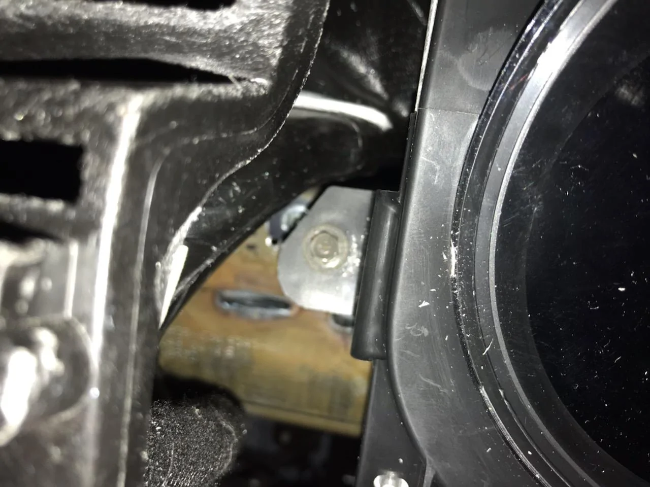

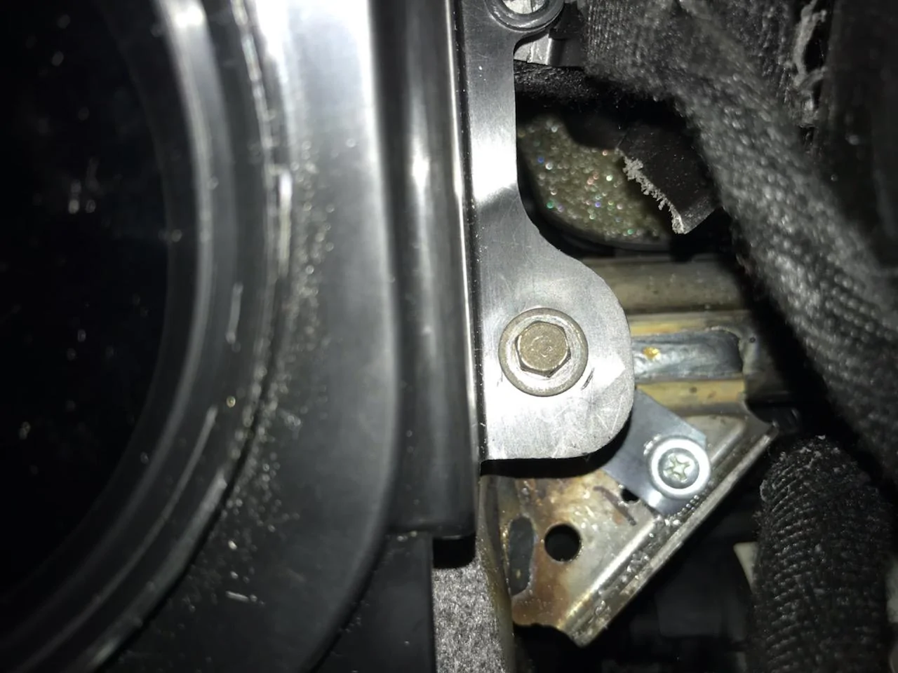

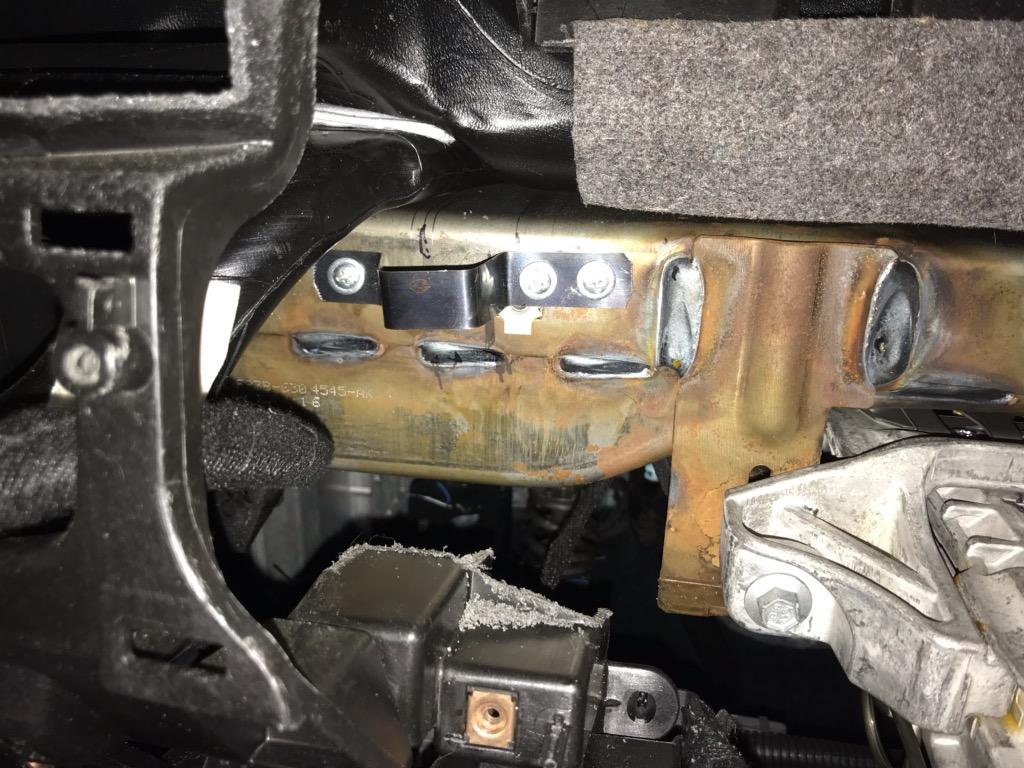

300mag.. Thanks for the help, I updated my forscan, I was using 2.3.19, and I updated to 2.3.20, I am not sure if that was the problem, but and that might have done the trick. I was able to downloaded all 16 of the different data sets...
I finally got to installing the dash, so far so good, I get 3 errors, 1) Blind Spot issue, 2) I forgot 3) 4x4 error... The IP is in, the SCCM is in, but I have not put the panels back on the dash yet.
Some things which I hope helps others when doing this. 1) The bottom part of the Steering column comes off super easy, I did not have to pull on it at all. There are 2 screws, a 7mm and a torx 25, once you remove those, I was able to spread the panel wide enough and it just unclipped really easy.

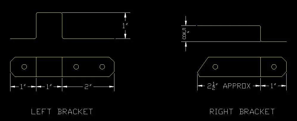

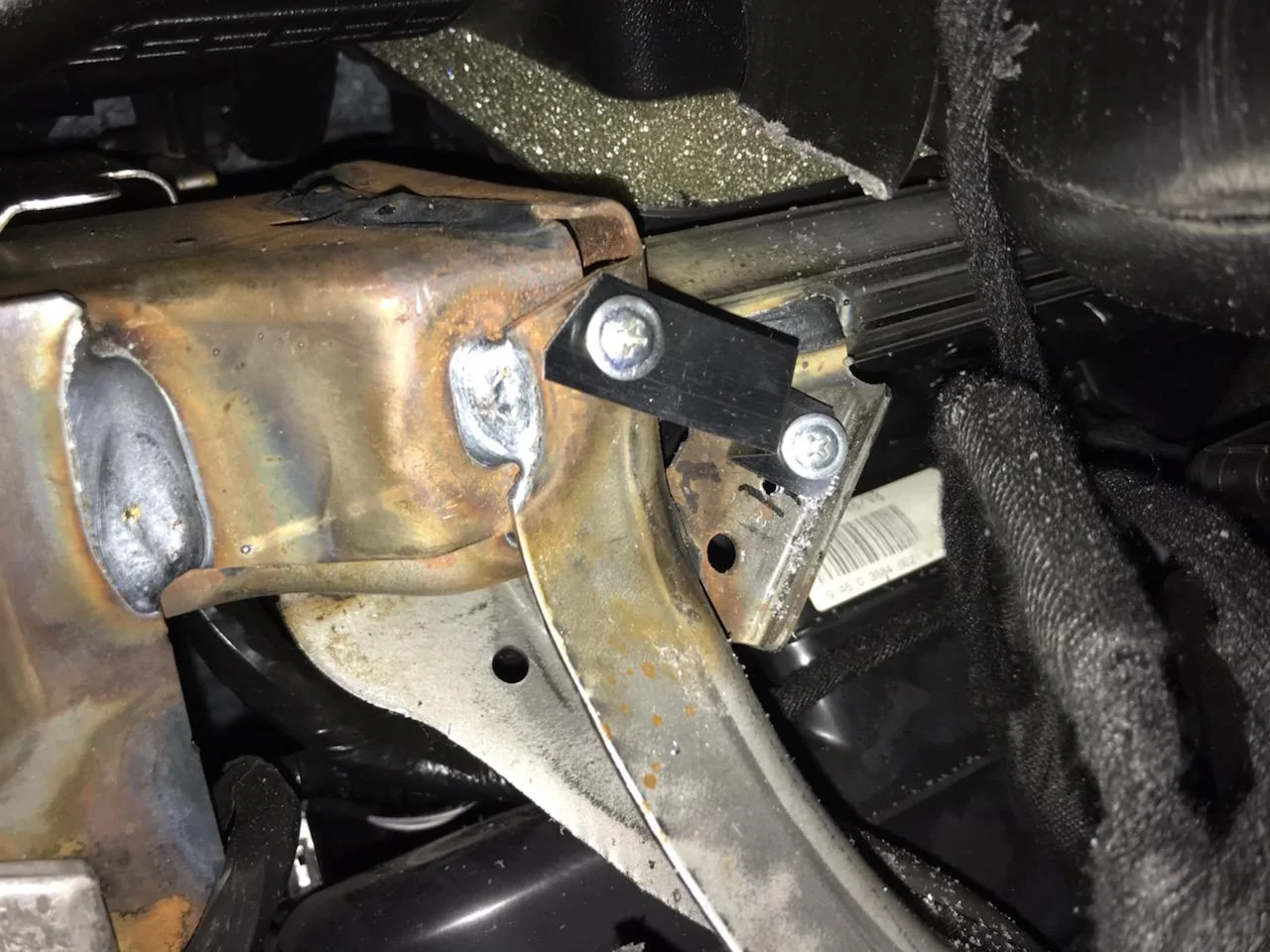

I was not pleased with how loose the IP was with just the 2 lower screws holding it in, so I made some brackets. I used steel banding, which I got from a shipment, and had not thrown away yet, and it worked like a charm... I cut the banding about 6" long, and then I bent it in my vise (pliers should work fine), measuring where I wanted each bend. I measured the distance between the IP brackets and the dash reinforcement structure. the LEFT side is about 1" away from the structure, and the Right side is about 5/8" from the structure. I have attached some pictures to help out. This made the IP VERY secure... Let me know if you have any questions..
Some notes:
1) I used 3/4" wide banding for the Brackets, I cut them about 6" long and then trimmed them down with tin-snips. I would have preferred some 1" or 1.5" wide sheet metal or banding as locating the holes for the IP would have been easier, but I used what I had... I like the banding because it is like a spring steel, and it is easy to work with... IF you use something really stiff, then you might break the IP mounting points... Furthermore the flexible nature of the banding lets it move and conform, without over stressing the IP...
2) I bench drilled the holes in the brackets prior to installing them, it made them a lot easier to install as they will want to walk on you when drilling.

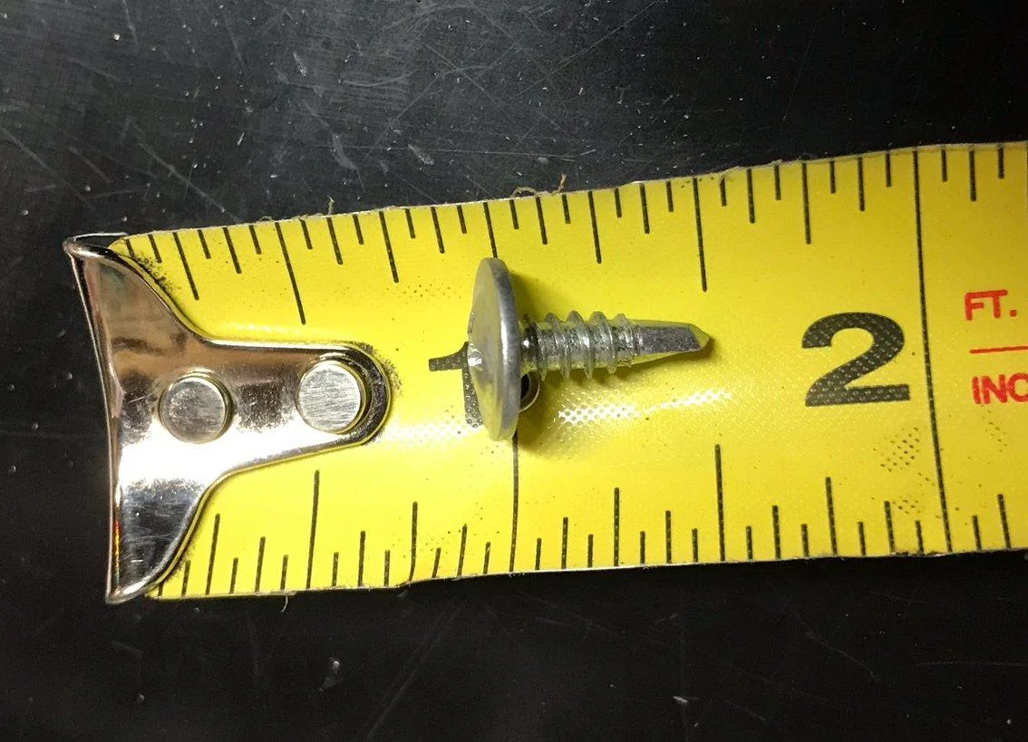

3) To mount the brackets to the structure, I used #8 x 1/2" Wafer Head Self-Drilling Screws, I have seen them at Menards... I would imagine they are available at Lowes or Home Depot. I like the larger head as it acts like a washer. https://www.menards.com/main/tools-...38-c-8935.htm?tid=7046285496405860129&ipos=77

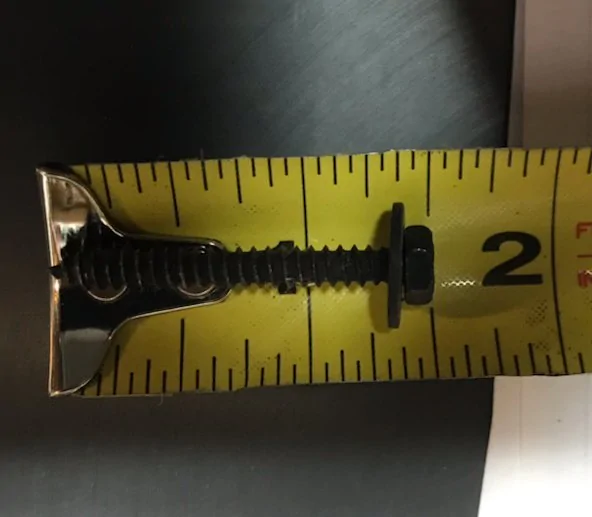

4) For the Long screws I got these from my bin of 3rd gen F-body parts, They are about 1.25" long, but you might be able to use 1", however anything shorter than 1" might not work with my bracket design. There is about 1/8" gap between my bracket and the IP mounting hole.
5) Where the IP attaches to the brackets I had to DRILL the brackets with the IP in the car, I had to be careful not to damage the side of the IP, but there was ample room to get the drill in there.
6) The LEFT bracket could be about 1/4" higher in my picture below, and about 3/8" further to the left, but it worked for me.
7) The RIGHT Bracket is also slightly low, but there are some holes in the dash structure which limited to where I could mount it. Again, a wider piece of sheet metal would have been advantageous, but I got it to work.
I hope this helps...

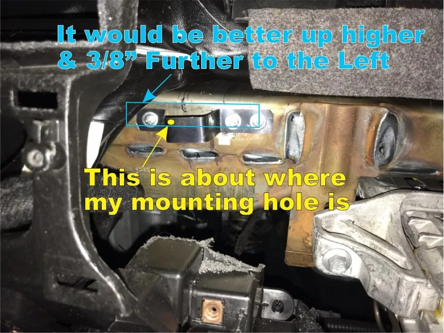

For the left side, I think this would have been a better location, but I made mine work...
Thanks
I hope so too. Apparently they don't have anymore in stock, and they've contacted USPS to see what they can do as it was insured. I don't really see how USPS did it because shipping box was fully intact and it was packed to perfection!
