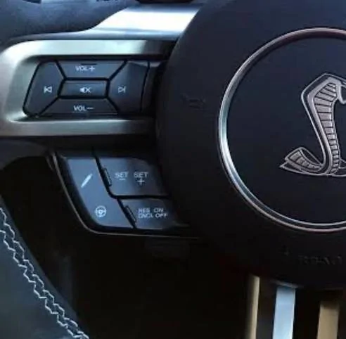

As the forums resident expert on everything electrical, do you have any theories on how a Mach 1 owner could unlock the independently adjustable suspension setting that the GT350/GT500 has? Happy to cash app you some coffee money for using up some brain power. I think its got to be something to do with installing the correct switch and updating the config to register the new switch.
We can try. I don't think it will work but its a simple configuration of the SCCM to try.
