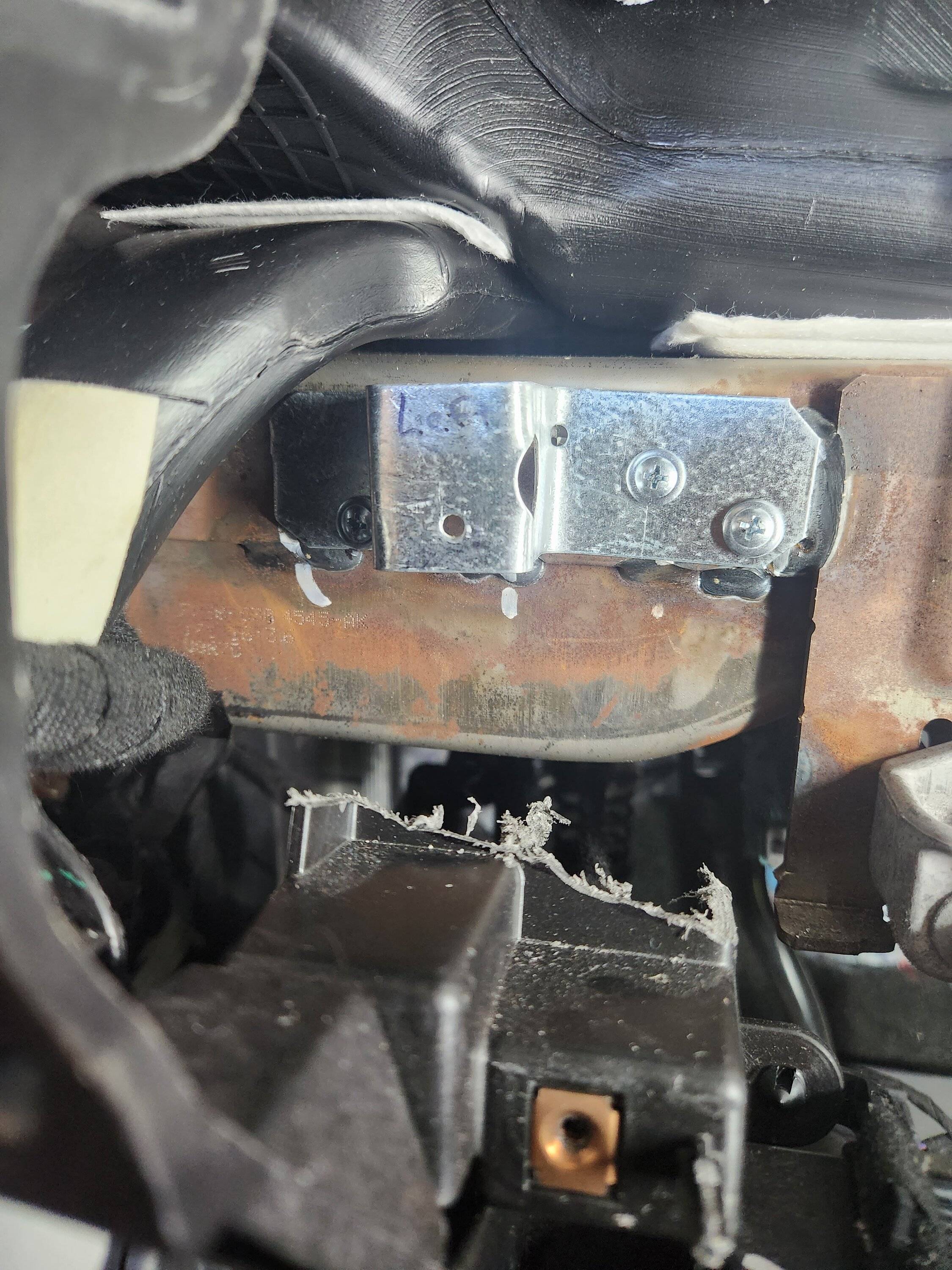

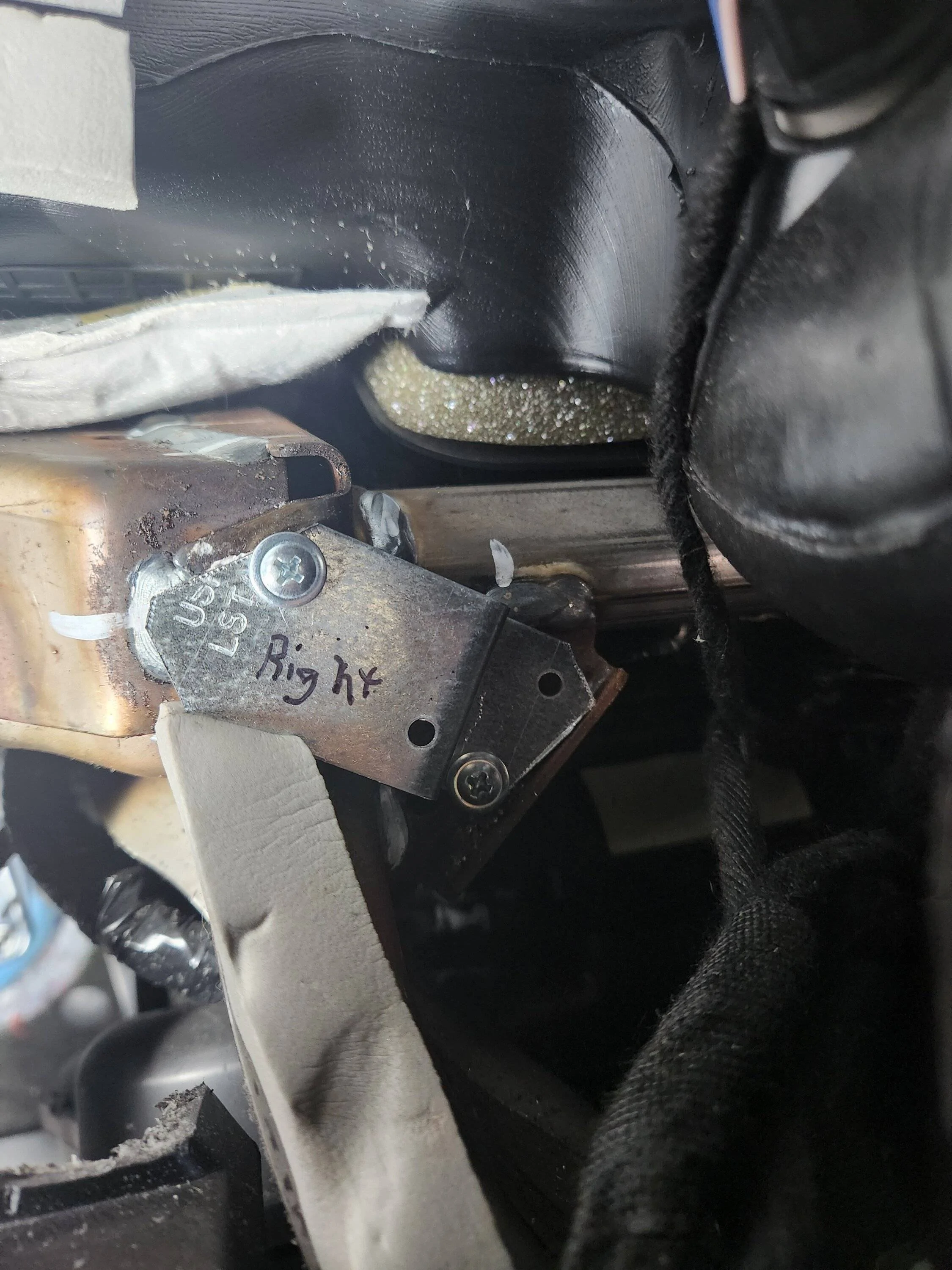

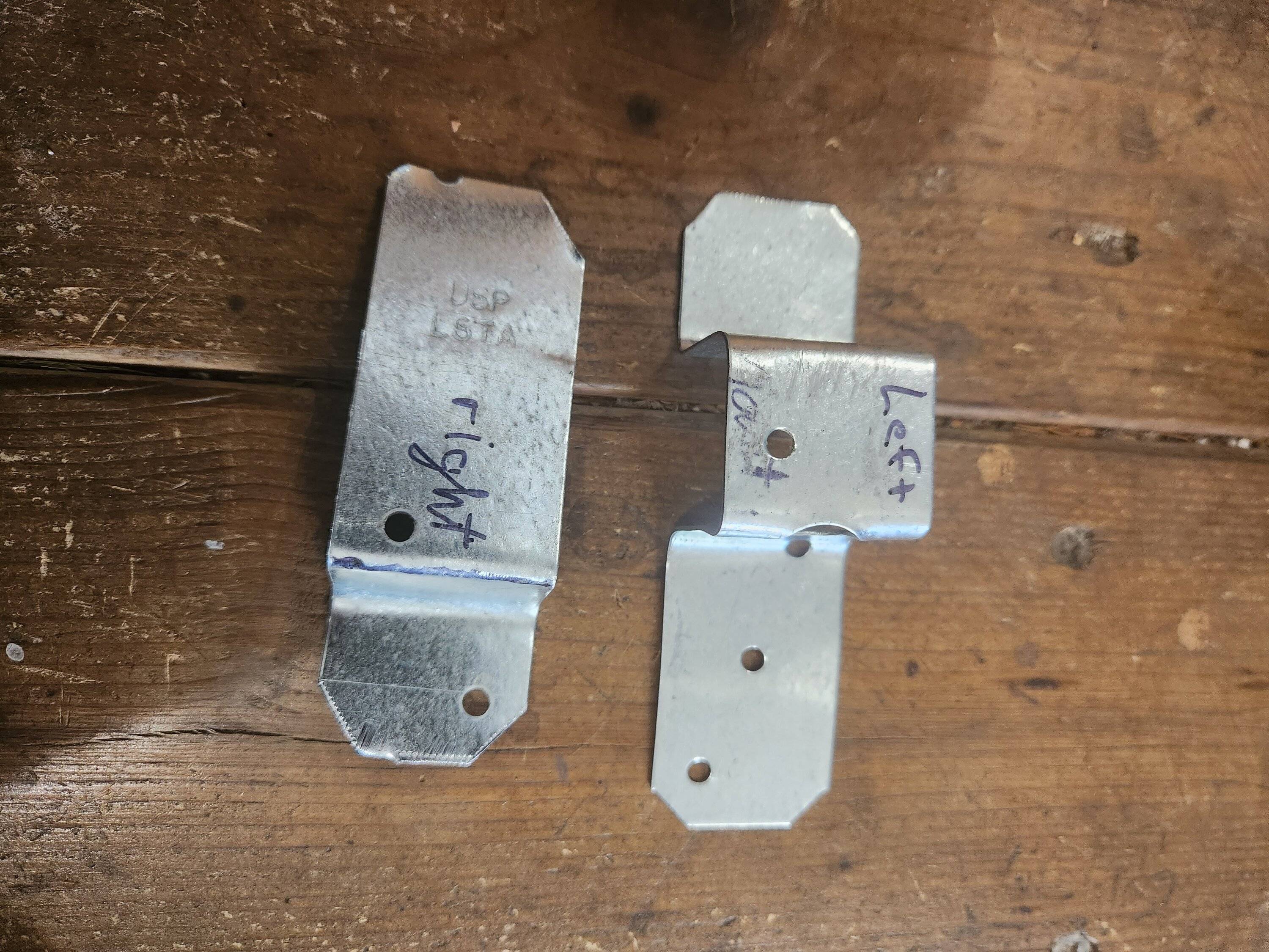

I'd like to report that thanks to @okfoz (and @Ferrcad for the link to the post), I've been able to build brackets for my 2017 GT and the digital dash is now 100% silent and secure.
Here is the parts list from Menards that I used:
For screwing the brackets to the frame: Grip Fast 1/2" Wafer Head Self-Drill Screw - 1 lb. Box at Menards®
For making the brackets. You only need 1 of these: MiTek® 1-1/4" Light-Duty Strap Tie at Menards®
For screwing the display to the bracket: Grip Fast® #10 Stainless Steel Hex Head Self-Drilling Screws at Menards®
Washers for the display to bracket screw: Grip Fast® Grade 2 Zinc Flat Washers at Menards®
I drilled pilot holes before doing the self-tapping screws. Other than that, just followed the directions and it worked great first try!
One note is I probably should have moved the right bracket just a bit higher as the mounting hole for the dash is very close to the top of the bracket, but it works, so I'm leaving it.

Glad to help. I never even ran without the brackets, when I realized that only plastic was going to support the Digital IP, I was quick to rectify that and make sure it was secure. Rattles and squeaks are my sworn enemy.

How do you get the screw holes in the exact right place for gauges to sit right? Is it just a matter of getting in the ball park, bolting to car and bending the metal to adjust so gauges fit perfect ?
Ferrcad
Sep 13, 2015
207
105
Western PA
Brian
2015 Mustang GT Convertible
The dimensions and bends of the brackets are spot on. They are somewhat of a feel to get them in the right location but the pictures show pretty accurate description for location. The two lower holes that are drilled for the bottom holes of the Speedo are some what subjective but make sure your level and centered in the opening. I actually mounted one side, leveled it up and put the bezel on temporarily without clips to check location. Once I felt good, drilled the other hole, padded a little on the top and then finished installing the bezel with clips.
The way i did it was to mount the brackets, then place the cluster where I wanted it. (Pushed all the way in and held) and then I marked the hole location thru the cluster tabs on the bracket with a sharpy and drilled a pilot hole to guide the self-tapping screw in.

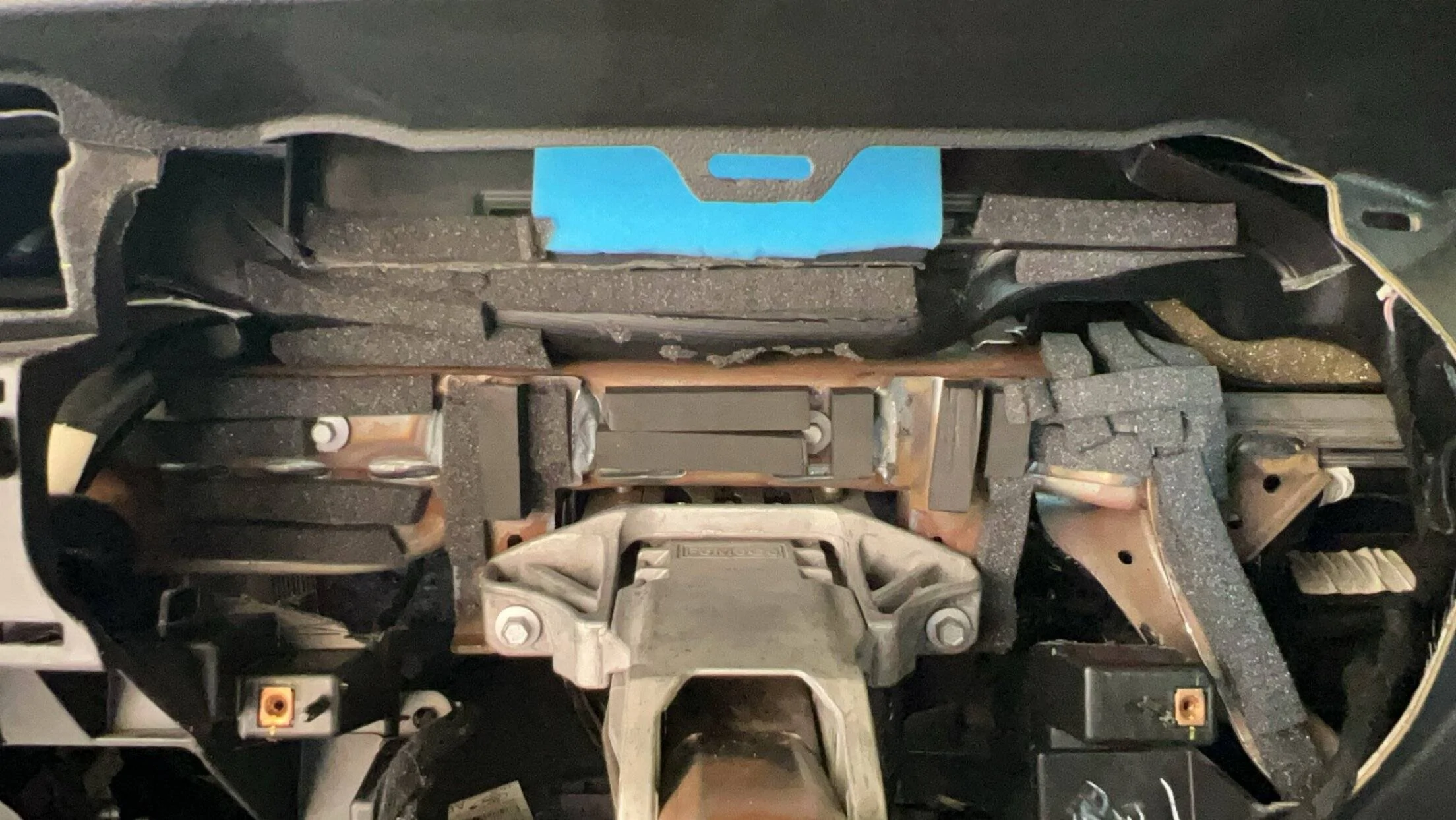

Did the swap earlier today as matter of fact I called in sick 😂😅 everything was straight forward thanks to this form and it’s active members. No issues whatsoever; did the programing using forscan and activated all the features.
Not sure if what I did is a good idea but I filled the back with foam strip I really don’t wanna take everything a part again if there was a rattle back there. I’m still worried about the digital cluster get hot since all that foam is covering the back of the cluster also one down side the cluster speaker is very low I guess one of the foam is covering the chime speaker. I’d take everything a part again if some one can tell me where is the chime speaker location on the cluster
