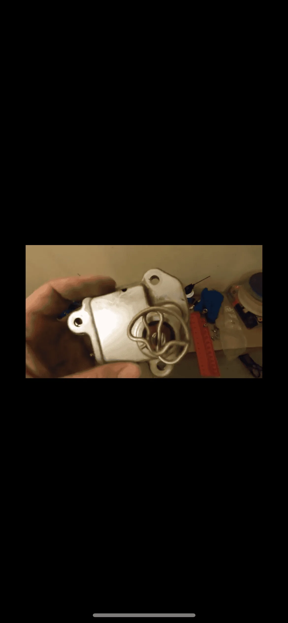

I have encountered another issue with my install. To verify everything was working properly I just took the actuators off the muffler and plugged them into the wiring on the car. Everything worked like it should so I shut the car off thinking everything was good. Finally had a chance to get the car to a muffler shop to have the mufflers installed so I thought I would go ahead and reinstall the actuators before going. I'm not sure what happened but it appears the spring did not go back to the same orientation after testing that it was when I removed it from the muffler so I am unable to reinstall the actuators on the mufflers. Any thoughts? Thanks in advance

So after unsuccessfully messing around with the spring pre mounted on the actuator, here's the only way I found I could do it :
1) Start by recording how your actuators and springs were when they were first removed - the GT's aren't handed :
2) Once everything has been stripped and cleaned and your ready for reassembly, make sure the actuator slides on and off it's mounting studs very easily. Re align the studs if needed. Use two M6 nuts and a deep socket to provide leverage without damaging the threads :
3) Ensure the valve is fully turned in the direction to line up with the actuator - in the case of the GT they were fully open :
4) Make sure the exhaust is level, and then carefully position the spring on the top of the valve :
5) Without disturbing the spring, carefully lower the actuator so it just rests on the spring :
6) Note I am working with the cut out of the actuator housing towards me, that's so I can peep under and see the actuator shaft and spring is 'almost' aligned. From 6 o clock :
And from four o clock :
7) If all looks OK, push the actuator down and wiggle / twist it a little it on its studs whilst maintaining downwards pressure. If you hear a fairly loud snap, then the spring has most likely seated in the actuator shaft.
8) Don't trust it the first time, open it back up and check its correct. Do it a few times to get a feel what it's like when it correctly seats.
The first indication that it has seated correctly, will be that the actuator goes tight on its studs as it's now fighting the spring a little - there will be some resistance to lift it of it's studs.
The second indication is that the spring is fully located in the actuator shaft when you lift it off :
9) Once you are confident you can do it right every time, bolt it down to stay (I know I have missed the little bracket from the inboard nut, it's paint is hardening) :
10) As a final check, fist your exhaust deep enough to twiddle the flap. In the case of the GT it's fully open, rock solid one way (it's up against it's stops), but it can be moved with firm spring resistance the other way - instantly returning to it's home position when you remove pressure on the butterfly.
