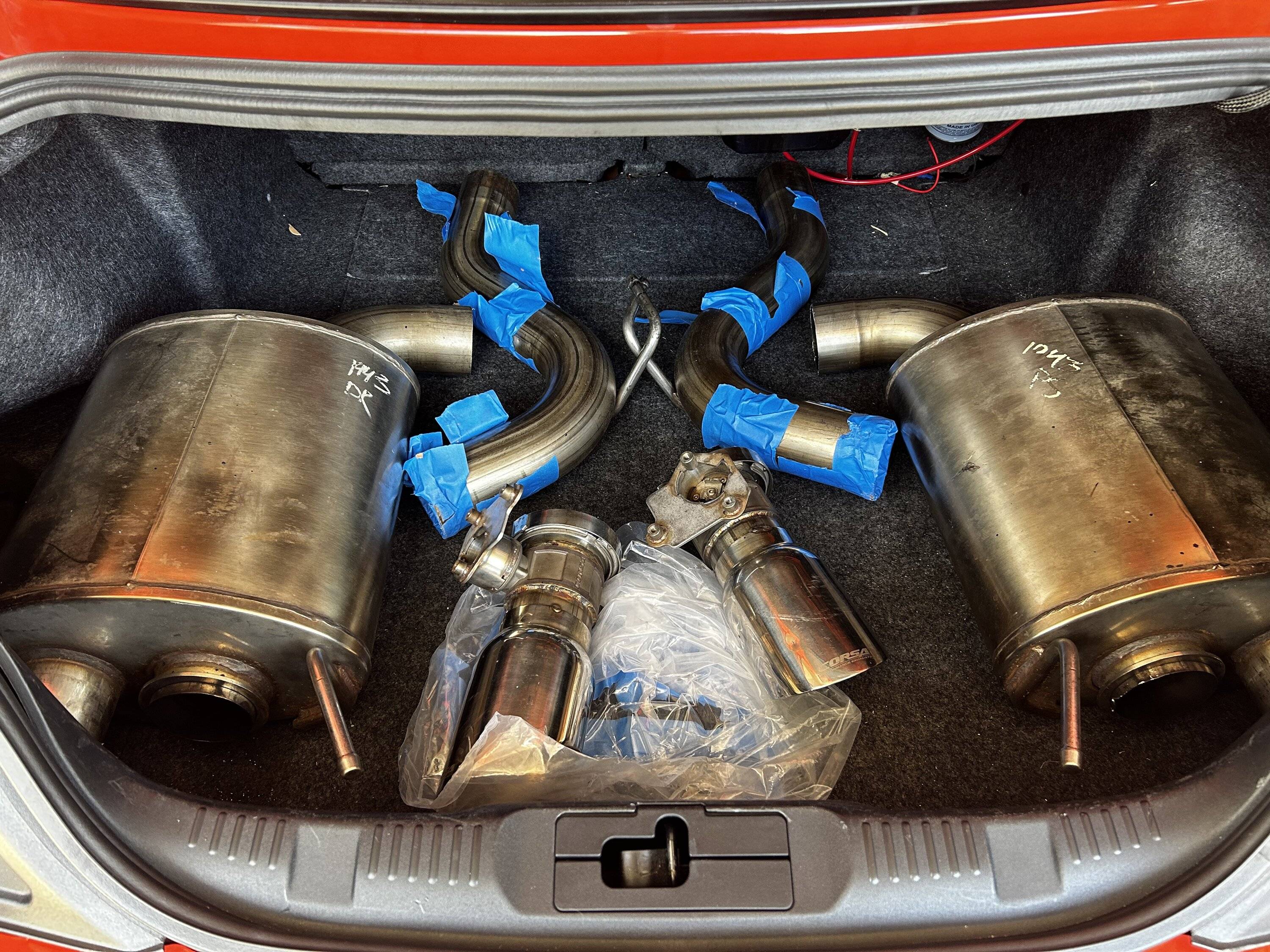

Thought I would give an update on my install so if anyone else runs into the same issue they will have somewhere to look. I was able to find pins that allowed me to add pins to connector C264 instead of using wire taps and that solved my problem. I was able to turn ignition on with no errors and change modes with the cluster. Was also able to verify the actuators work. I guess since it is such a small gauge wire the t-taps were not able to crimp tight enough to get a good connection.

I have encountered another issue with my install. To verify everything was working properly I just took the actuators off the muffler and plugged them into the wiring on the car. Everything worked like it should so I shut the car off thinking everything was good. Finally had a chance to get the car to a muffler shop to have the mufflers installed so I thought I would go ahead and reinstall the actuators before going. I'm not sure what happened but it appears the spring did not go back to the same orientation after testing that it was when I removed it from the muffler so I am unable to reinstall the actuators on the mufflers. Any thoughts? Thanks in advance
