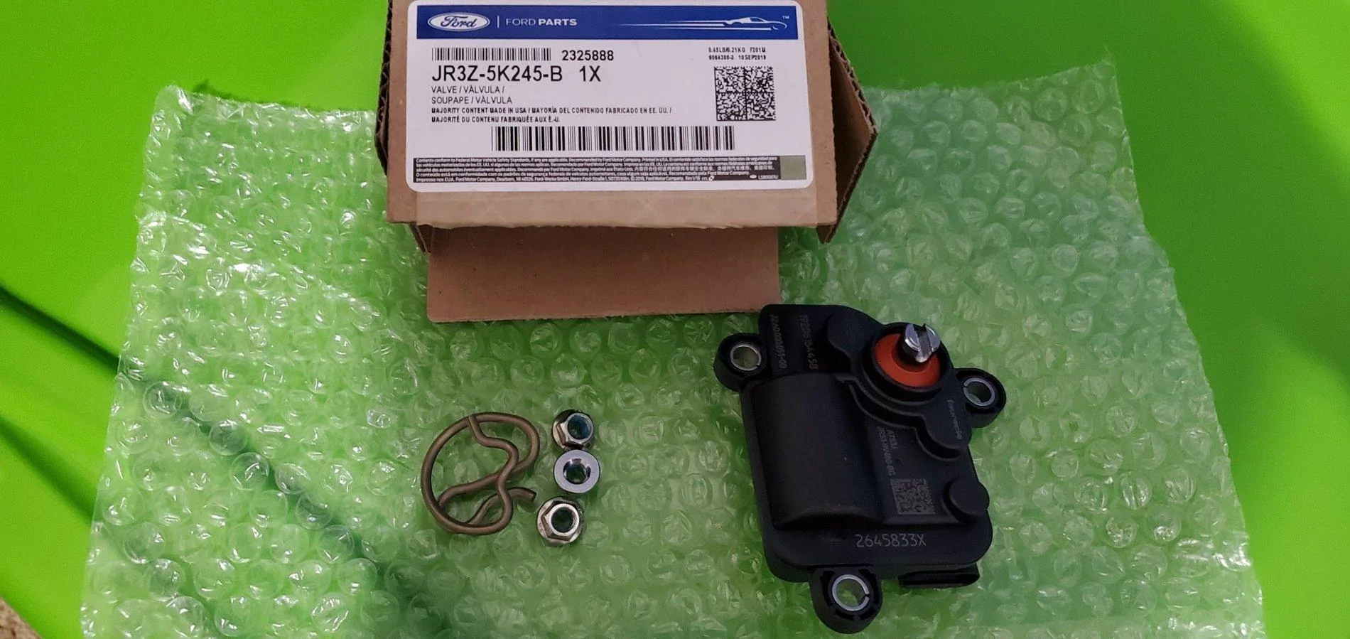

Has anyone actually ordered JR3Z-5K245-B, the Valve Repair Kit? Can anyone actually tell me what's in it and if it comes with both actuator motors?

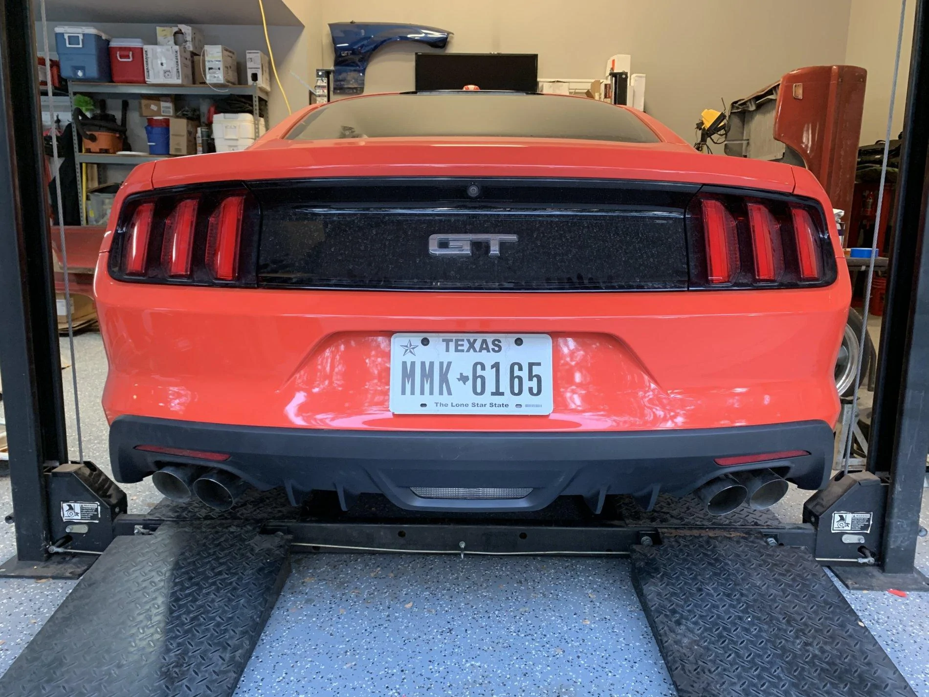

Okay, so here’s an update:
Mufflers and Roush rear valance installed. They fit perfectly together.
***GT350 ACTUATORS DO NOT FIT THE 18-19 GT MUFFLERS. ***
Next order of business is to source some actuators. Please excuse the incredibly dirty car and my friend who did the start and rev for me.

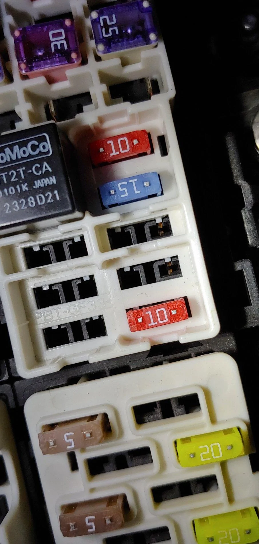

Hey guys i am new to the forum and making my first post. First let me tell you that i have a 2019 GT premium 401a, without digital dash, without magneride.(I DO HAVE THE HARNESS AT THE BACK OF THE CAR) I have been lerking through all of the active exhaust threads for some time now. I recently acquired all of the OEM parts to attempt this swap.
Parts i currently possess:
(All from Tasca Parts)
Exhaust actuator motor (2) JR3Z-5K245-B ($248.85 each) Side note I originally ordered actuator motors FR3Z-FK245-A ($93.24 each) (These are for GT350 only and have a smaller 3 pin connector which will not work OEM harness)
Wire jumper assembly (2) - JR3Z-14A411-H ($32.91 each)
Y harness - JR3Z-14A411-J ($40.61 each)
My intentions have been to obtain these parts and test functionality before purchasing a Borla Active cat-back system. I have turned on the active exhaust menu in the dash with FORScan.
Last night i finally had some time to tinker with this a bit so i plugged the harness and actuators into the OEM harness at the back of the vehicle and changed modes in the dash only to find that the actuators did not function. I am not getting any warnings in the dash just zero actuator function.
I decided to read back though the thread only to realize i had never checked the fuse box for the fuse and relay. And to my surprise.. neither is installed and even worse it does not appear there are any contacts in their
place except for 1 where the 15A fuse goes in space 42. At this point I have to assume there is no hope for a truly OEM install. Any help would be appreciated.
