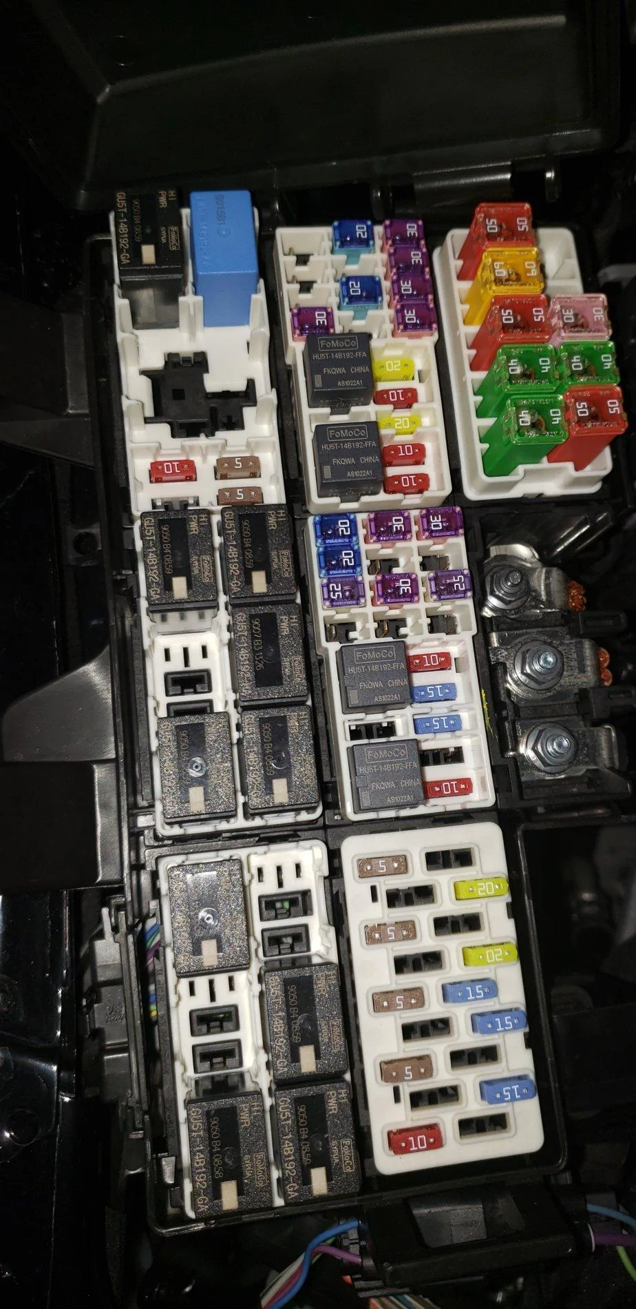

If you have the wiring in your fuse box for active exhaust install the 15a fuse and relay then order all 3 wiring harnesses and valves listed in my previous note a page or 2 back. It will cost around $700. I would recommend installing fuse and relay and use forscan to activate the exhaust menu in the dash and test for 12v power at rear harness connection before buying hard parts. My car was not wired under the hood for fuse power so I abandoned the idea. I decided on borla S-Type passive and I'm very happy with results.

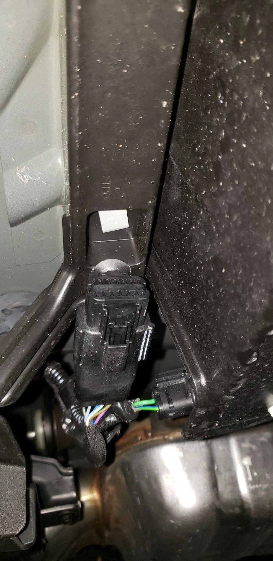

2019 with 401a package, I have the plug, but no connectors in the 59 relay slot in the fuse.
Have we found an option to power the actuators to use the dash selection?

Just got my 2019 - 401A, Magnaride, Safe and Smart, PP1, and 10 Speed and I have the connector and I already have the fuse and relay installed from the factory in the fuse panel already. I will definitely be attempting to get this working using a set of borla or corsa active cat back. Now to spend some more time reading.

Does anyone know on an AE equipped car if you removed the actuator from the muffler and had someone change modes while looking at where it attaches to the plate if you could see it moving, not the plate the actuator attachment point? If not does anyone know the voltages that should be coming out of what pins on the 4 point actuator connector? I turned it on and got my harnesses. I have some power between pins 1 and 3 or 2 and 4 depending on which side of the connector I am coming from I cant see the numbers. I just wanted to make sure all is able to work before I get the exhaust. Thanks
