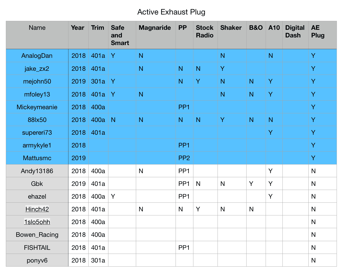

I scoured through this thread to see if there was any rhyme or reason to the car configuration. There are some missing data points but the short answer is that so far I don't see any trend.
If you see your name here and want to add some more information just let me know, or corrections. If you don't see your name here and would like to add it to the list just post all of the below variables.
Haven't looked at this in a while. Mine is 401a, magride, security package etc. Literally every except factory active and Recaros
