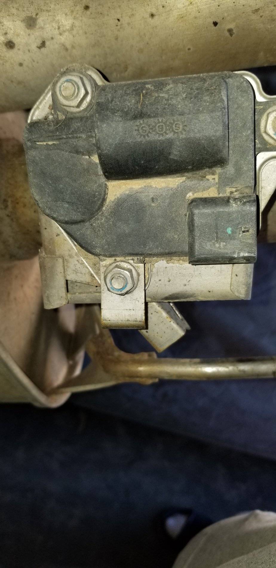

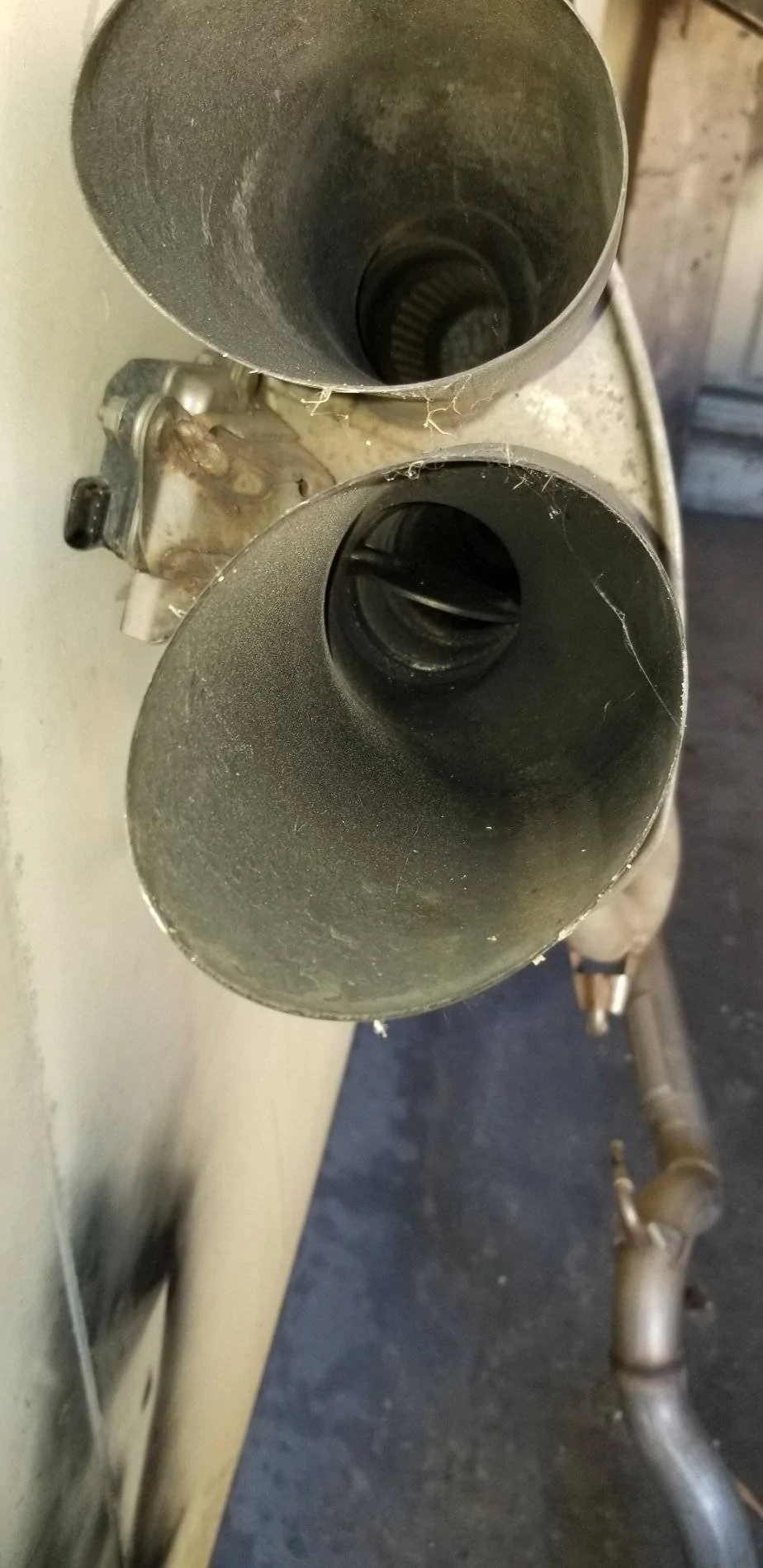

Here pic of the exhaust, valves, actuators. The actuators were connected to a wire harness before I removed the exhaust system.
What are you guys looking at far as relays etc...?

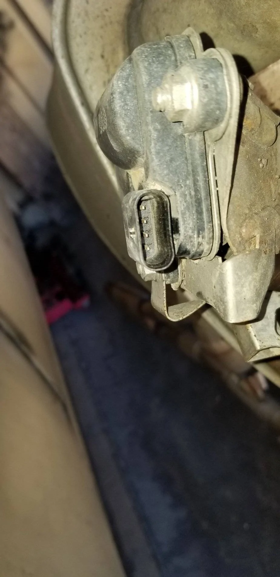

2019 GT PP1 6Speed with no other options.

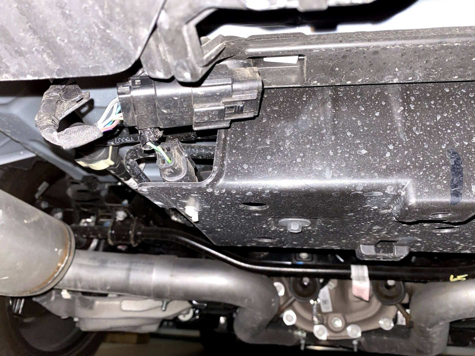

I think this is the correct plug?
Also, for us 2019's that need the PCM also programmed. My first thought was reaching out to my Tuner, PBD, and see if they can turn it on. I watched a video a while back from Alejandro Flores, Lund Tuner, where he mentioned AA tables being listed in the PCM.
Yes this is the correct plug
