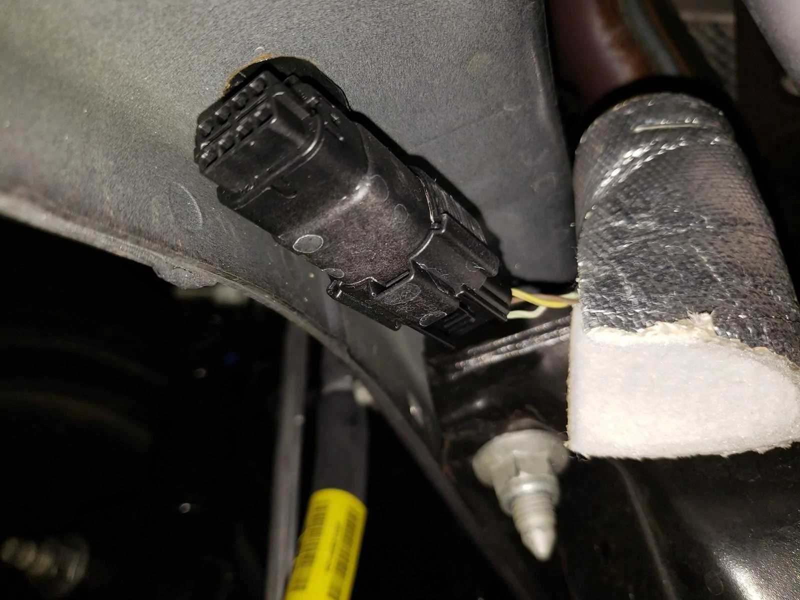

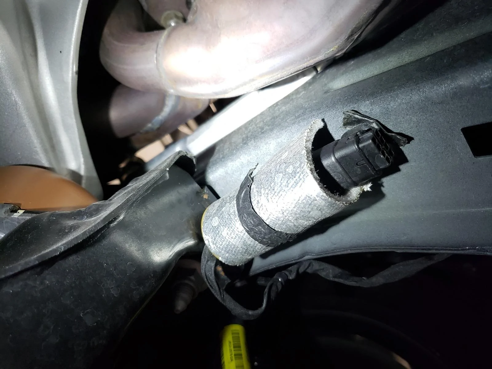

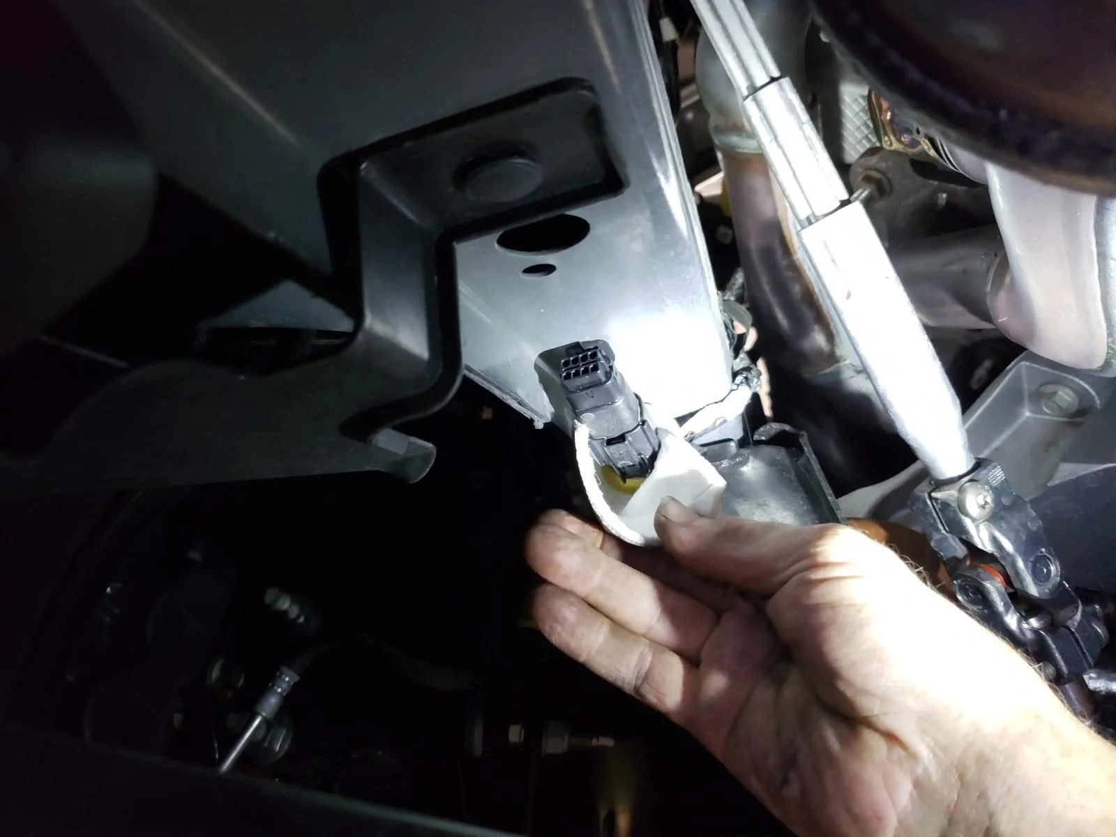

Guys I found 2 more unused plugs on my 2018 GT more toward the front of the car on both sides on the inside of the frame rails near the headers. The mechanic thought they may be wiring for the stock active exhaust. Anyone know what these unused plugs are for? 2018 GT 400a PP1 without magnaride or active exhaust.
What do you guys think?

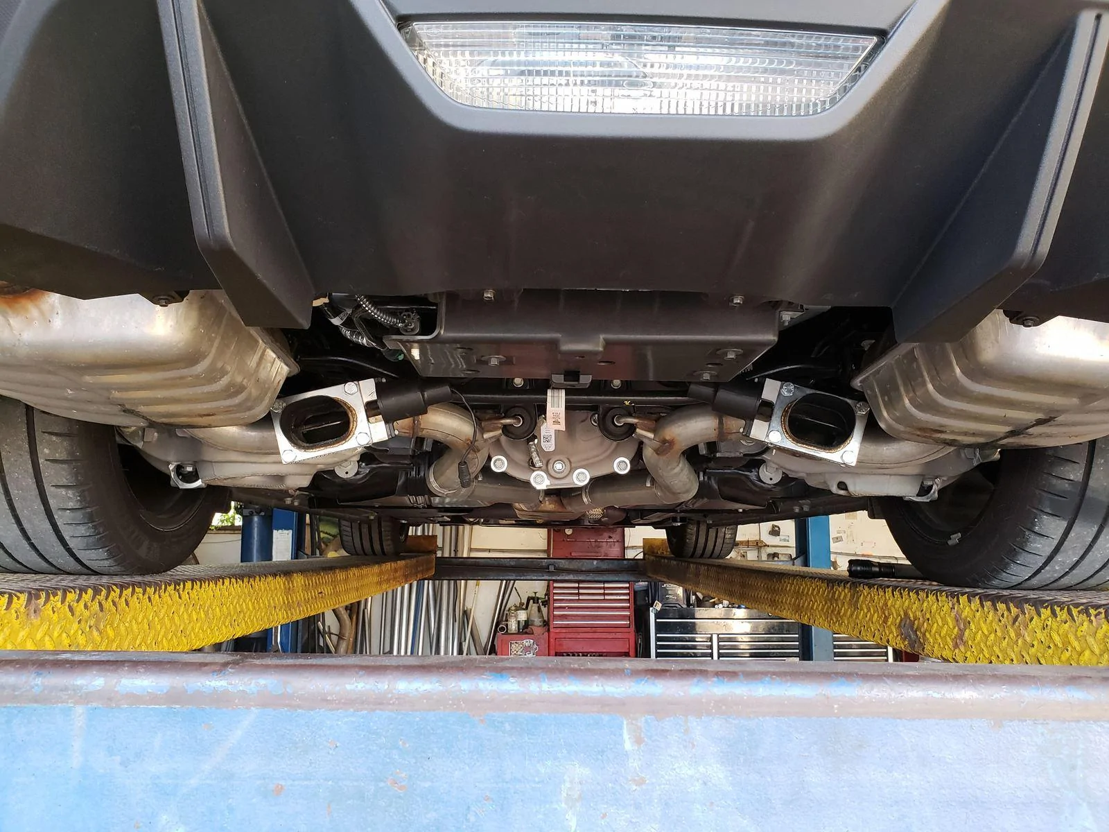

On a side note I made my own active exhaust :
sounds great imo
sounds great imo
Nah, the active exhaust factory wiring runs inside. I'd bet those are for Magride maybe?
