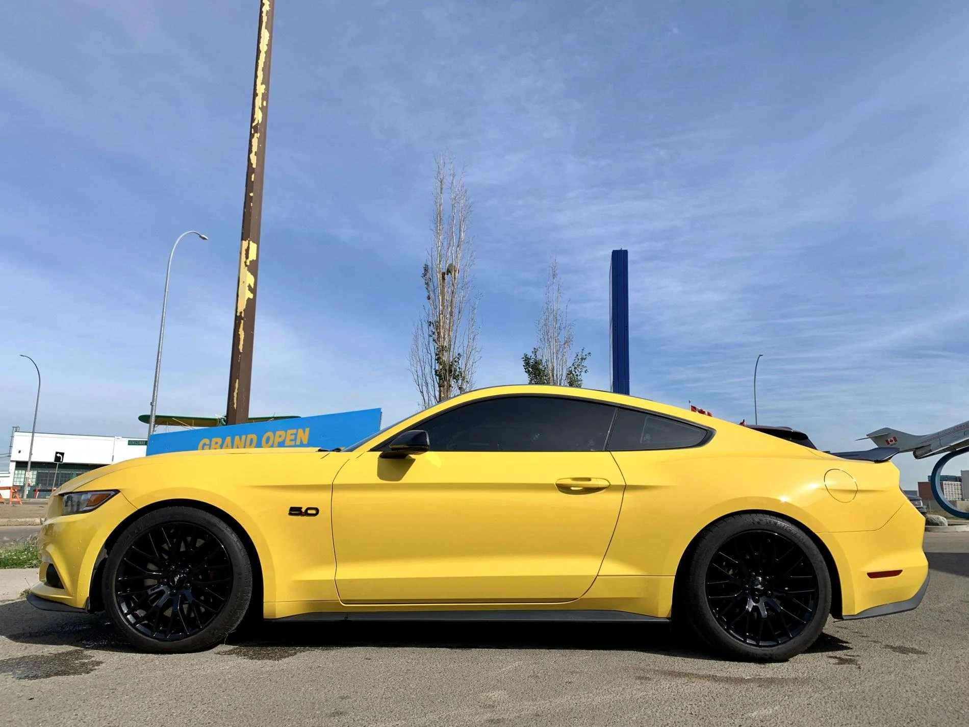

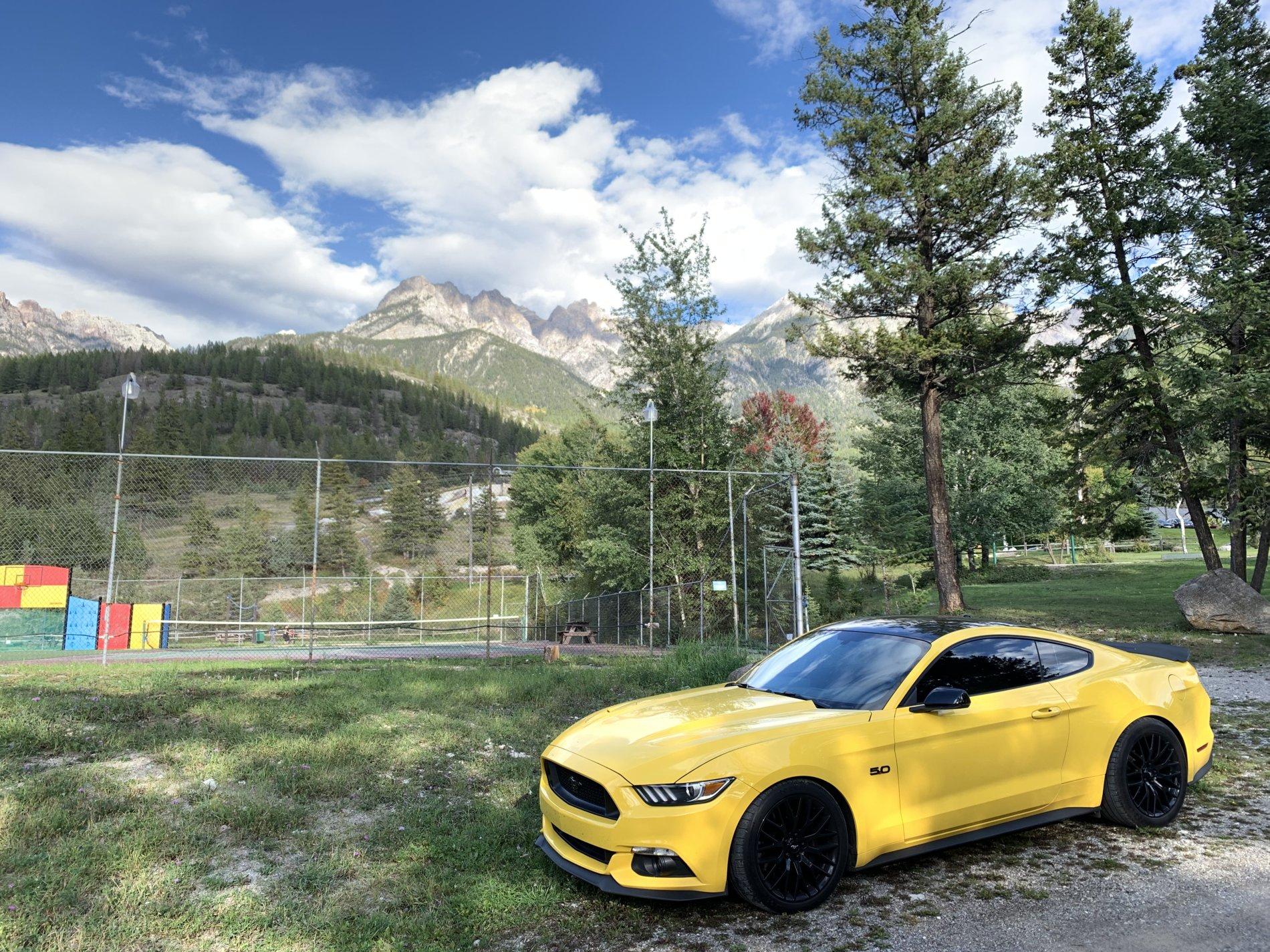

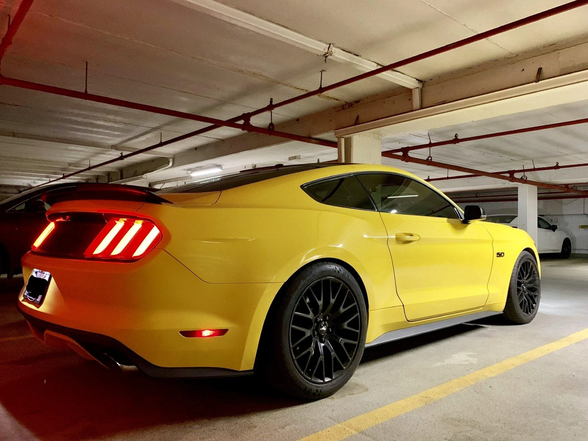

I recently installed the BMR performance springs (with the minimum drop front springs - 7/8” drop) paired with Koni’s newer Special Active dampers (red). The performance springs have nearly the same springs rates as factory PP springs (170f/740r). The drop is nice with some good clearance at the front. It’s a 2 finger gap up front and 1 finger gap in the rear. Ride is compliant and more planted; bumps are absorbed a little bit better than stock. Overall I’m fairly happy with the ride alongside a reasonable drop that lets me get in and out of my underground parking. I have 1” spacers all around as well.
