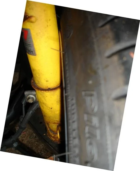

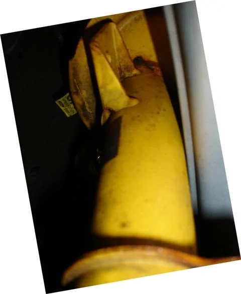

That's way too much. The wheels themselves probably don't need any more than a couple of mm, but a more definite answer than that is going to at least involve tire size vs wheel width, with the more stretched tire fitments (narrower section widths) being tolerant of smaller clearances than measuring-width or min-recommended width fitments.
Oh, hell, why not, a strut suspension is a strut suspension, right? No rubbing even out past 1.3g. About 1.1mm. 285/35's on 11" wide rims.

Thanks for the number, but is that wheel to strut or tire to strut?
Norm.
Obviously will depend on the tire, but that's wheel to strut. Tire could be a hair less depending on what size & brand/type.
