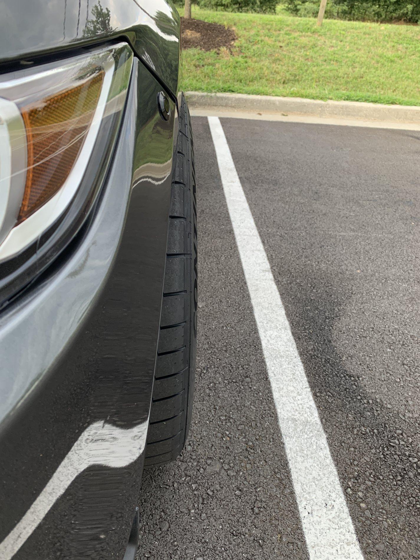

I have APEX SM-10 19x11 et +26 up front. 295/35s Continental ECS
The one in the day was before alignment. The other one was after at -1.2*. Doesn't look bad at all
And for any track use you'll want another degree or more to prevent excess outside sidewall deflection and uneven wear. -2 deg of camber with zero or near zero toe will not see any odd wear patterns.

Yup I plan on adding a little bit more for street driving. I accidentally forgot to change the camber on the BMR suggested spec sheet when I left the car with the shop. Not trying to pay for another alignment just for my error. :headbang:

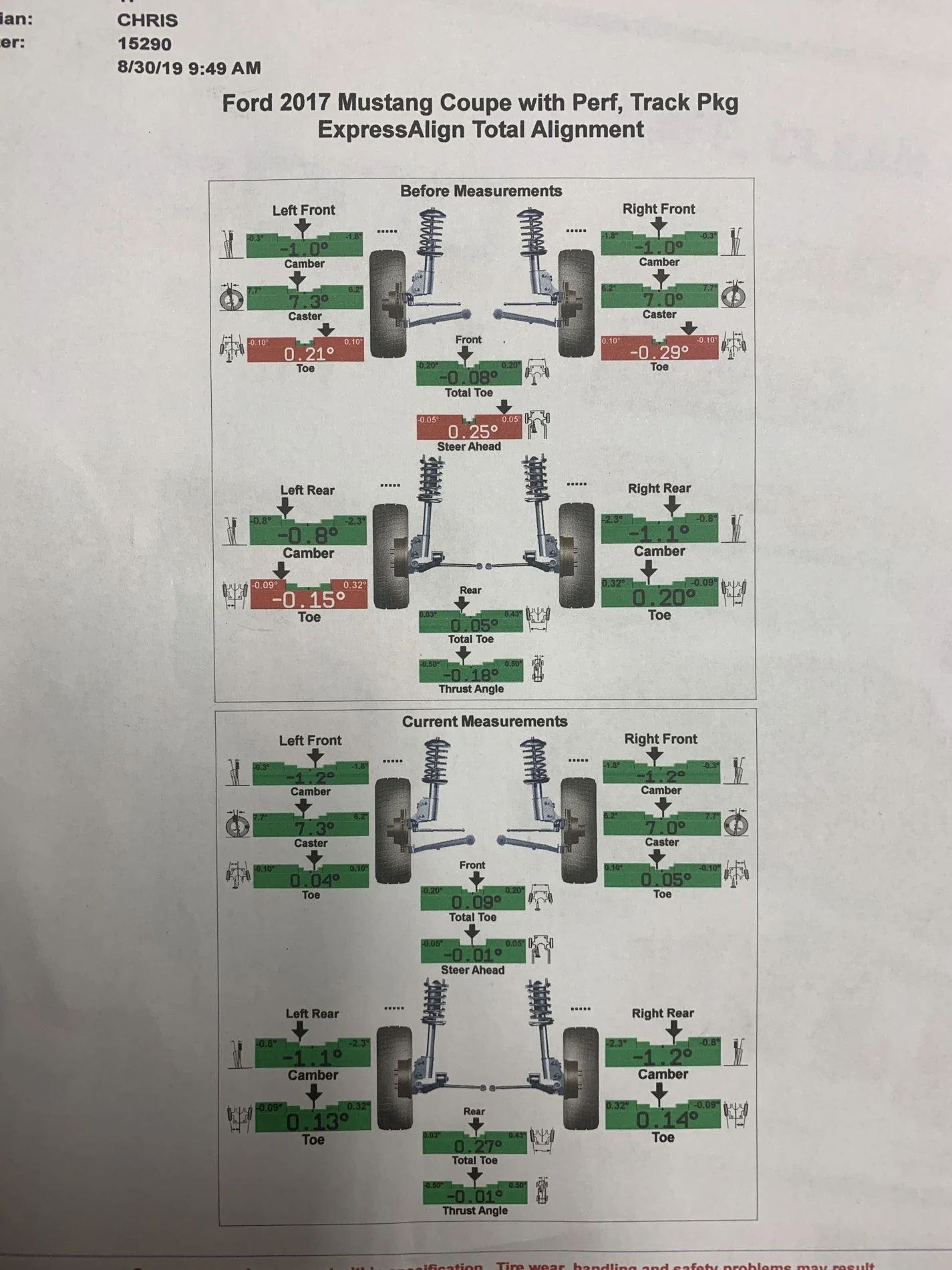

So, when I take it to a shop for a alignment, will I need to specify the camber needed as being -1.2-2 degrees?

I just printed out the BMR suggested alignment (see attached)
But again I forgot to add more camber on the sheet after I printed it out. But like @BmacIL said of you plan on tracking the car you will need more camber.

A qualified shop usually prints it out. See mine attached
