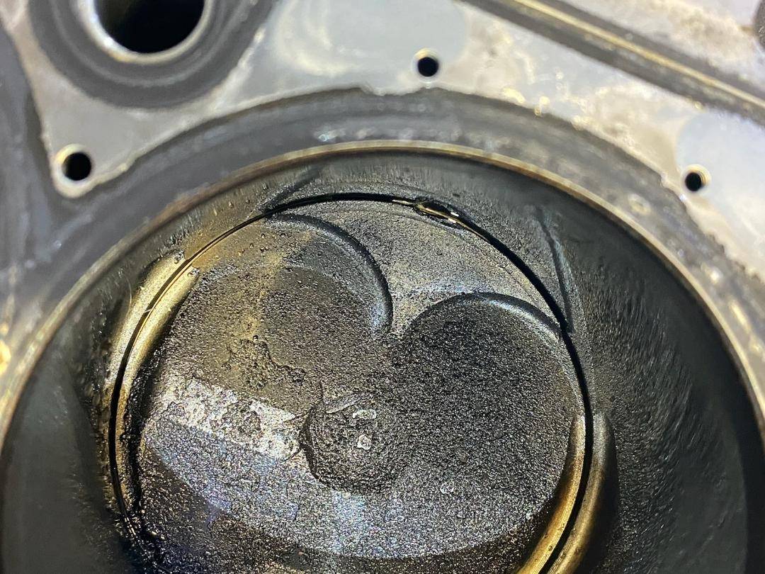

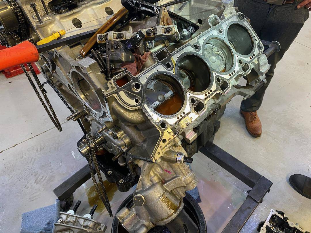

So here was the situation with the engine from the first post.
From the words of the tech: "the edge of the piston is gone, the ring folded over and it busted one of the exhaust valves". "cylinder wall is scored all cross hatching is gone".

Tom
Sam, Jeff,
This thread is to report an engine swap out that I came across. Lets please Keep to the subject matter.
Thanks for follow up!
Do you know build date for blown motor by any chance?
Any look at the head? This is a rare image of the engine pulled down to that level. Interesting. We've seen a lot of different failure types at this point - many latch on to one or the other and say it applies to all engines but a ring land isn't one of the more common ones, I don't think? Check out #7, looks suspiciously void of carbon.
Ill ask

@honeybadger to look close at those guides and other components.

Ho boy! Wild ride.
anyways, looks like 8 definitely had a ringland/ring issue that led to tons of oil burn and eventual failure. Not sure how that affect the valve, tho.
I think the issue with 7 is lighting. 5/6 look fairly clean too.
boy, not sure I’d want that tech working on my car. So great to see pools of coolant just chilling in the cylinders.

Ho boy! Wild ride.
That block is going back to Ford. Longblock replacement under warranty.
