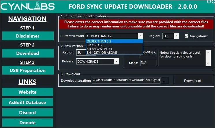

    It's true that they're no longer hosted on that site. However, use the download tool they have listed there, whatever the most recent version of the tool is on the site. Right now, it's 2.0. It'll download your desired version of Sync from the official Ford links and once the download has completed it will automatically prepare the USB Drive ready for you to insert into your car. It pretty much makes this fool proof, preventing user error from wrongly formatted or partitioned USB drives.

    Have you noticed any USB problems that some have complained about with version 20021? Lastly, I downloaded version 3.4 19274 tonight and the whole thing went on one 32g USB stick. Thought you needed two sticks for nav cars? I did configure with Nav.
