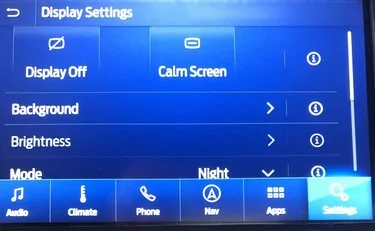

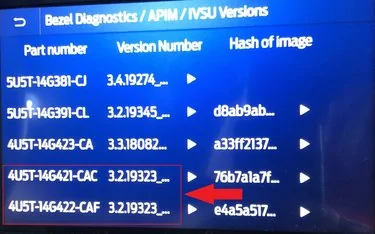

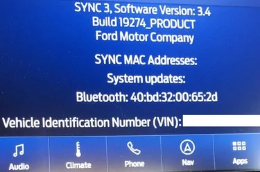

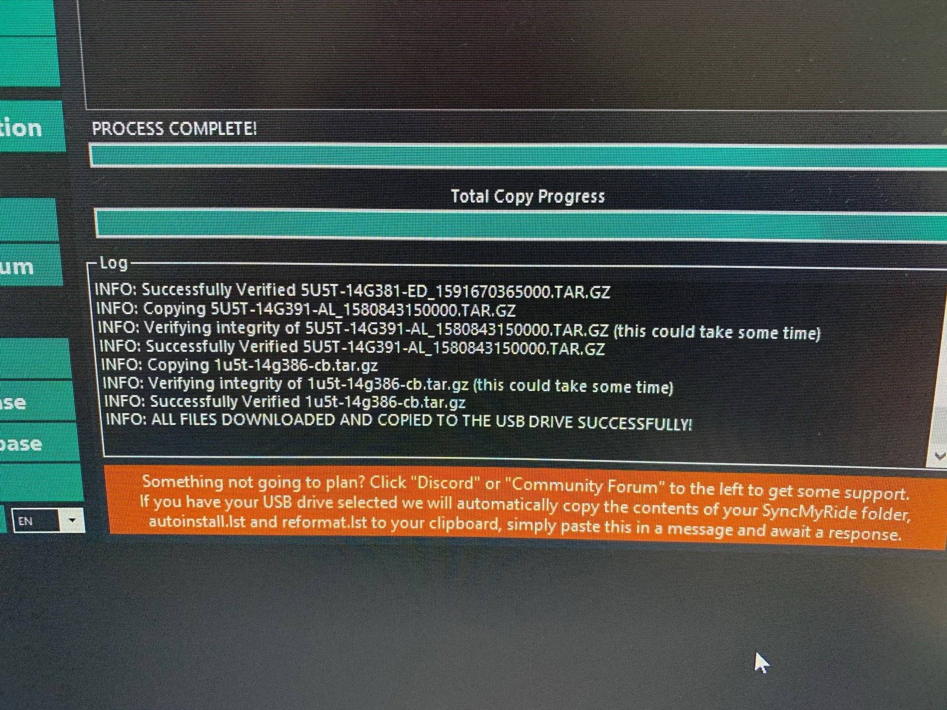

Well, After spending some time on Cyanlabs community forum I decided to do go that route...
I settle on version 19274 because it seem to be stable. So far I have no issues. UBS works like it did on 3.3. All Steering wheel functions work as intended. So far I'm happy with it except night mode is blue instead of black :frown:

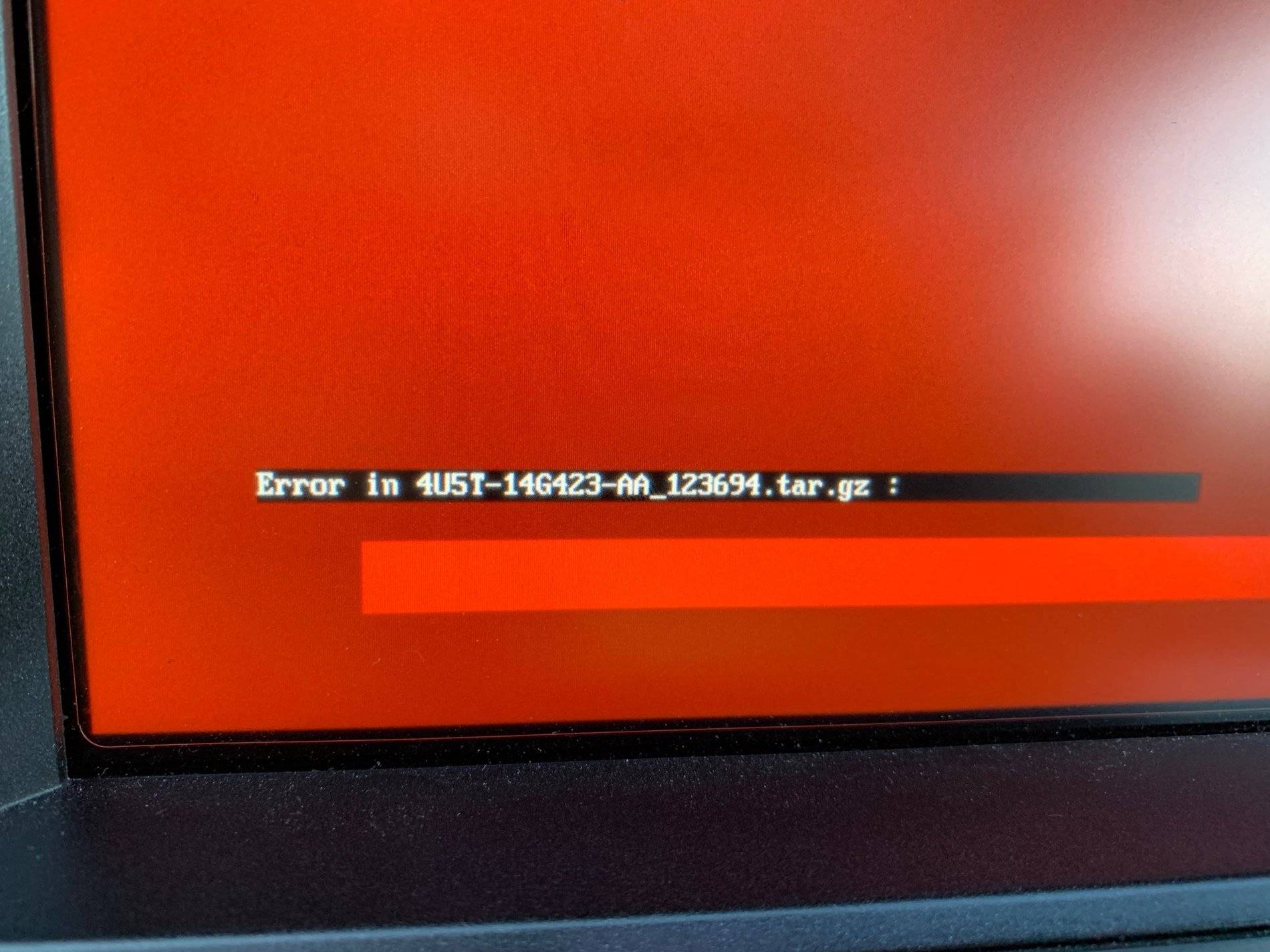

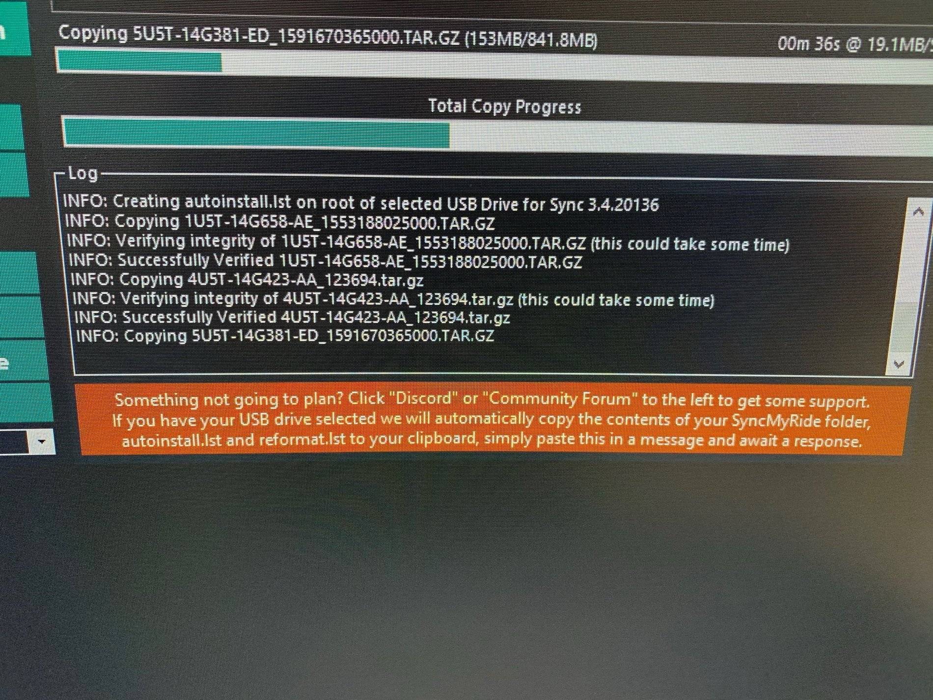

Downloaded Cyanlabs, installed it on a stick (even tried a second one, different brand 16Gb) but got stuck..... anyone ?
Delete all of the downloaded files on your computer from CyanLabs and let it re-download, looks like one is corrupt.
I settle on version 20174 because it seem to be stable. So far I have no issues. UBS works like it did on 3.3. All Steering wheel functions work as intended. So far I'm happy with it except night mode is blue instead of black :frown:

TY for bringing that up. I fat fingered it!. It’s 19274 as seen on the first pic. I’ll fix the post. FYI I have since updated to 20136.
