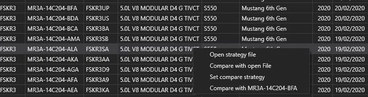

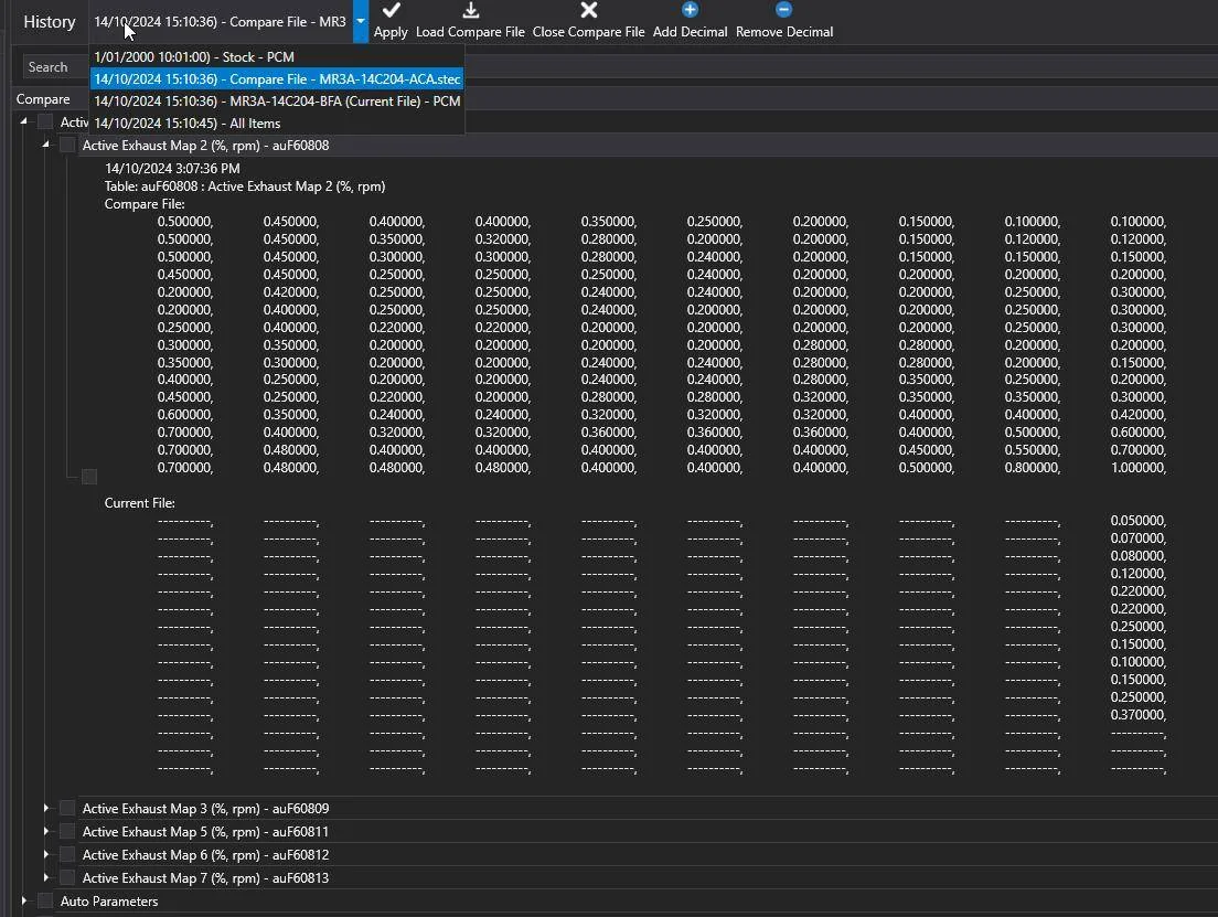

The best method is to compare say ALT1 and ALT2 of several maps (eg drag and sport in a Mustang) and see what Ford has done, you then figure out some ideas of what you might want to change.
Our software allows you to pick two stock files and compare them to assist in this. Here is an example.
Then for example you can see they have changed the active exhaust (and many other things) between the two years/models.
