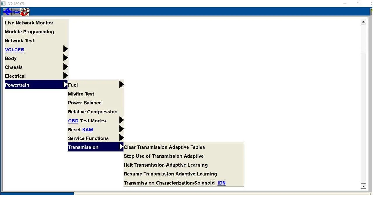

So I found out recently that you can turn off the 10R80 adaptive learning with the Ford IDS tool. I asked my tuner if this could be done and he said he would make some calls and get back to me. He just did and sent me a revision to try with adaptive learning turned off. Has anyone done this on here and if so, what can I expect. I had the adaptive learning. I just want it to shift consistently no matter the conditions.

I hear all of you and agree. I honestly think the adaptive learning does more harm than good. I just got a revision he wants me to try. When I get a chance to load it I will drive it for a while and report back. He was as intrigued as we are.

I had a chance to load this and drive a little and I have to say that eliminating the adaptive learning has made a very positive difference. Gear engagements are quick and on time and there is not any hunting. It is shifting as it is supposed to. Gonna drive it a few more days and report back. Not sure if the shifting from 2-3, 3-4, and 4-5 needs cleaned up where we worked on trying to overcome weird shifting in those gears (which is common with the 10R80), but for now it looks like it might be fine. It would be nice if the adaptive silliness was the issue all along. I will try to report back sometime next week.

I have put about 100 or so miles on it so far and just got a chance to try this with a cold transmission and I do believe the weird slippy/laggy cold shifts on the first run thought the gears is programmed into the adaptive learning and/or the torque management is disabled/lessened when adaptive learning is turned off because with it off the cold first shifts in those gears are very aggressive. More so than most people would like. Would be fine for racing, etc. where this is not a concern.
Warm, all the shifts are aggressive without the adaptive learning and again probably more than most would like, fine by me though.
Not sure if the cold shifts can now be programed to engage differently on that first run-through, but I may work on that. Back to the drawing board, but not giving up.
Sure they can, almost any aspect of this transmission can be programmed and changed. I'm a firm believer that 99% of the complaints about the transmission are tune related as in Ford did a really crappy job tuning it. I say that because other cars with the same or similar transmission (Mach, F150 and to some degree the Camaro) have better shifting. At the same time. I can say that getting an aftermarket tune has also improved the stock GT driving experience.
