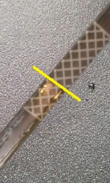

This is mine. At about 700 miles I took a look at the dipstick and observed the oil line was about at 1/3 from the bottom of the hash marks. Today at 1050 miles, it was just below\right at the bottom hole on the dipstick. Went to Ford, got 1 qt. of oil and added it. Now the oil is dead even with the top of the hash marks. So I am burning about 1/2 quart per 500 miles.
Check your oil boys and girls.
Not our dipstick but a visual representation of about where 1/3 was at 700 miles.
