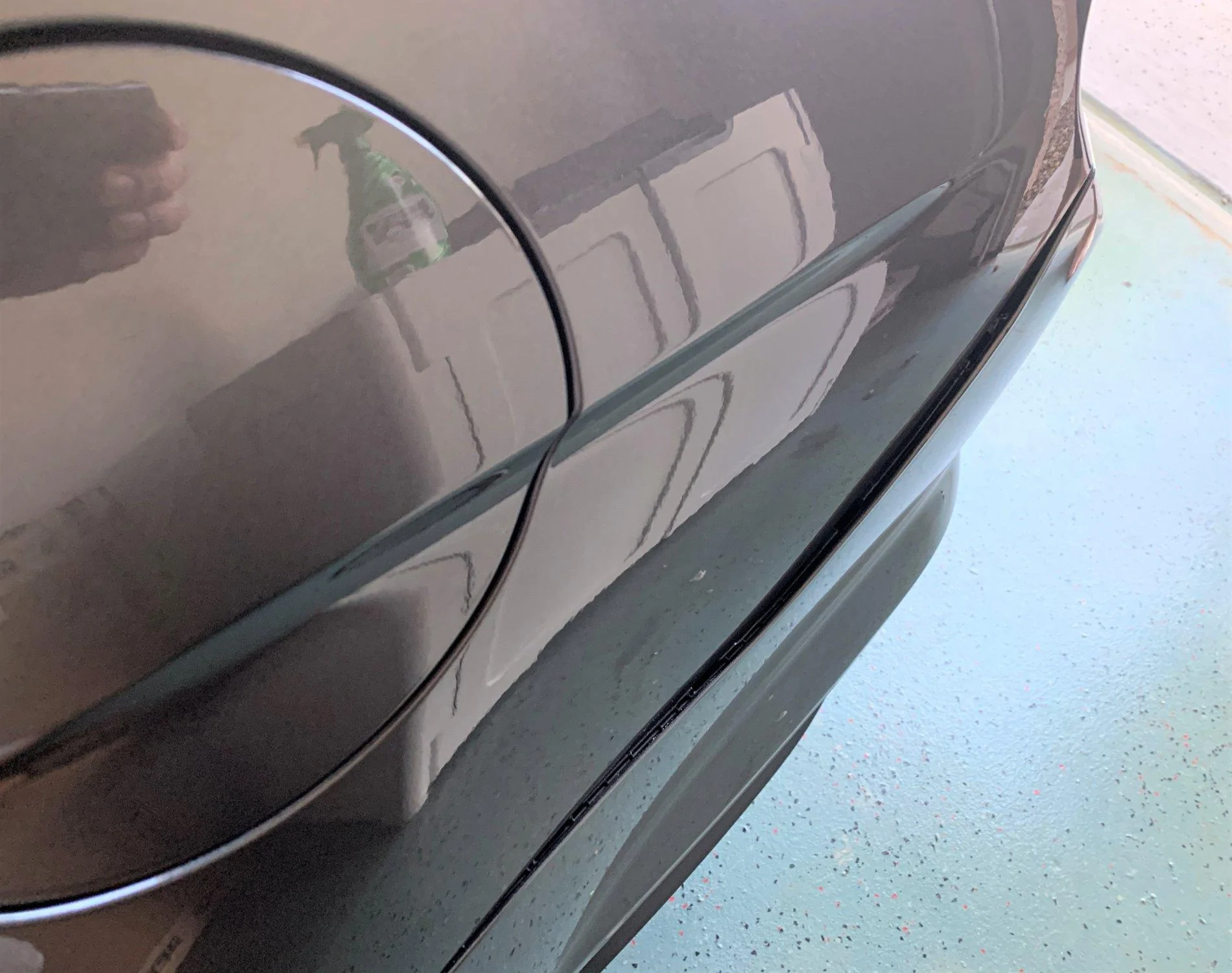

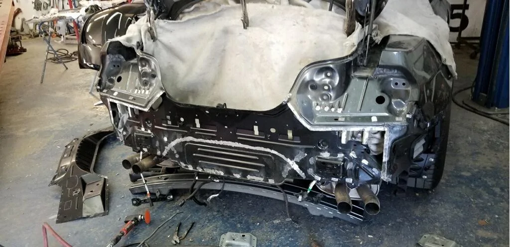

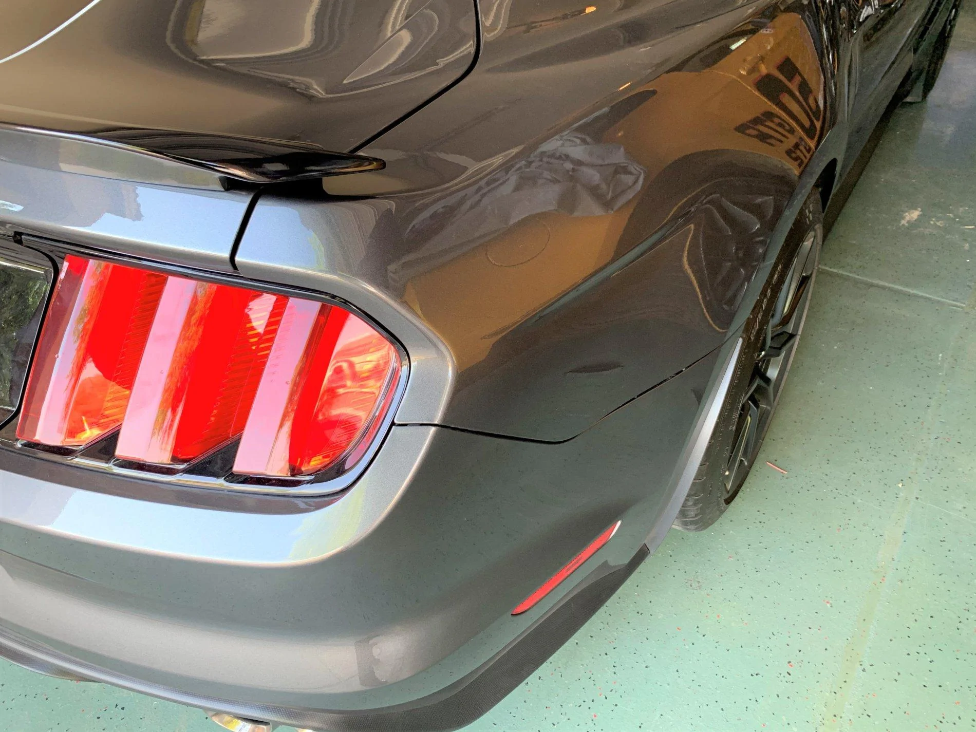

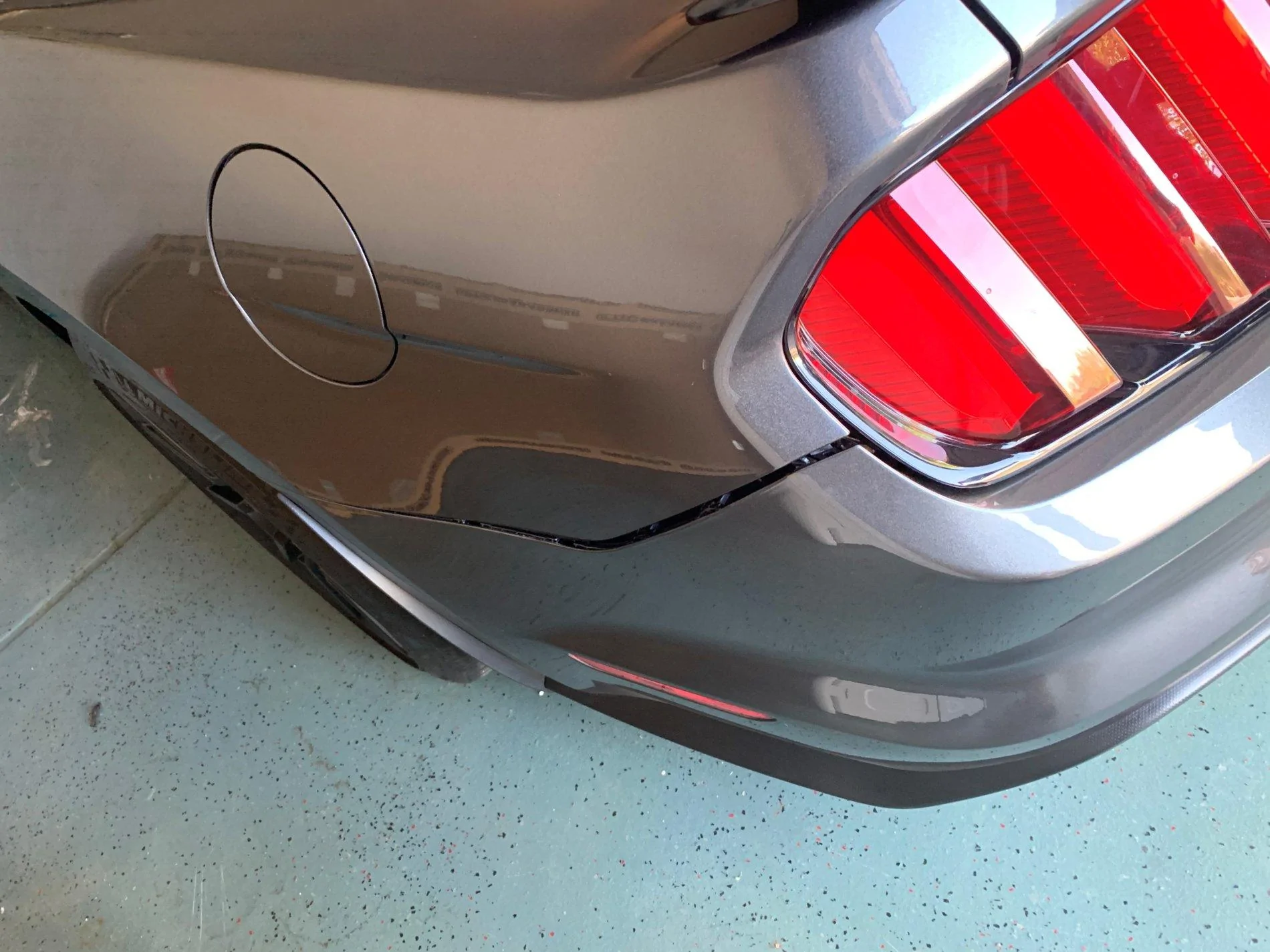

I have a 2016 Tech Pack with 11k mi on it. Recently in a rear end collision and had the bumper replaced (And all brackets) with oem ford parts. Took nearly 3 months to get the car back, and when I did the shop informed me they couldn't get the bumper to properly mate up to the old or new brackets.
It has the normal sag, but the sides won't clip into their receiver brackets or stay because the sag is so heavy.
Vehicle at frame shop having the rear sheet metal replaced
Post repairs:
Has anyone else had the sag so bad? I'm going to pull the cover and reset the brackets, and try to see if I can get my local dealer to perform the TSB (and if not, follow some of the other guides on here).
My biggest concern is there are other defects in the repair (a dent a PDR guy will have to look at, though I'm confident its a refinish of the panel and respray/blend, gave back with a nearly flat tire, covered in overspray) so I'm obviously frustrated, but want to make sure I'm pursuing the right avenues. Before there was some sag, but the panel at least was retained on the sides.

That is hands down the worst gap ever. Anywhere. That is faaaarrrr from "normal" sag my brotha. DO NOT accept that under any condition. If they can't get the skin to fit right, my first thought is that the sheetmetal/body where the black brackets attach to is not right. Either way, pursue it. That's insane.

You may have broken tabs on the bracket the bumper cover clips to on the side of the rear quarter panel. Much worse looking than mine but I only had one broken clip there and it impacted the fit. Replaced that bracket myself for $24 and it looks like it should.

I did choose the shop, the insurer's recommended shops were interviewed but passed on as I was worried about a cut-rate repair (ironic). The shop I went with was recommended as the best by the local car communities. The insured was State Farm, but they have been pretty miserable to work with. I'm still fighting for DV and to get these repairs corrected.
that said, I looked more closely, the bumper retaining tabs at least on the driver's side are indeed broken, which I believe means there's zero percent chance this can be fixed without replacing parts. I hate cars, shops, insurance companies and inattentive drivers.

The body shop has the car now and did the TSB. It did tighten up the fitment significantly, however on the driver's side they could never get the side bracket tabs to engage. I think the body isn't straight as everyone I've talked to said it was straightforward after the TSB (and we are in a warm climate which makes it a bit easier). They did however get the bracket on the bumper and were able to install the front and rear fastener for that bracket (leaving two out). As long as it holds, it looks great. When I get it home I'll be looking more closely. One tab did break on the new bumper cover, but it looks like the TSB fix held it in.
