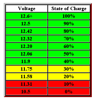

Do you have a volt meter? Charge the battery out of the car, let it sit for 8 hours and read the voltage. Refer to the chart. If the state of charge is good you might want to try a load reading. Crank the car and have someone read the voltage across the terminals. If it's 9 volts or less the battery is shot. This of course assumes the car's electronics will allow the starter motor to engage with a weak battery.
