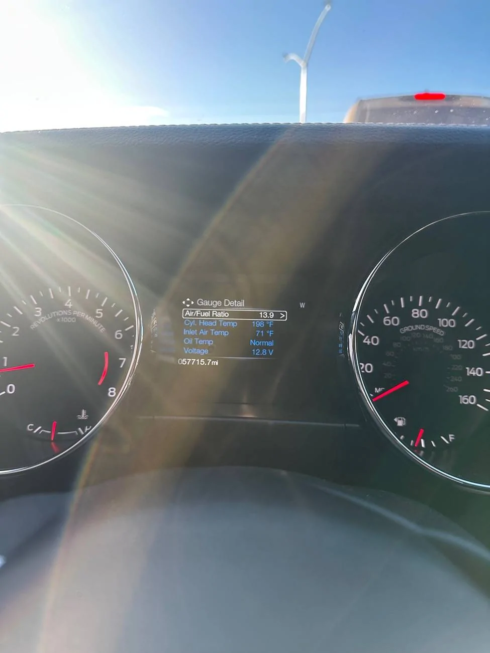

I replaced my battery probably like a year and a half ago? It’s getting pretty cold here now in AZ (cold for here) it was so weird. Has me worried
Do you park outside? My bet is the battery was low. Have you checked your voltage?

What is it supposed to be at?
On my car it varies with temperature. When I first start it on a cold morning, it's around 14.9V but after driving it for awhile with everything heated up (or in the summer) it'll be perhaps 14.2V or so. Remember that the static battery voltage is 12.6V (2.1V per cell) so 12.8V is barely above that threshold so it's not being charged.

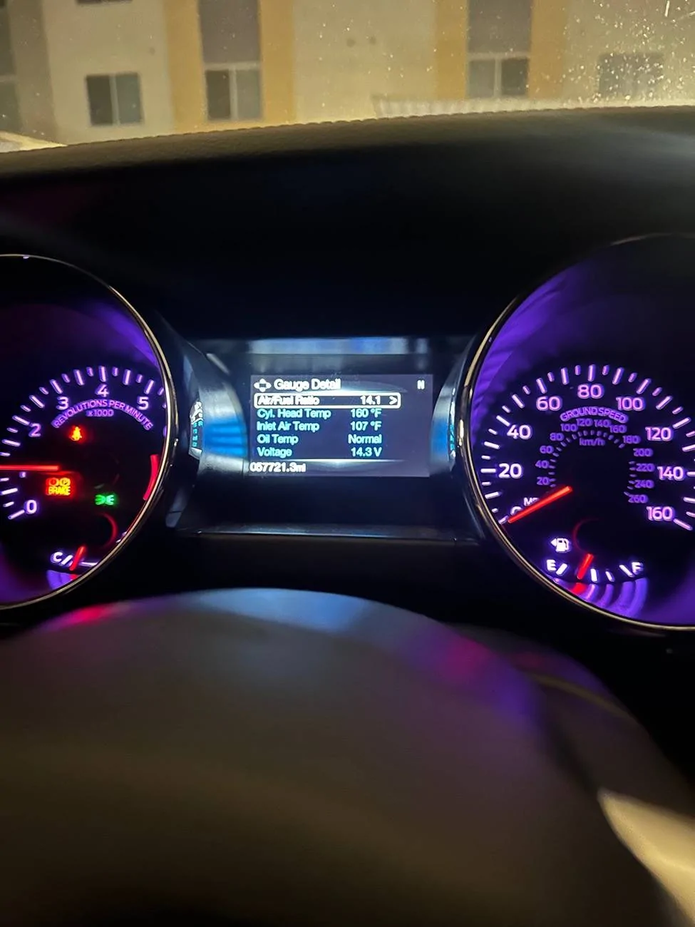

This is when I started it a little earlier.
