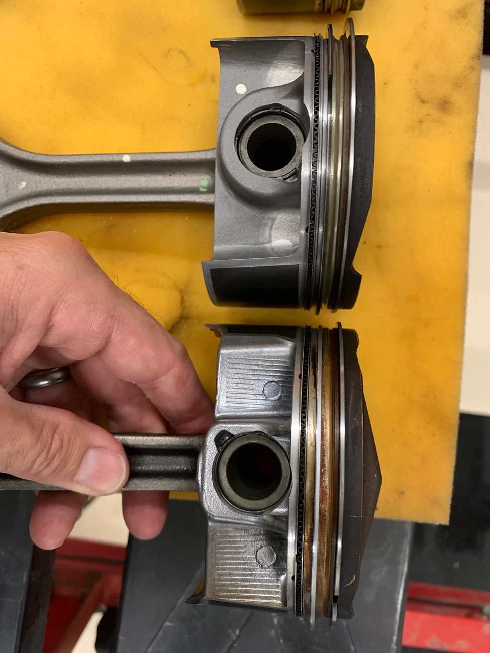

As I mentioned, I did all the math and research regarding stroking the short deck coyote. There’s only so much distance between the crank centerline and the deck. The rod (5.933) almost certainly has to be shortened if you add any stroke at all and your rod/stroke ratio gets worse in both the numerator and denominator. Even still you start pushing the pin higher up in the piston which squeezes the ring pack together, weakening the ring lands. It’s not pretty if you try going past 5.2. I wonder if they do actually build a 5.4 s650 will they go back to the tall deck block like s197 5.4.
Stock gt500 vs coyote piston:

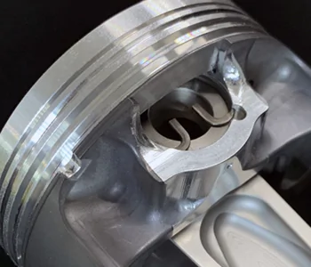

There's got to be a picture of the MMR 5.4 or 5.5 stroker Coyote pistons out there
