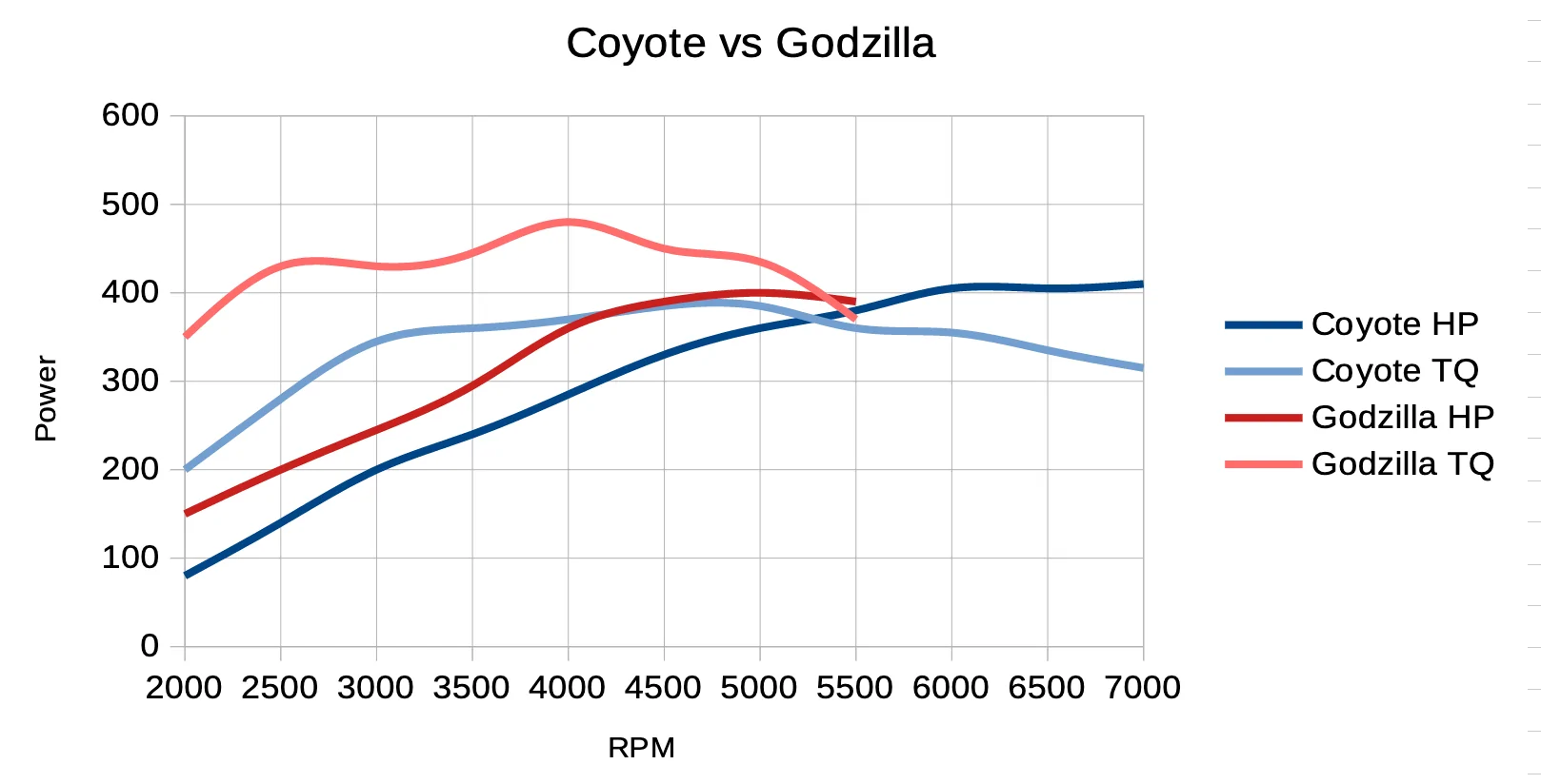

Again, like others have said, the coyote platform can only top out around 5.4L before a major rework would have to occur to get more displacement.
My personal opinion…. I’d take the Godzilla over a Coyote any day. Simplicity is not to be underestimated. It’s impressive what Ford has been able to accomplish with the Coyote but it’s an extremely complicated engine pushed to the absolute limits to get that HP. The Godzilla is just getting started at its stock HP. Just a cam gets 600+hp as you said. Imagine a higher RPM focused head and intake design… 700HP N.A. on pump gas without direct injection.and mentioned 2 possiblbe
Your comment about torque is wildly inaccurate…. Peak torque might be somewhat close but the Godzilla is making more torque at 2K rpm then the coyote ever makes in stock form. Those Godzillas with a cam are making over 500tq at 2k rpm. The coyote needs a blower to even get close to that.
So everyone has their personal preference, you can like the coyote or Godzilla. Either is valid, moral of the story though is the coyote is at its limit without a complete redesign…

Not trying to get into a debate either so I apologize if that sounded harsher then intended.
A v10 coyote would be awesome but unfortunately would never happen. Modular doesn’t mean modular like you would think. Could these things be done? Absolutely, but you don’t get anything for free… A taller deck would require a longer connecting rod which would limit RPM for instance.
Bottom line is I think Ford has exactly what they want with the coyote and don’t feel the need to move beyond the standard configuration. The Godzilla was created for an entirely different purpose where longevity and durability were higher requirements than HP. Its simplicity is key to that durability and something a coyote based engine couldn’t replicate.
