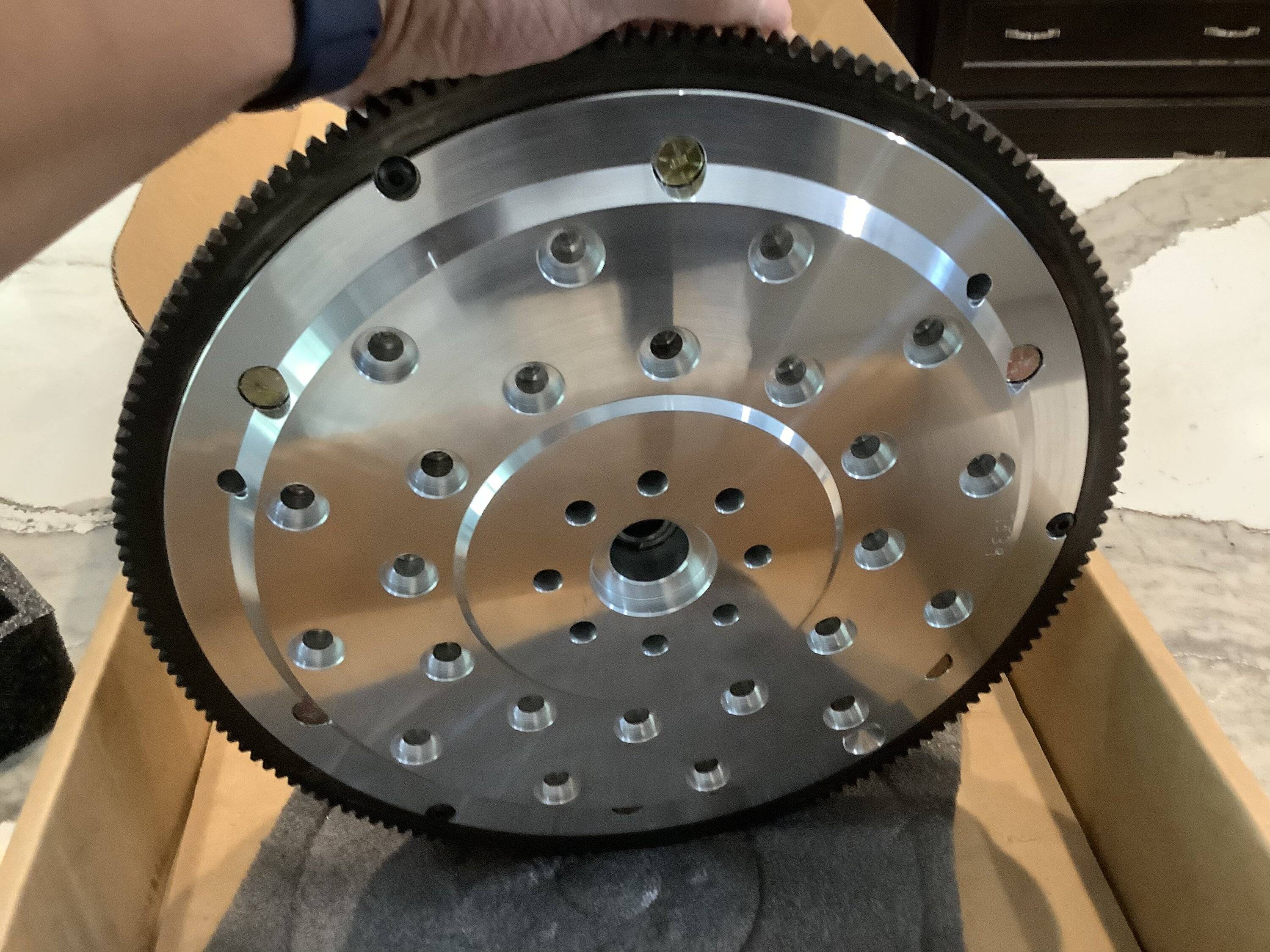

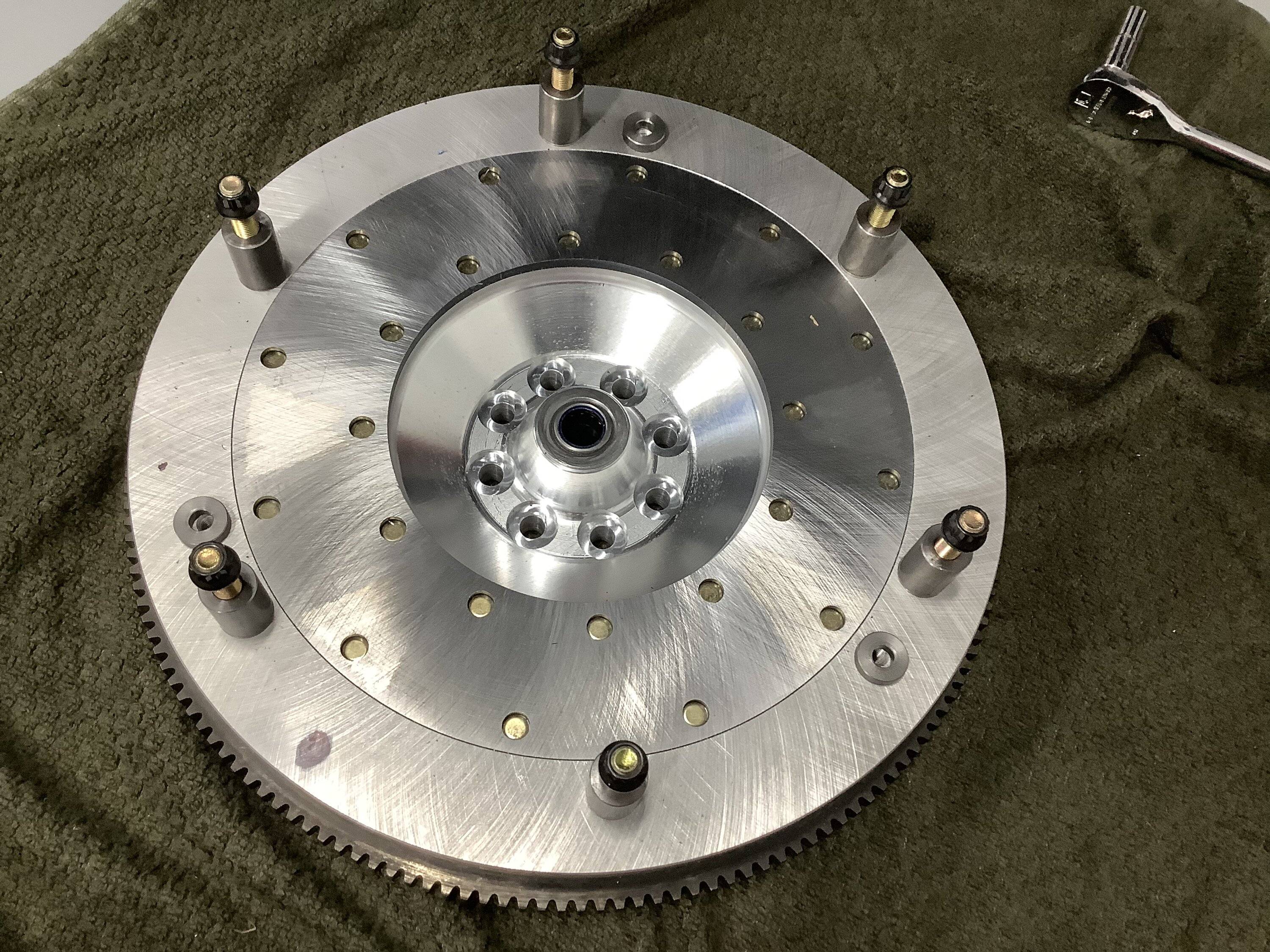

I just put a Ram Pro Street Twin Disc with an aluminum flywheel in my 2019 Bullitt. I’m a ways off from testing it out though.
