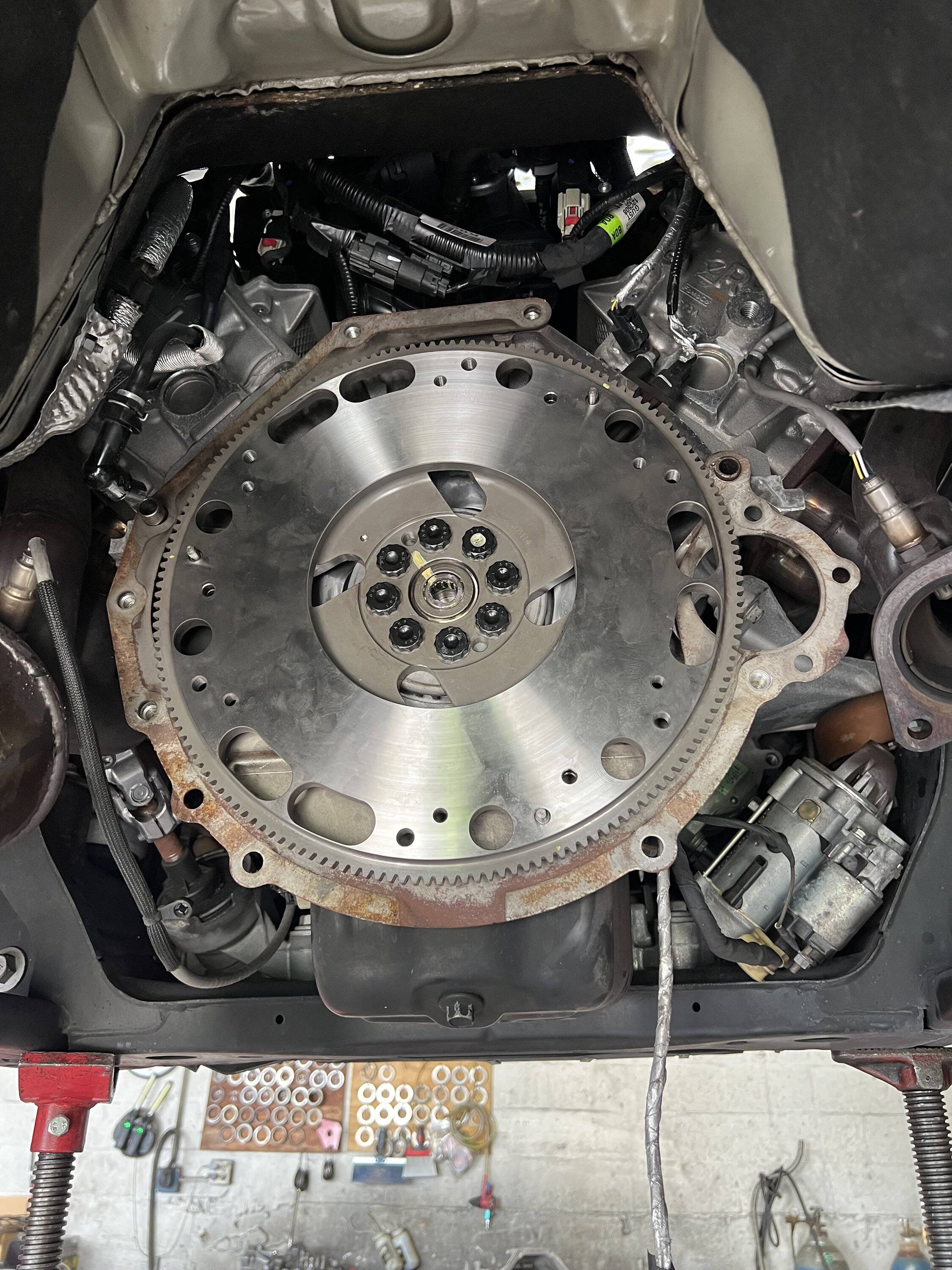

So, I finally got around to having a new clutch, flywheel, pilot bearing, braided clutch line and throwout installed on my 16 GT.
I have at least one previous thread about transmission woes and I had my car at two different dealers who dismissed it stating nothing was wrong. I had a pretty noticeable ā€œrocks in a grinderā€ sound at idle, foot off the clutch. If you blipped the gas it became very noticeable. There was also some not so great sounds on deceleration at low speed and shifting quality took a dump.
New parts:
Exedy Mach 500 clutch (organic, rated to just under 500 ft lb torque)
Exedy lightweight chromoly flywheel
Exedy throwout (same markings as Ford, same manufacturer it seems.. FTD?)
Steeda braided clutch line
Pilot bearing (came with the kit)
ARP bolts
First impression - nervous. The pedal engaged right off the floor. I suspected there was still some air that needed to be bled. As I drove, this cleared up and pedal engagement went back to normal.
Second impression - the flywheel. Wow! The engine WAY more responsive. It turns up very quick now just free revving. It’s much more responsive under throttle as well and feels AWESOME.
Shifting quality is restored, other than the fact the stock shifter feels like a pile of hot turd. Should’ve done a short throw while it was apart, but I wanted to see how this went first. Everything is nice and smooth. It feels much like a stock clutch and it’s not jerky at all.
Noise issues: I would say are about 85%-90% resolved. I will definitely say that the lockout collar on the shifter is a horrible contribution to transmission noise. I do have a slight amount of the original noise (rocks in grinder), but it has been way reduced. No more funky deceleration noises, either.
Overall, I’m really happy initially. Hopefully everything breaks in nicely!

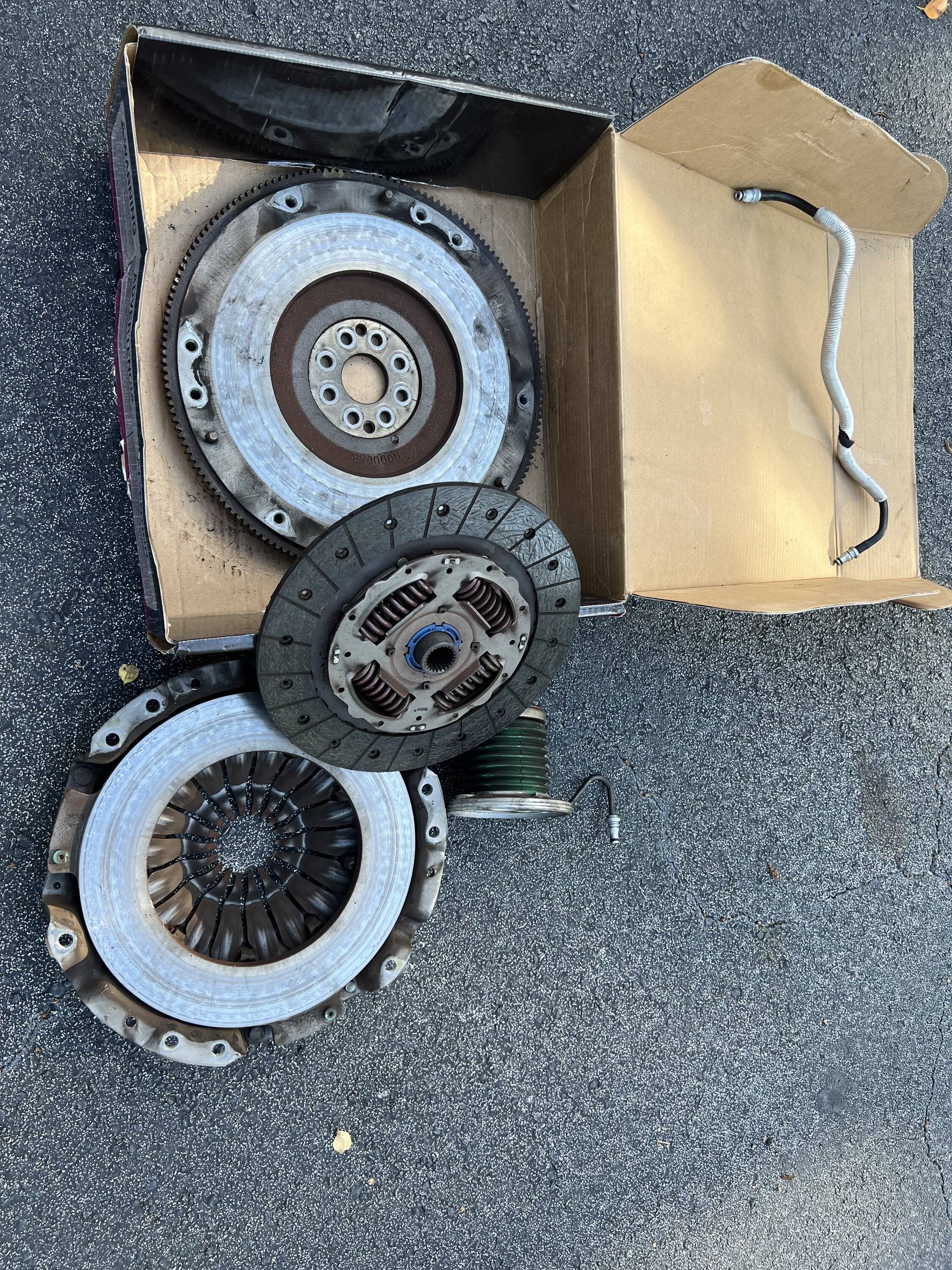

I kept the OEM parts to see if I could identify anything wrong with them. Noticed a few things:
The clutch material looked fine, probably 40-50% life (49k on the car). However, it got hot at some point. There are some pretty noticeable hot spots on both the flywheel and pressure plate, which would explain why it was also very chattery.
The clutch disk hub/spline had a lot of play. I think this was a contributor to at least some of the noises I was hearing. The disk would’ve been able to oscillate a decent bit.
Throwout bearing wasn’t notable destroyed but did have a lot more play on the hub surface than the new one.
The stock clutch brand is Valero, made in Turkey. The stock flywheel is too damn heavy.

Thanks for sharing the pics. The new Flywheel looks great!
