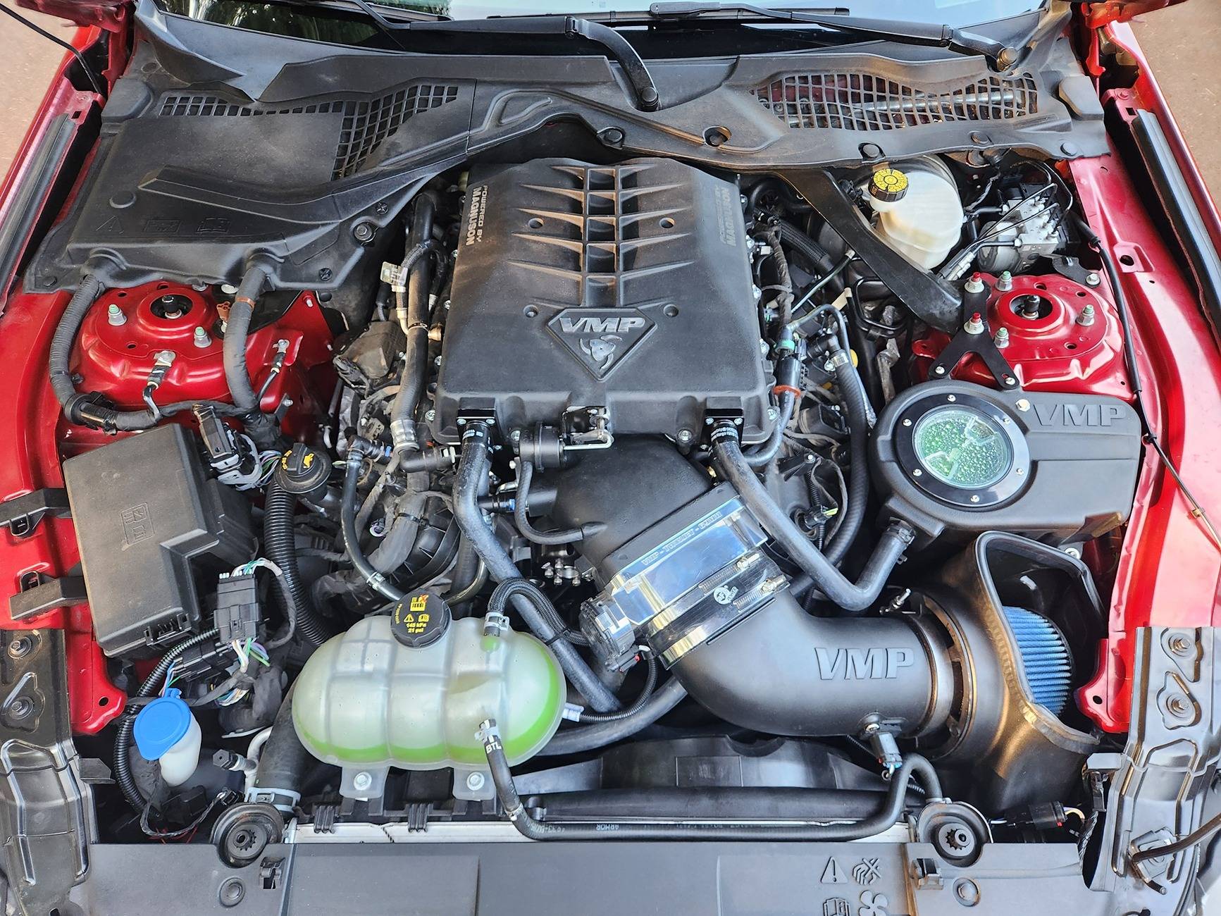

Ford installs the TVS style blowers on their vehicles at the factory so that is the style of blower I went with. Roush, VMP Odin, Edelbrock and some others are all the same internals. The components of the kit were the determining factor as well as customer support. I chose the full VMP Odin stage 2 kit with upgraded underhood ice tank. It includes 56# injectors and a dual fan heat exchanger. The cooling capacity of the Roush due to it being an older generation unit is not equal to the VMP Odin's inverted set up with the cooling packs on top of the rotors. I absolutely love it. VMP customer service is very good and tuning revisions are part of the deal to get it dialed in to your specific set up.
