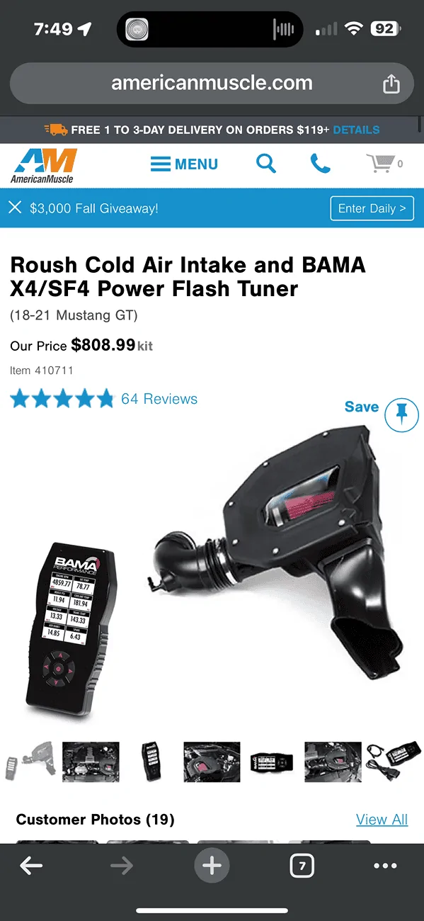

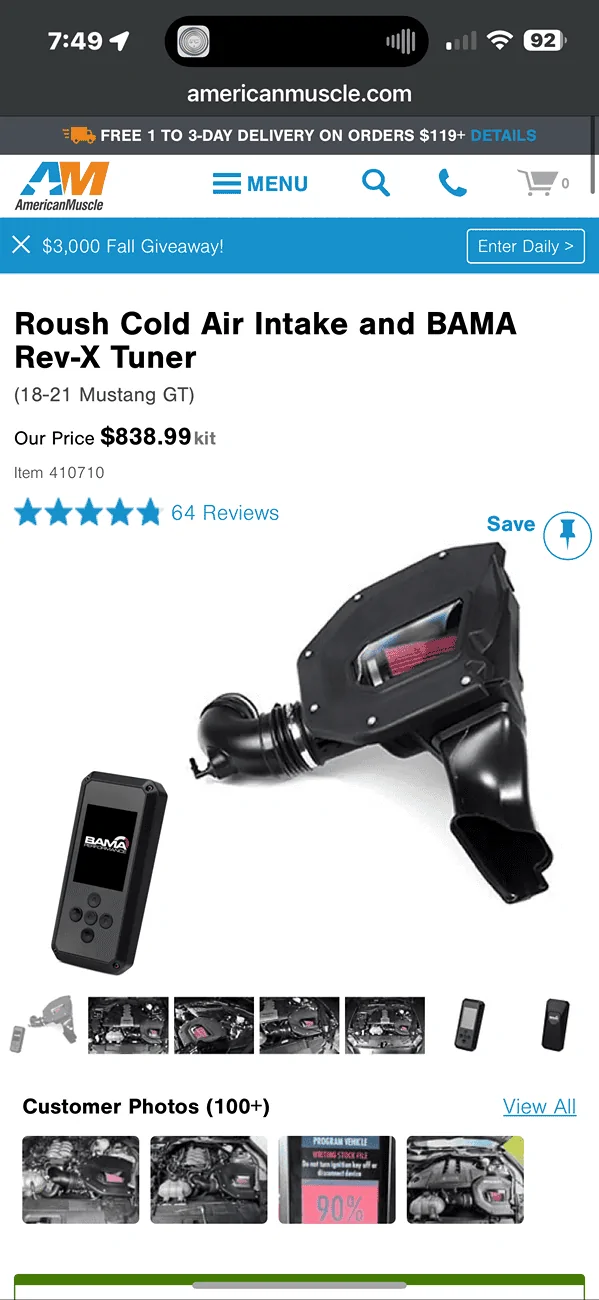

hello everyone, so I have a 2020 Mustang GT non pp. and I would like to get a Roush cold air intake. I like the closed see through box. But I know I need a tune to get its full potential. And well, I know NOTHING of tuning. Literally clueless, so I have credit on American muscle that I’ll save till Black Friday. And I know this is way early, but I would like to know what I want to get. Soo what tuning device should I get ? They have 2 kits for the Roush CAI. One comes with the Bama Rev-X Tuner and the other comes with Bama X4/SF4 Power Flash Tuner. Are either of those good? Or should I get another device??. I don’t plan on doing major tuning/modification to the car since I DD this. My main things I would like to get, is CAI and headers. I would like to get a tune so I can pass emissions when I get CATTED headers. But due to price on headers those will wait a while for now. But the CAI I really want to get for Black Friday though American Muscle so I could use that credit and save me money. ($200 worth of credit) please if yall could help me, I really want to learn.

I'll be the first, RUN from Bama tunes.

Those are just SCT devices, the RevX is the newer of the two. Find a tuner other than Bama that supports SCT and they can send you a better tune for the device
