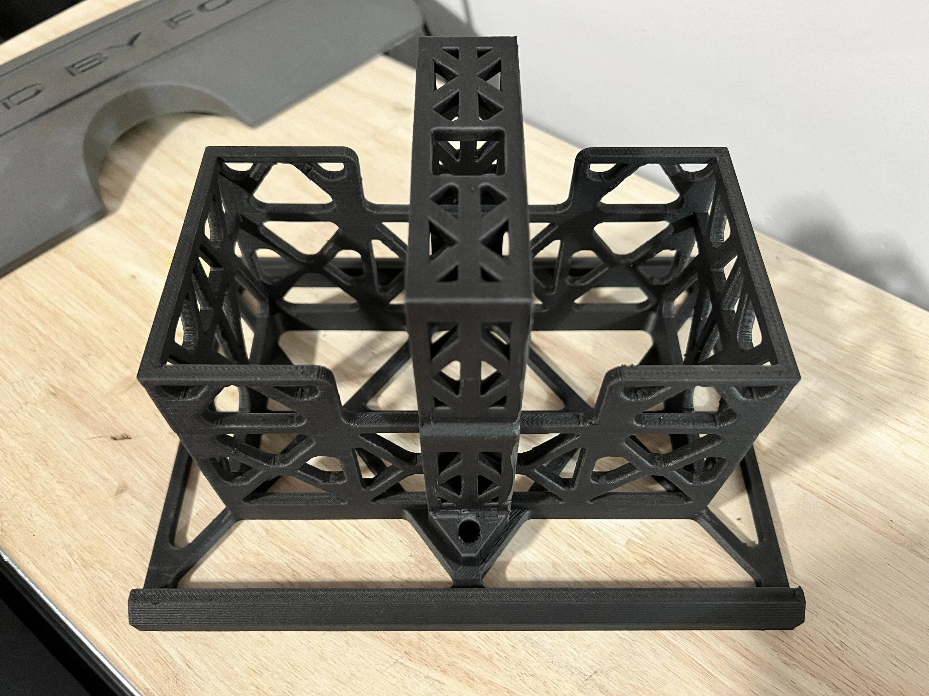

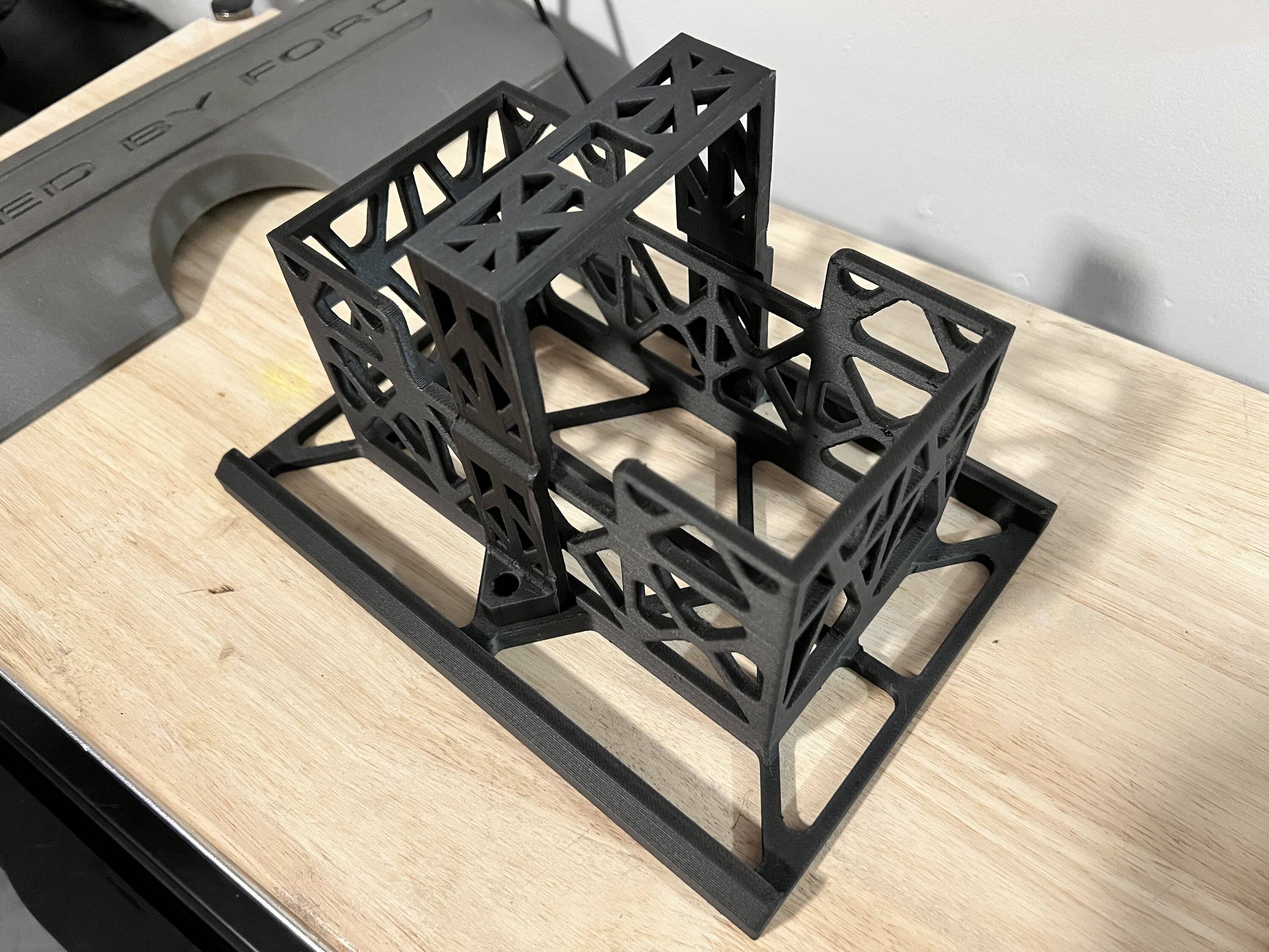

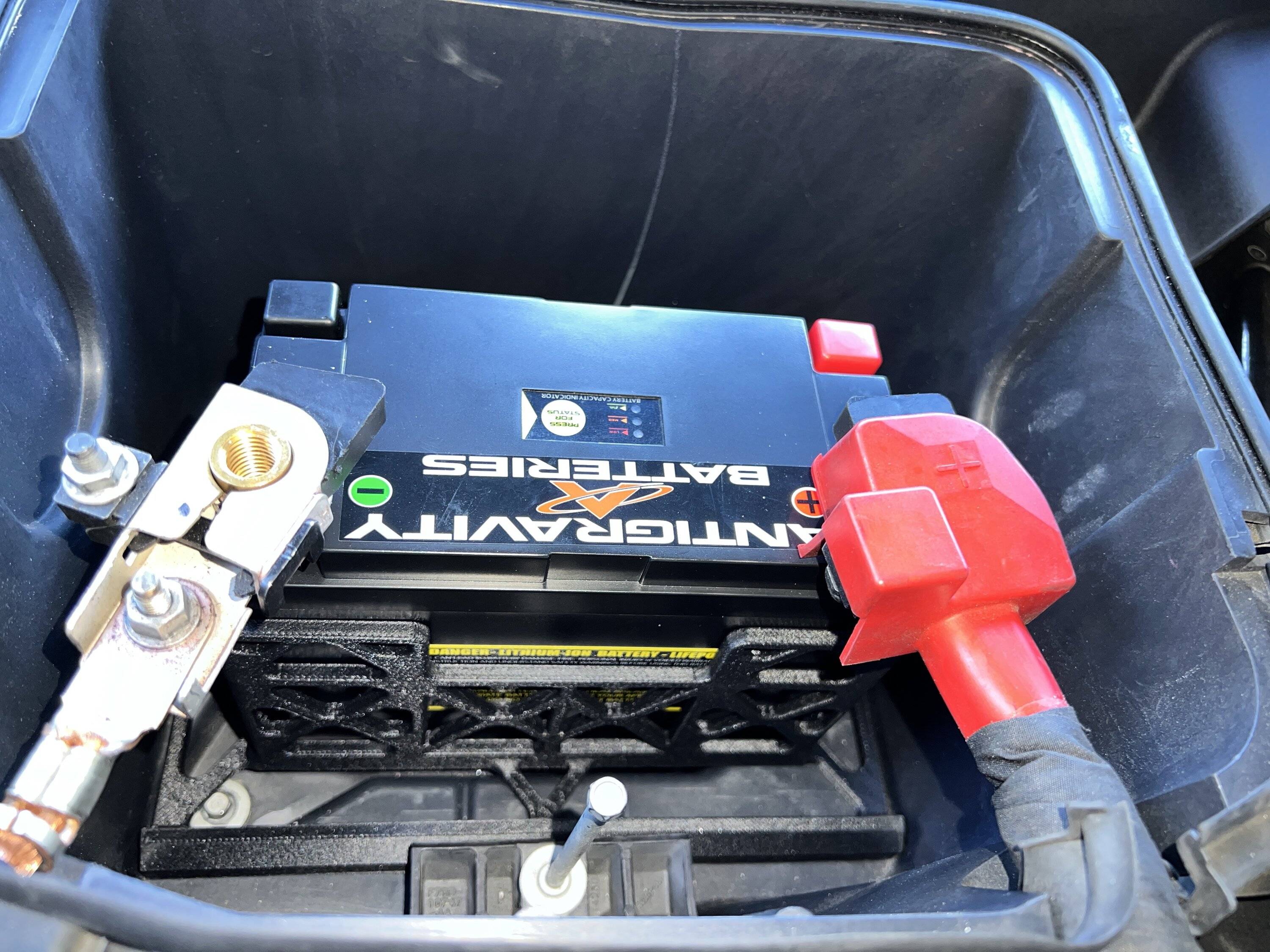

move been continually working on updates to my Carbon Fiber 3D printed battery tray. Total weight with strap is 209 grams.
Advancements in filament and software has given different options in the final product. Here are a few shots.
Note the finger hole so that you can reset the battery button
This tray will accommodate an Antigravity ATX-20HD

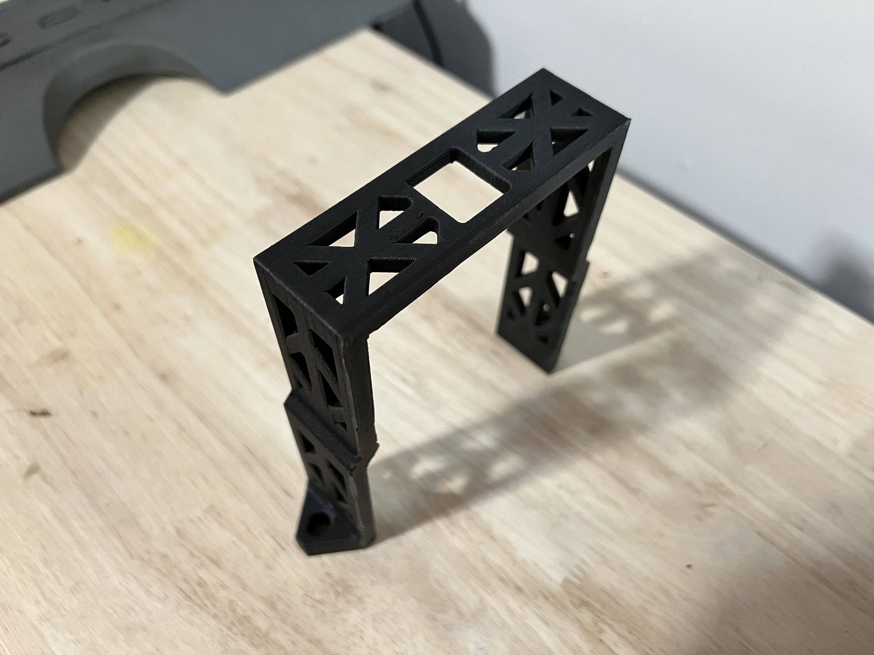

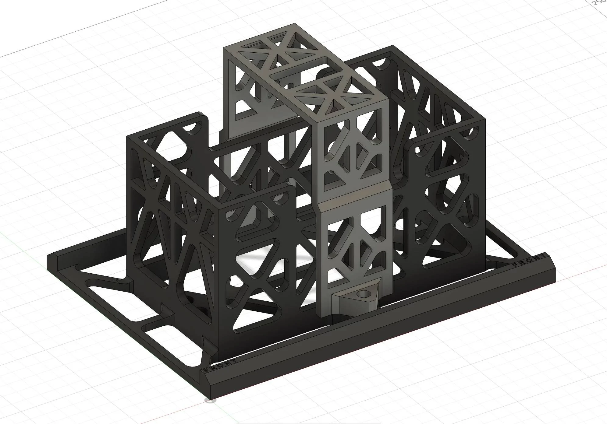

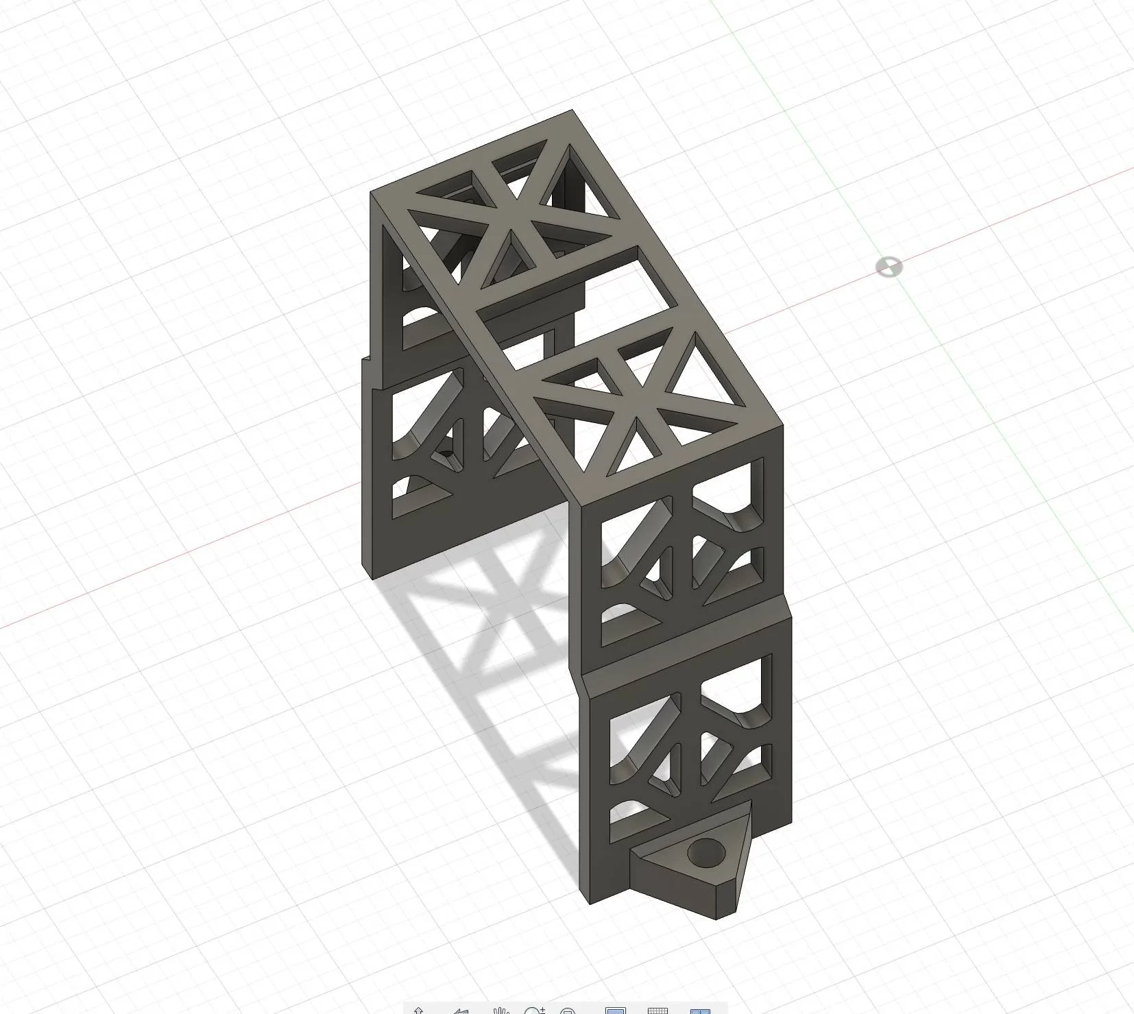

Hey M6G'ers,
Update with more details on the CF Battery Tray,
I'm currently designing and printing a revised strap with a bigger "Window". All new units will have this piece. Screenshots to follow.

Yeah Todd, that's pretty sweet. I have the Repop3d one, and I like your desing much better. The battery is a P-I-T-A to get in and out of the actual hold down. Once in, it looks and fits great, but not user friendly.
One thing I have from experience on this case and yours looks to be similiar, I wish the case raised the battery about 1/4", 1/2 at most. this would leave the cables in more of a straight line instead of dipping down inside the box just slightly; or such was the case when I mounted this one. Just a thought.

Yeah Todd, that's pretty sweet. I have the Repop3d one, and I like your design much better. The battery is a P-I-T-A to get in and out of the actual hold down. Once in, it looks and fits great, but not user friendly.
One thing I have from experience on this case and yours looks to be similar, I wish the case raised the battery about 1/4", 1/2 at most. this would leave the cables in more of a straight line instead of dipping down inside the box just slightly; or such was the case when I mounted this one. Just a thought.
Hi @galaxy , thank you for your feedback.
To your point, we identified the height issue early on and adjusted the height so that there is no stress on the cables.

I cut my battery box to make it all work with the Antigravity solution. Too bad the LiPo was insufficient for the magride/dsc.

I moved on to an AGM. I have the whole saga in my build thread.
Long story short, pushing the car at all, LiPo is not the answer in my case (BMS doesn't like the LiPo BMS). Some folks have had better luck. But I found folks running LiPo aren't running DSC's for the most part.
