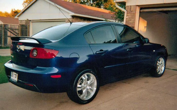

I had a set of Voxx wheels on my Mazda. I liked them, but the clearcoat on the polished rim lasted about 6 months before it started to peel. They told me to kick rocks. Buyer beware.
