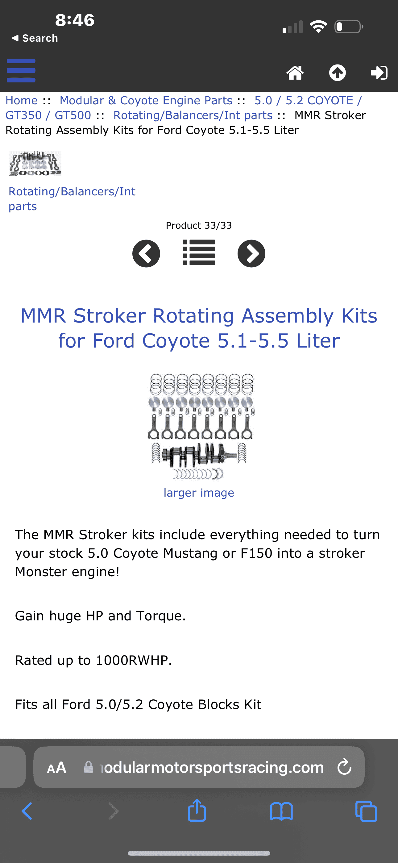

If you’re gonna use the phrase N/A build
5.2 or 5.4 stroker, cnc’d heads, custom cams, CJ intake, converter, full exhaust.
