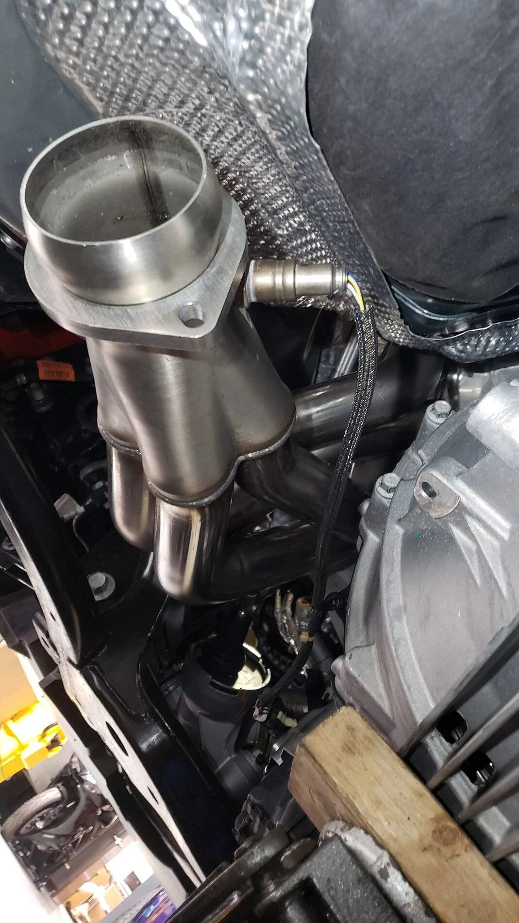

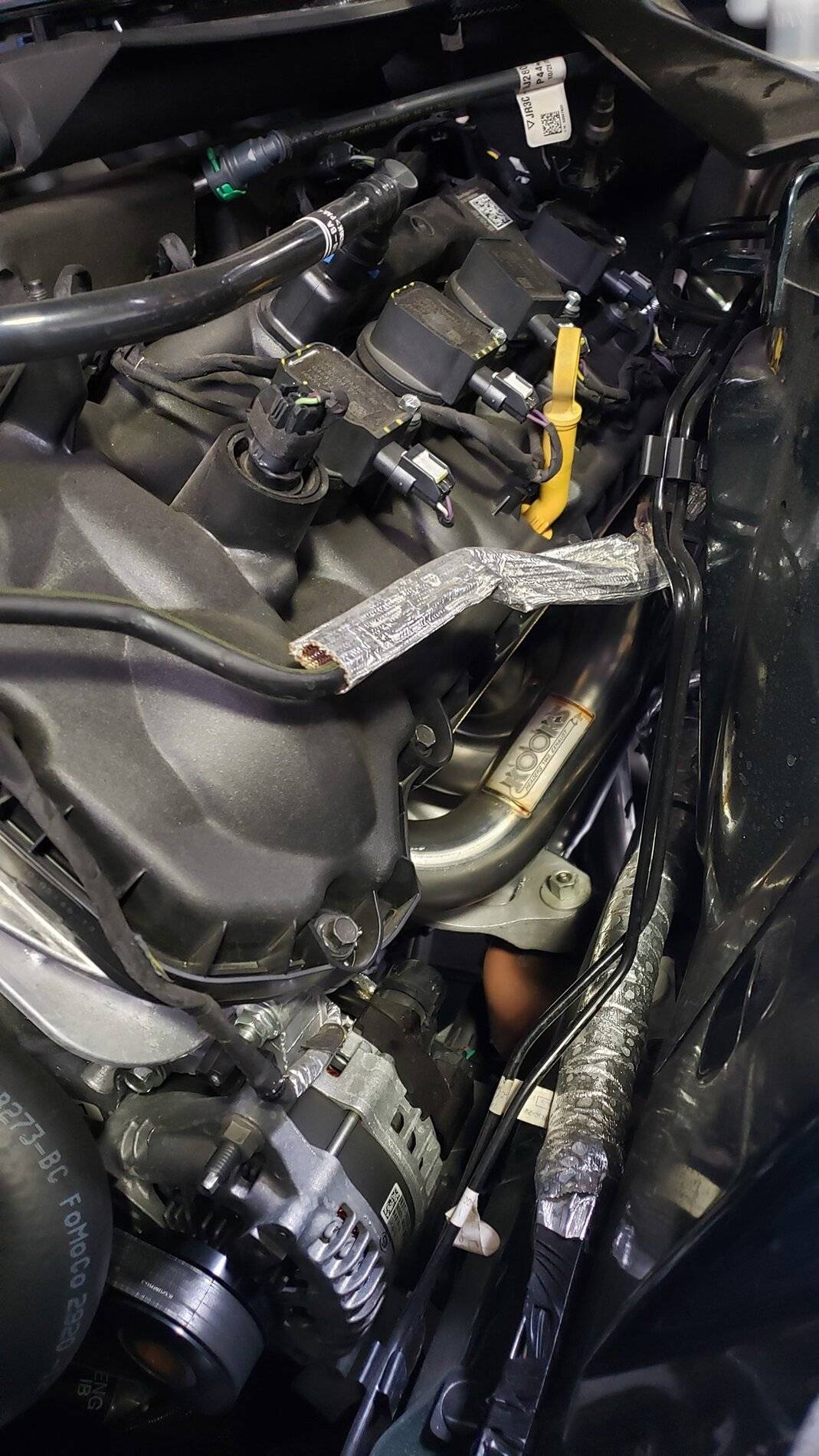

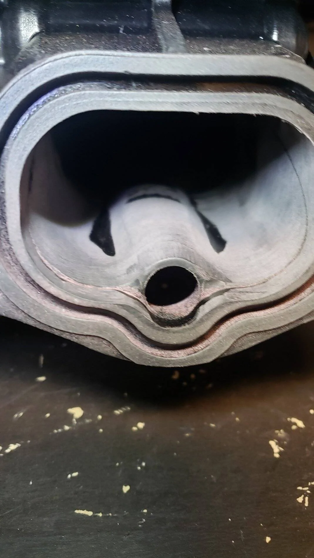

I have a 2020 Bullitt basic bolt ons right now with a 93 tune. looking to do a full out N/A Build for max power.
Current Mods:
Kooks 2" Long Tube headers Catted
Corsa Extreme Cat Back
Ported GT350 Intake manifold
93 Tune
Besides Engine Mods what looking for ideal suspension route y'all would recommend see if it matches up with what I've been thinking about for good handholding street / strip.

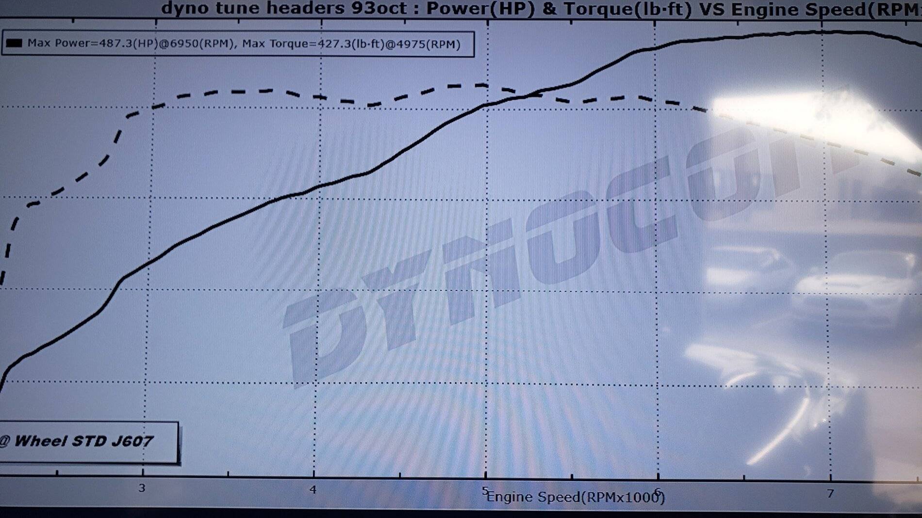

Sitting right about 487 to the wheel right now.
Looking to get to mid to high 500s on an N/A set up what has everyone seen so far? What would you guys recommend next or the route to go? Definitly next upgrades are going to be Billet Oil pump and Crank Sprocket.

Gt350 manifold over stock ported manifold? That’s interesting, I have a ‘21 gt and ported my stock manifold. I wonder if the 350 would’ve netted me anything…also for dyno numbers sounds like you were on an air density dyno. Most guys pushing 500+ N/A w/ out E85 have achieved it via a mustang dyno

I think mid to high 500s seems like a tall order N/A, unless you do cams, head work. The easy way is some sort of power adder (ie, blower, turbo or my favorite, nitrous). Your numbers are very respectable btw. I basically have most of the same mods that you have and you picked up about 18 more hp and 7 less rwtq than me. I’m also on an E85 tune. Now with a 150 shot of nitrous, I picked up 170 additional rwhp and 168 additional rwtq. Looking forward to see how you squeeze more out of your Bullitt.
