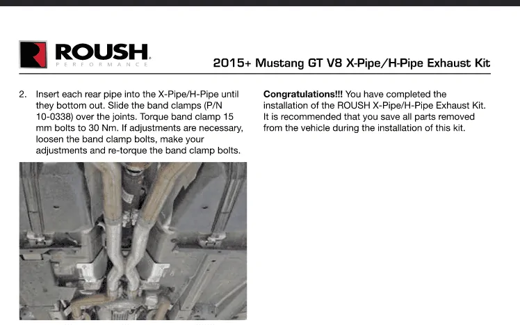

Guess it depends on the horse 30nm is ruffly 20ftlbs
Giddyup!

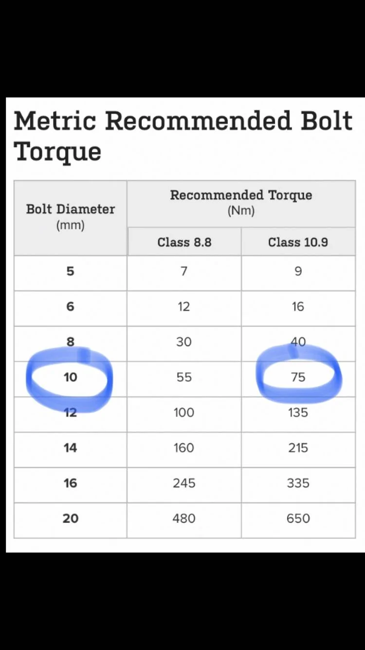

Roush must be using the Chinezium clamps.
Accu Seal uses a 10mm 10.9 T-bolt. Any machinery handbook has the proper fastener torque value.

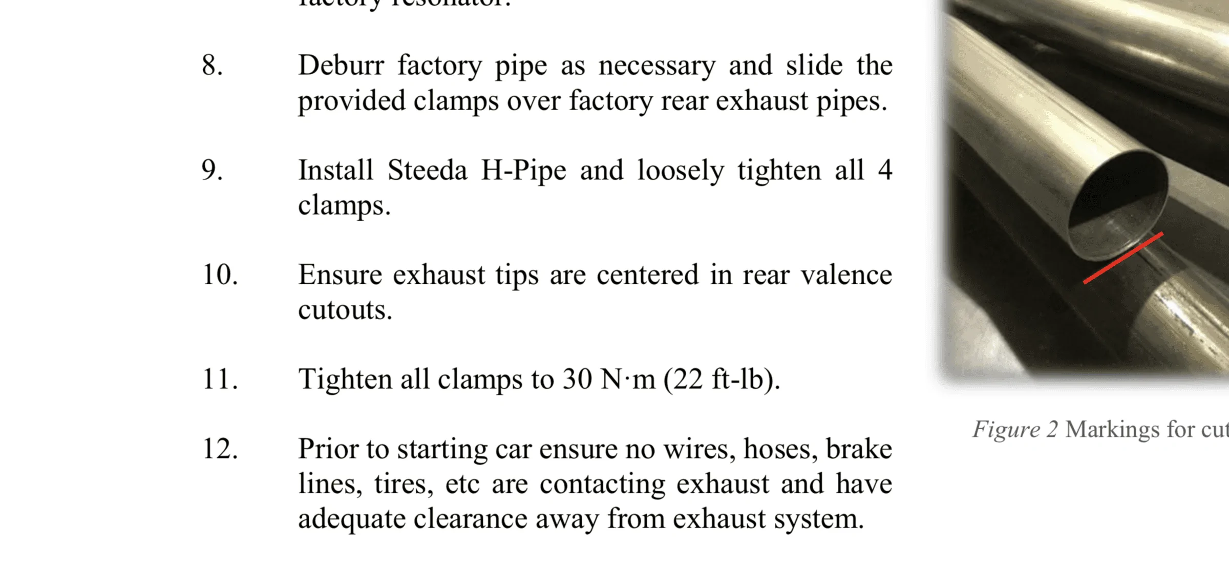

Steeda’s spec :
WD :like:

Yike, no wonder there’s discussions on weld tacking clamp joints, sagging exhaust systems and stuff not staying aligned after several heat cycles.
Borla is at 35 ft lbs.
At least Borla is 5 ft lbs closer to Accu Seals 40 to 60 ft lbs. range.

bolt torque isn't as big deal as thickness/strength of the band material.
Steeda's paper-thin band material isn't going to work any better at 40+ft/lb than it does at 25.
