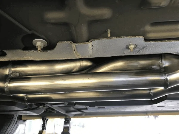

The issue with the non-steeda one is that the welds at the H can break due to vibrations. The steeda uses a brace to stop that. Also, the metal used by the AM part is probably going to rust and rot away rather quickly.

Had Steeda H Pipe installed yesterday by Steeda Performance here locally. Knowing Steeda may be a bit more expensive but having them 15 minutes away in case there are any issues over time is worth the extra cost to me. The sound is better than I expected, wifey says a little on the loud side!.

Biggest difference between those two is the AM uses 409 and Steeda uses 304 stainless steel. That and the brace reinforcement as mentioned.
No, it won't. The AM version still uses stainless steel, a lesser grade, but still stainless. 409 will get surface rust, but not rust thru. the better 304 will maintain a shiny surface if you clean and polish it periodically.
