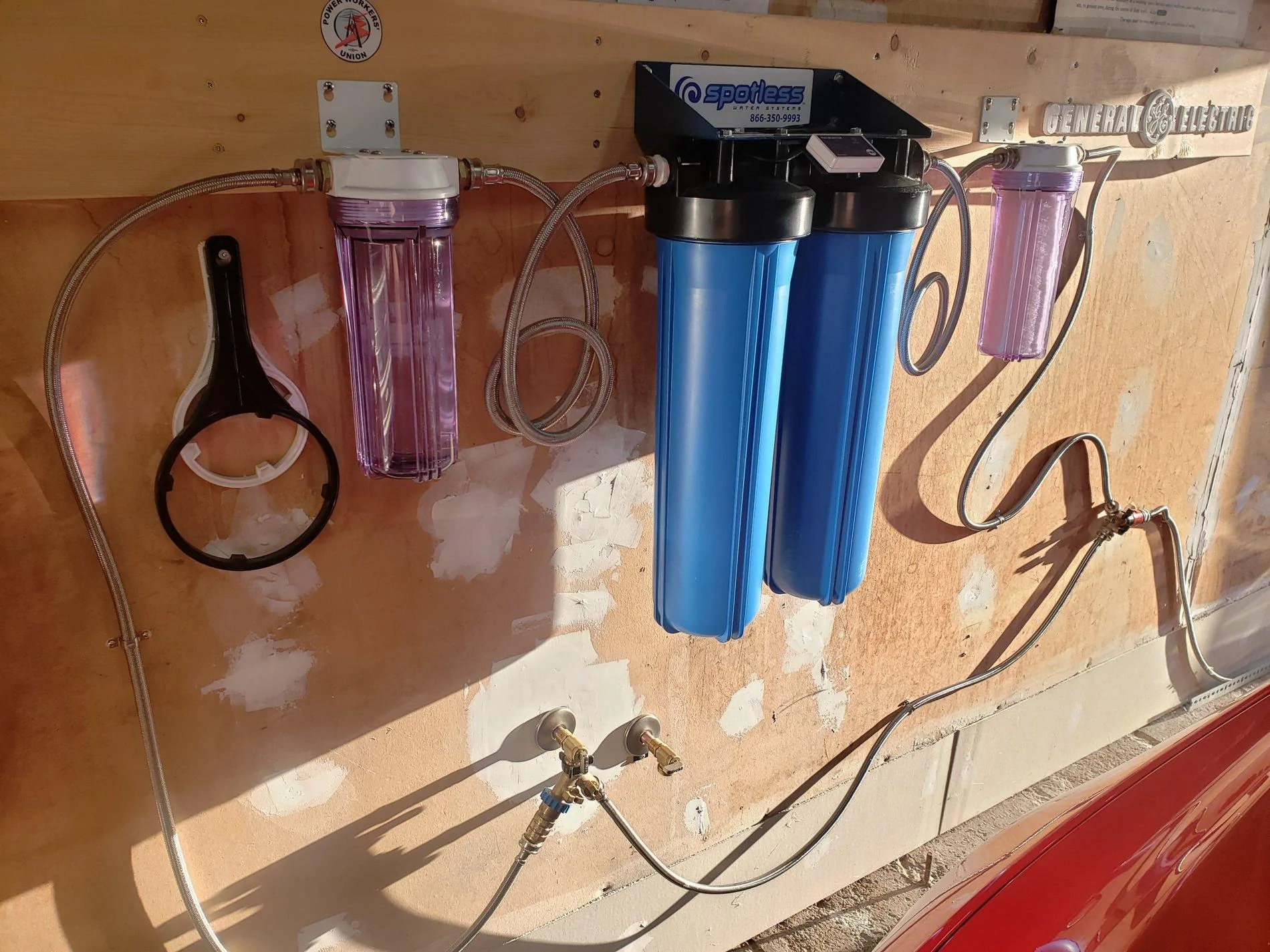

Here's my setup....
I have a sediment filter after my resin filters. I have a screen washer at the inlet to my filters and I want any sediment / dust created by the resins captured before it leaves my hose end. Kinda backwards to convention but it works great. The first empty canister is there more as a visual to the water entering the system. I had an extra one so figured why not plumb it it.
Also have a 3 way valve to switch between filter / non filter water easily.
I have a 55 gallon aquarium so the DI water is great for water changes. Also this past weekend I cleaned all the exterior of the house. No drying the windows. Just power wash with DI water and watch it dry.
For you guys that go thru alot of resins, rvtransformers is the cheapest / best source of resin fyi.
1 cubic foot does me an entire season of washing both vehicles and the house. I don't use it just for the final rinse either I use it for the entire wash. The cubic foot cost $225 usd and will fill both my filters 2x each with some left over for the next year.
I have a flow meter that I use to see my usage. The TDS meter will get up to around 10 ppm after about 500 gallons. It still drys spot free at 10ppm but I change the resins out at this level.
after I got my first taste of the mr. Clean Auto dry about 20 years ago after it went off the market my quest for my own DI water system started.
The best part about it is if your car isn't your daily when it gets dusty just give it a foam cannon blast / di rinse and you won't have to touch the car at all for a truly touchless wash. This will work indefinitely as long as the car doesn't see rain.

Interesting set up. Do you catch anything from the CR Spotless resins?
No there's never any sediment or anything after the di filters. It's there now just because I don't want to remove it just in case the downtube comes loose and resins come firing out.
I have that sediment filter there from before I converted to a downtube system. The shitty cartridges would leak and it would catch the DI resins before they would get shot out at my car.

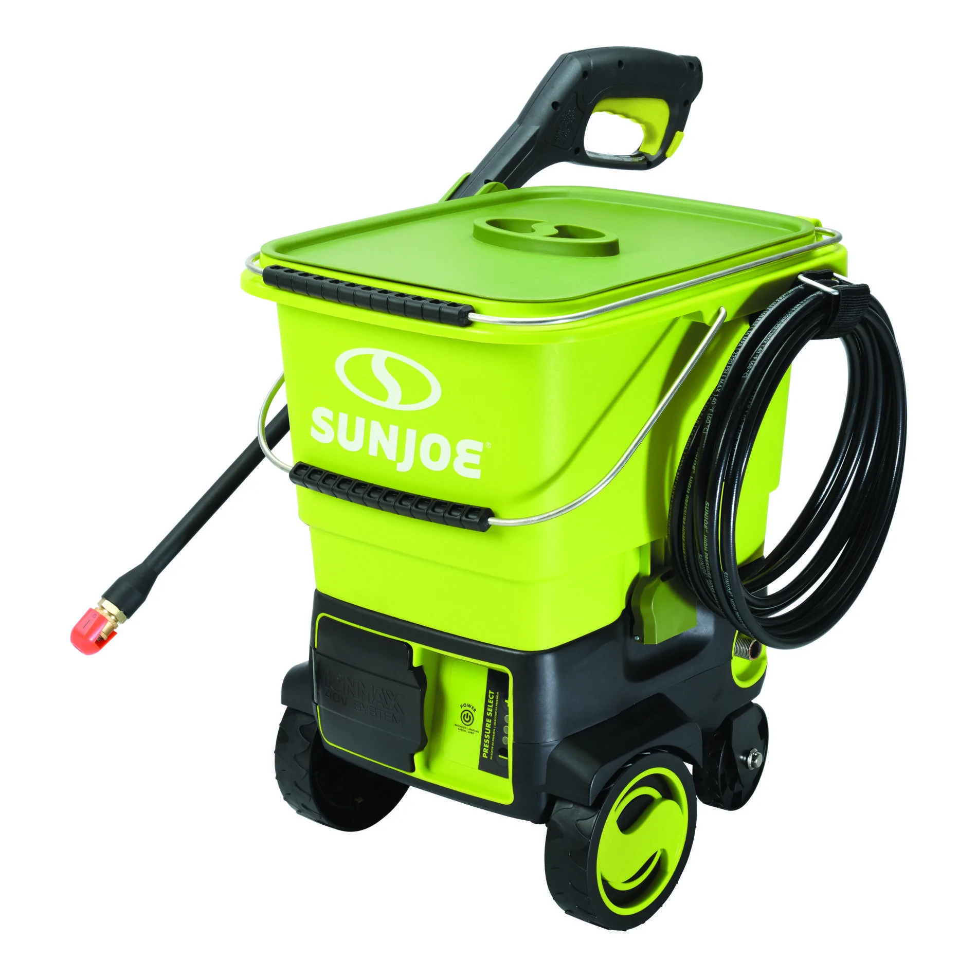

We are the last house on the water line and have extremely hard and low pressure public water. I looked into the DI water filters and although they would work great I would be changing resin a lot more often than i'd like. I ended up buying this battery powered pressure washer with a 5.3 gallon water reservoir. I buy distilled water at Walmart for 80 cents a gallon and use about 6-8 gallons per wash. If my car is very dirty I stop at my local car wash on the way home (doesn't have spot free rinse anymore) and use the soap setting to blow the bugs off the front, then quick rinse and head home for the real wash.
Goddamn it that's a fucking great setup / idea!

I used a TDS tester and Walmart distilled water is 0 TDS (total dissolved solids). I can wash in full sun and not have one single spot. It’s amazing to say the least.
