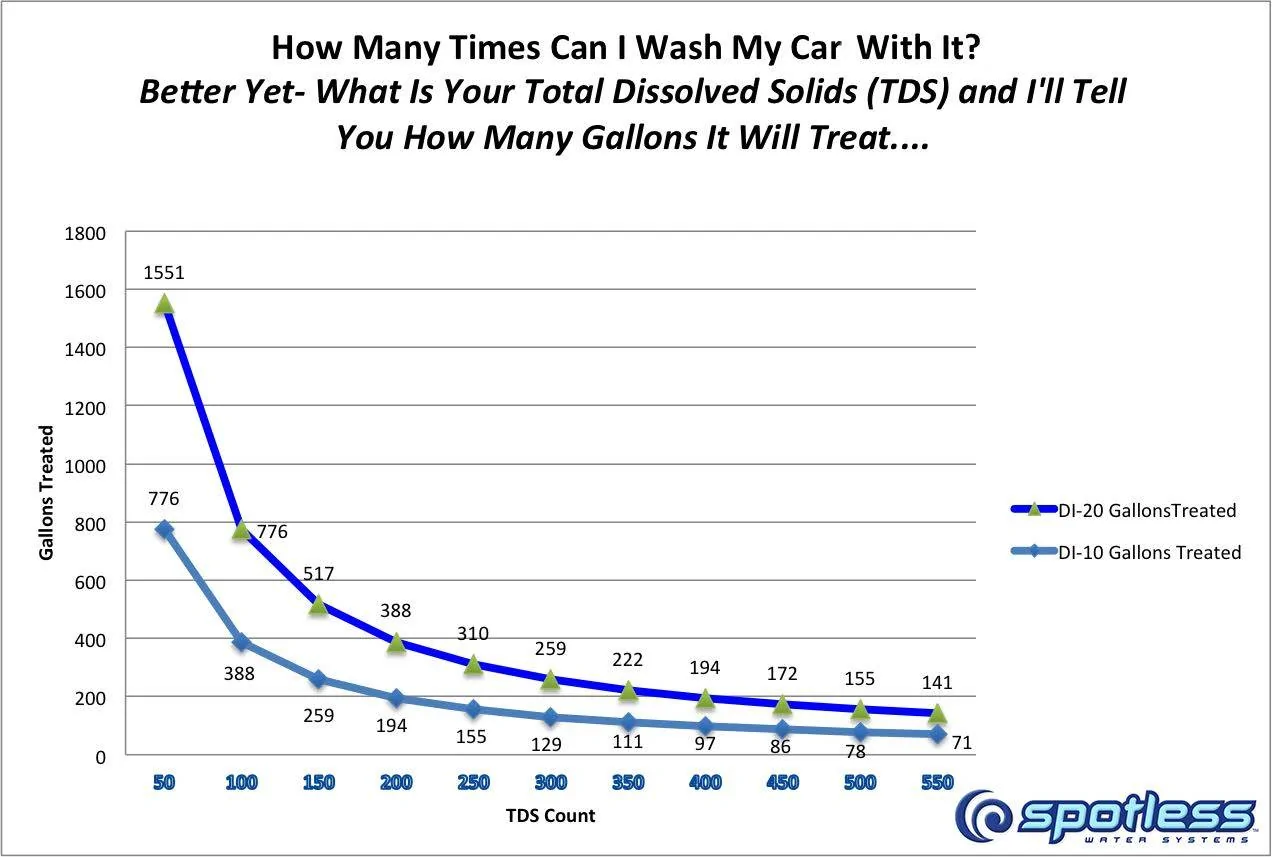

I hear "300 gallons" almost everywhere for the DIC-20 and doing the math, that isn't a lot of rinses figuring as low as five minutes per. At 2gpm from the pressure washer times five comes to 10 gal/rinse in round numbers, based on that "300 gallon" life. End result = 30 rinses.

The time your filters last depends directly on how high the TDS content of the incoming water is. The lower the longer it will last and vice versa.
I've also upgraded my cr spotless to a downtube setup and gets rid of the cartridges so the blue tanks hold more DI resin and they filter more water before the PPM rises.
Check out www.dirinse.com
They have the newer more efficient units as well as the downtubes for the CR spotless. Also have 1 cu ft bags of DI resin for 215$. This will fill a single DI-20 filter 5 times.
DI isn't cheap, but it's not terrible either. The resins are the only cost after the purchase of the unit.
You really only need to do the final rinse with the DI water. Don't use it for the whole wash and you should have no problem getting a season out of the canisters with a fresh batch of resins in them.
