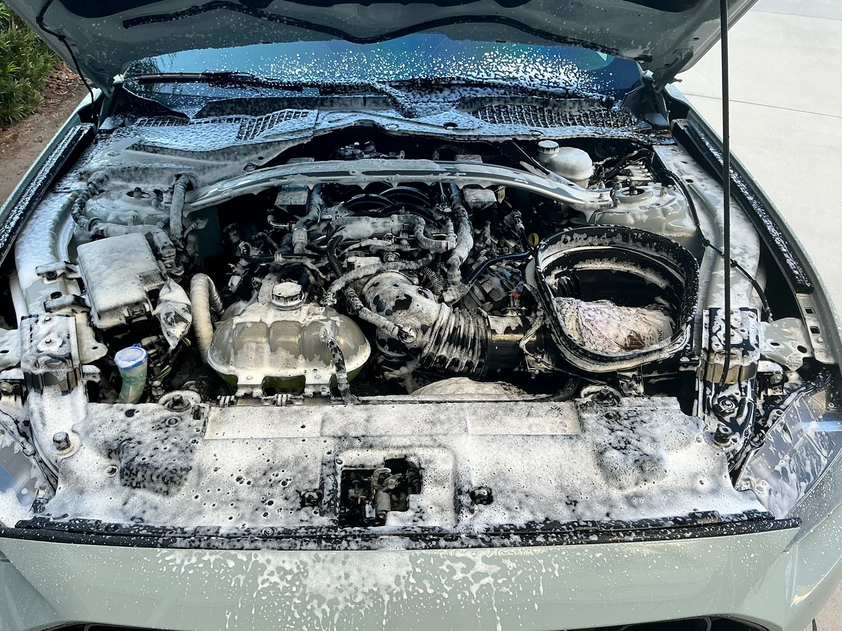

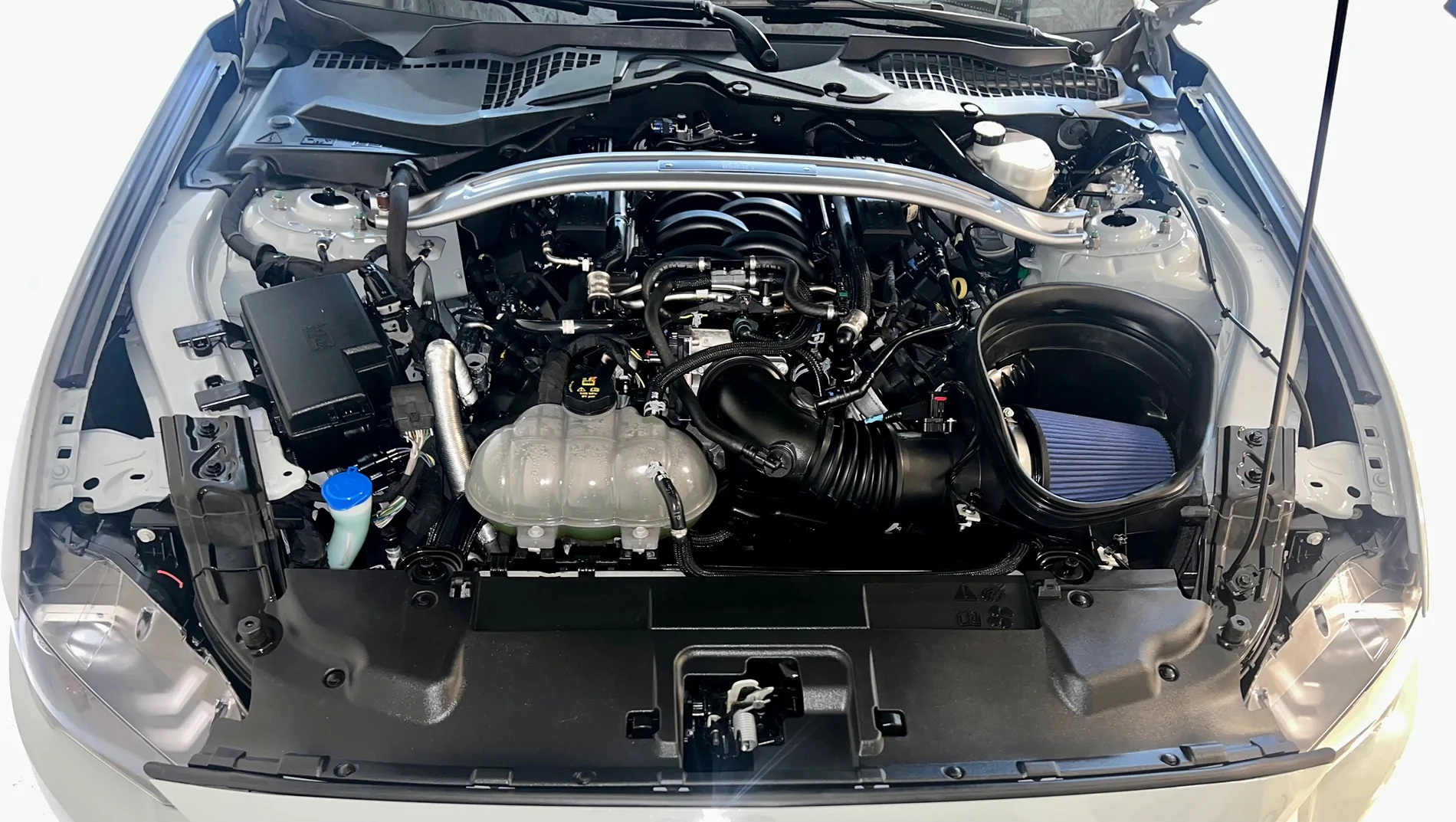

This process worked very well for me.
I only covered the air filter and the big plug. No pressure washer, just a flex hose, brass twist nozzle, a spray bottle for the Koch Chamie Green Star cleaner, and a pump bottle for the Koch Chemie Active Foam. The Koch Chemie Motorplast is an amazing finishing touch.
