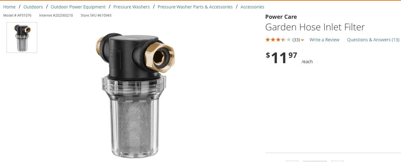

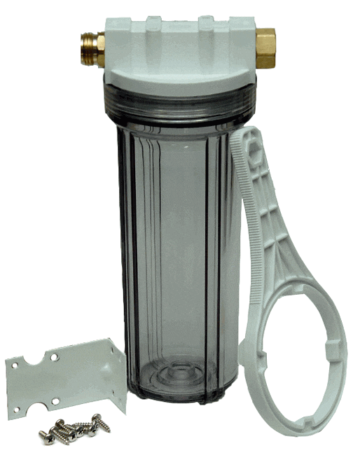

^^^You are absolutely right...it's a mesh and that's it...that's only debris. You need to filter out much finer particulates that cause the spotting. Hence why I posted what I did. The cartridge I have is re-chargeable for lack of a better term. The medium inside the filter is a resin that grabs the stuff causing hard water. The re-charge happens by putting in a bath of salt tablets that are used in big softwater tanks. So after every use, I throw it in that bath till next use. After several uses, I replace the resin inside the filter cartridge. I also use the sheeting method for final rinse and also leaf blower then waffle weave/mf.
Do you know/have a link to the one you have?

I will try and find it when I get home from work...autogeek, autoality, and others have them but more pricey there...I'll see what I can find.
Edit: I couldn't find my receipt for the canister or filter :(, sorry
