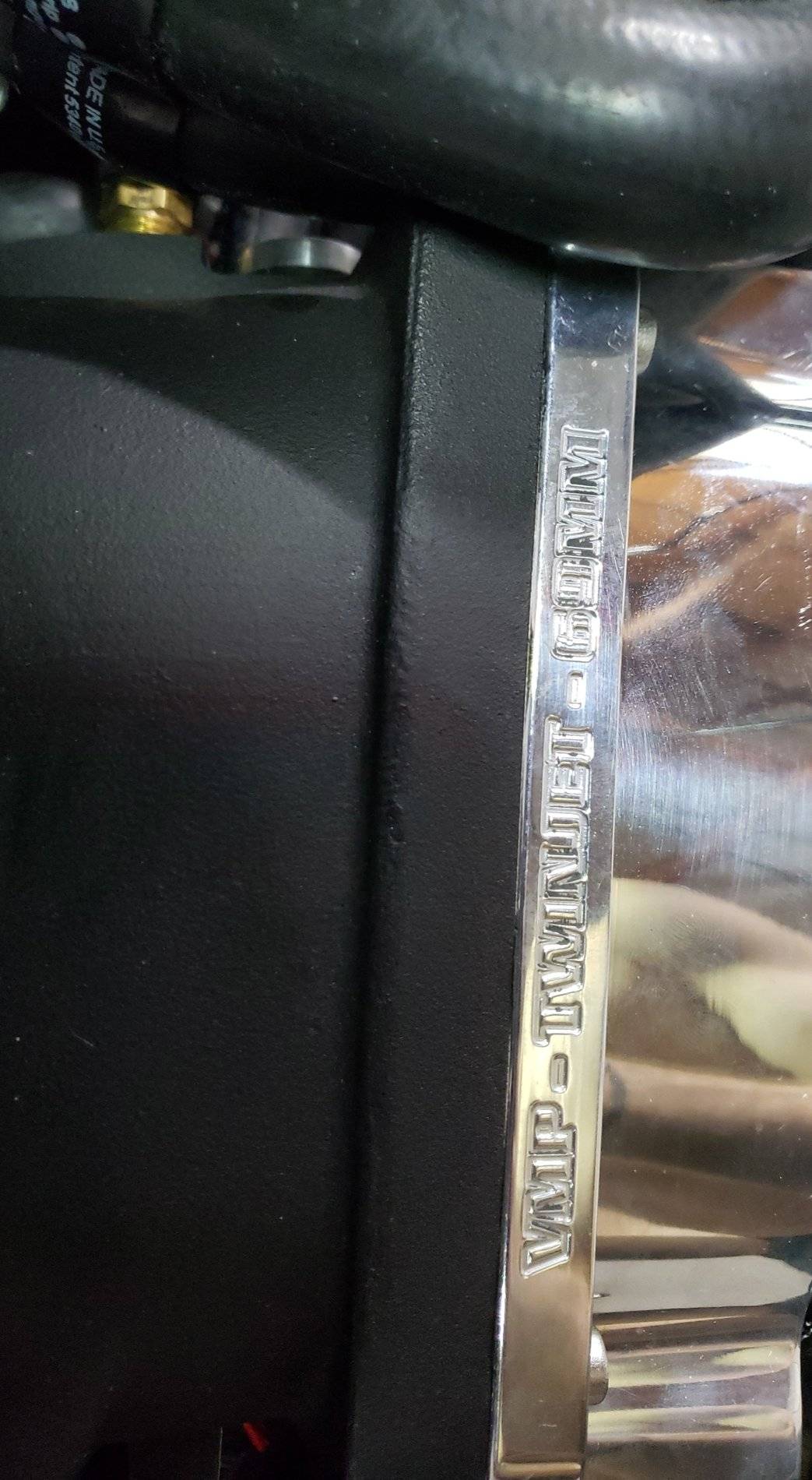

also to note..today while driving around i had a slight sputter and it went into limp mode.
Codes p2112 and p2119. Throttle body codes. Some research on those will show that whipples superchargers and throttle bodies sometimes have this issue. I suppose with the gasket being too thick and the clearances being too tight. Once it all reaches a certain temperature the throttle body components expand and that small increase causes issues with how it opens up. At least thats how i understand it. Removing the gasket and using rtv seems to cure the issue.
It appears this is also an issue with the odin, as it and the whipple seem similar by design. I removed the gasket and applied black high temp rtv for a better seal. Will test it out tomorrow. Farmers tape helped make it less messy.

after some issues and codes p2119 (throttle body stuck open). P0556 (brake booster), p2198 (bank 2 o2 sensor biased/stuck rich), and me smoke testing for any vacuum leaks, checking o2 wires, etc etc, alex at lund said it seems to be a faulty throttle body and there seems to be a bad batch of the twinjet 69 lately. Contacted vmp and they gave me a form to fill out and a shipping label to exchange for a new one. Will update once the new one gets here and ses if it fixed things. Fingers crossed.
Considering upgrading to the 163monoblade throttle body if the price isnt too crazy different, to hopefullg avoid this issue in the fufure. The twinblade doesnt seem to be the greatest of designs from what ive experienced/read/been told.
