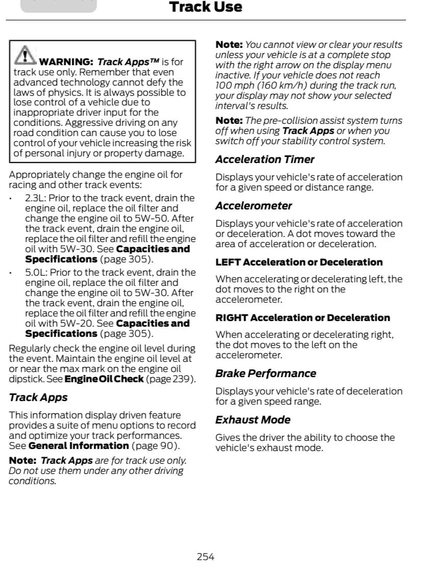

Couple of interesting or curious things, started in Sport+ mode and the Collision avoidance lights kept coming on when I go too close to a slower car? When does that system stop or how can you disable it? Last half of the day was in Track mode.

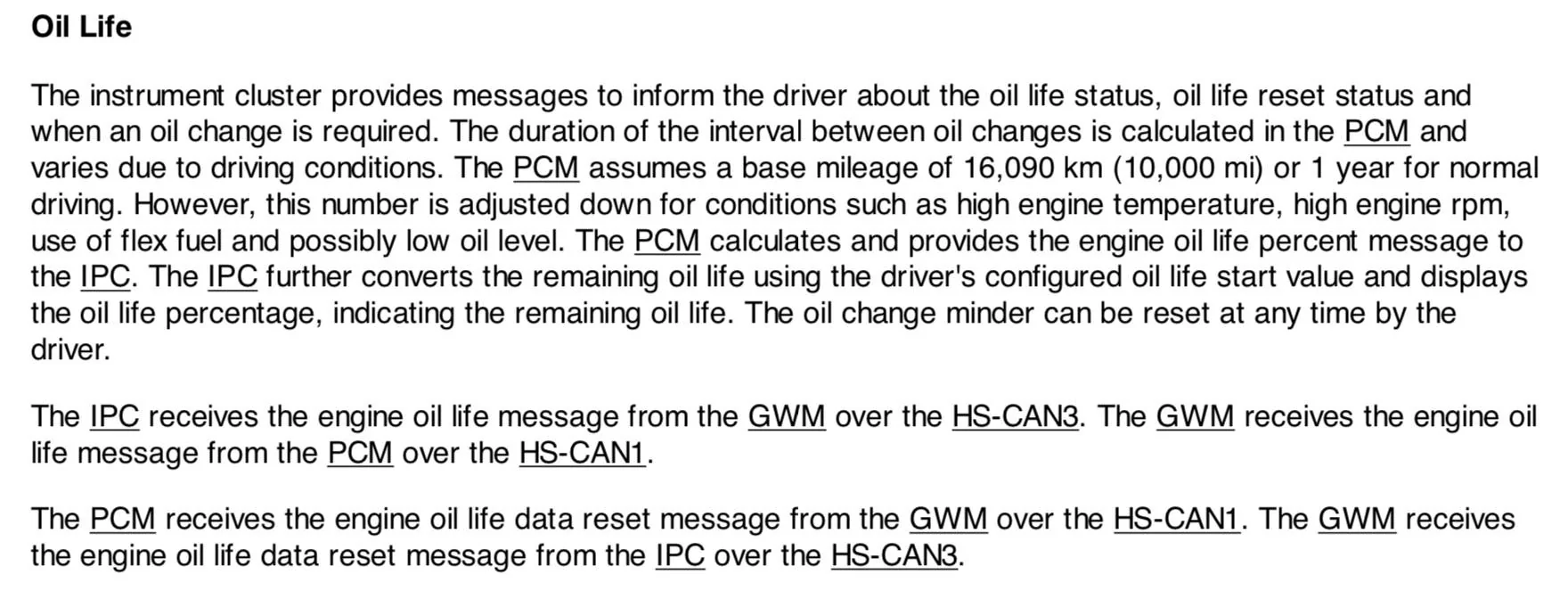

My "smart" oil sensor told me before tracking I had 25% oil life used or 75% left, but on last lap the Change Oil soon came on and now the "smart" sensor says my oil is beat. It's slightly brown now...?

Track mode turns off all driver assist and collision avoidance. If you still want to drive it in some other mode, I beleive these systems can be turned off in the menus somewhere. Likely, they come back on after stop/start of the car. Obvoiusly, don't drive with these systems on while on track.

It seems in Sport+ mode the Driver Assist > Collision menu turns Active Braking on each restart. As I mentioned I finished the day in Track mode so now I'm learning to drive without the nannies. On fluids, my instructor and other Advanced drivers were less concerned about brake fluid but more about after tracking checking brake pad wear and being ready to add track type pads later. The standard Dot 4 is recommended for track. Maybe when I'm able to drive 7-8/10ths I'll need that upgrade. Mostly looking at how those Michelin 4S's hold up after a full weekend.

Track mode is not entirely ‘nannies off’, it still leaves advancetrak stability control in place, although at a slightly higher yaw limit.

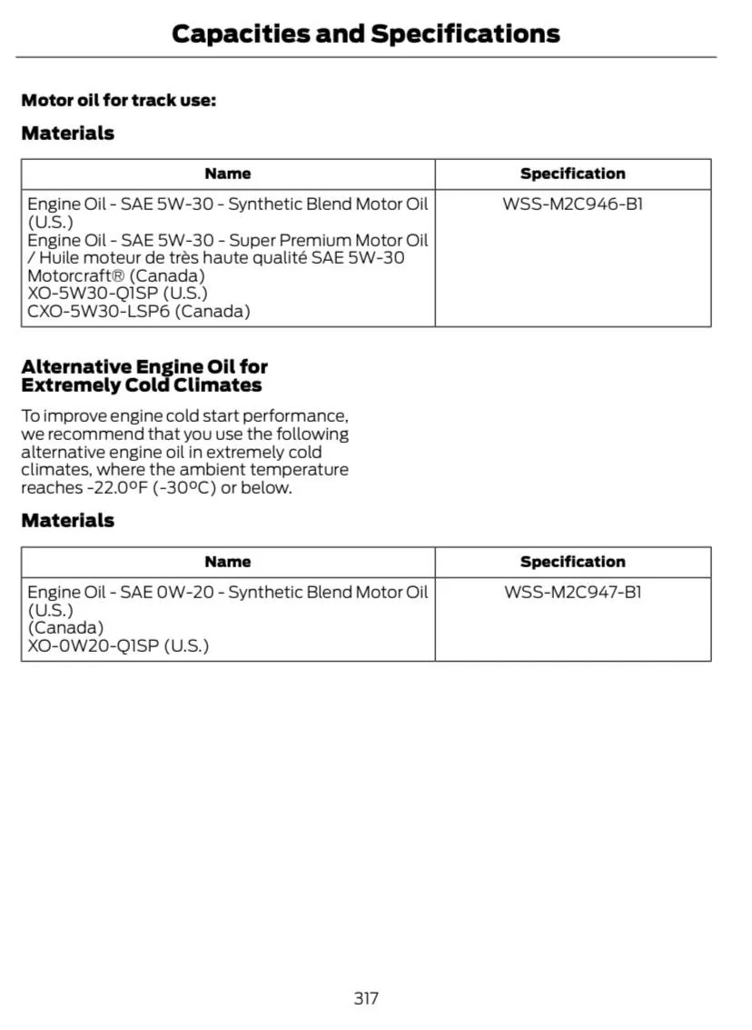

So just an FYI for future reference, as others have said before going to the track it is recommended to check all fluid levels and when it comes to the motor oil, recommended to change it and also use proper viscosity for the track.
This comes right from your MY owners manual for a 2020 pertaining to the motor oil sections
I'm sure others can add more about anything related to track time and oil - just passing the above along, because not many owners of ANY vehicle rarely read through their Owners Manual (me included).
Here’s how the oil life monitor works, per the shop manual:
The timer also counts down as the car sits OR how extreme:hard it's being used (ie: track time). So for those wondering why their Oil Life Monitor is saying you need an oil change after a track event OR when you have only driven 500 miles since last oil change BUT the car has been in the garage for 6 months consecutively... The above is the answer.
