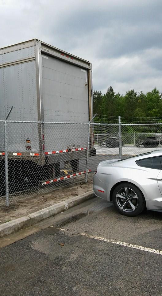

Got my V6 auto back today. Actually took it in this morning and waited. Didn't take long. It's fixed 90% I would say with just a driveshaft. There is still something there, but some of it is the tires, I need to let a couple pounds out, they're at 40psi from winter. It's what I would say is acceptable and at a point that I'll bet almost ALL your cars have that do not exhibit the vibration. Like I said there is some in the wheel at 65-70 but the whole car does not shake and the audible drone is gone. So I can now relax cruising home on the highway, which is all I wanted. I think this problem is varied for all cases. In my case, if some of you remember, my shaft wobbled visibly at the center support. The mechanic who diagnosed and fixed it (who also drives a '14 V6 Mustang) said the new one does not do that. Could it be made better, sure, but I'm not sure it would be easy to achieve. To be honest, I did not think this would fix it as well as it did, just from reading here. But that goes to show how different each car is with this issue. And that's probably why we don't have a TSB. A TSB would have to read.... Replace everything from the transmission back! At this point I'll continue to monitor it and can have them take a look again if need be at next service time. Gotta keep a sense of humor about things. I just don't expect perfection anymore, but I do expect, "good enough". Here's some funny. I parked way in the back at our new facility to keep her safe and I get back to her Friday afternoon to see this. I found it funny.
