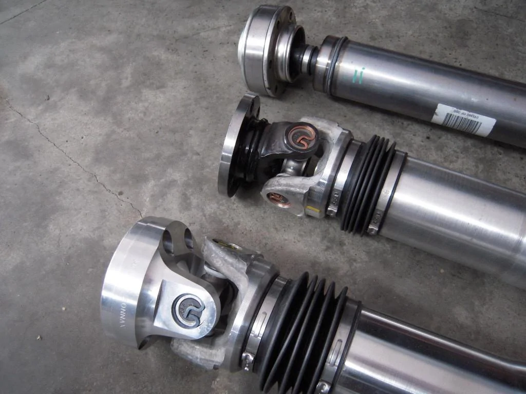

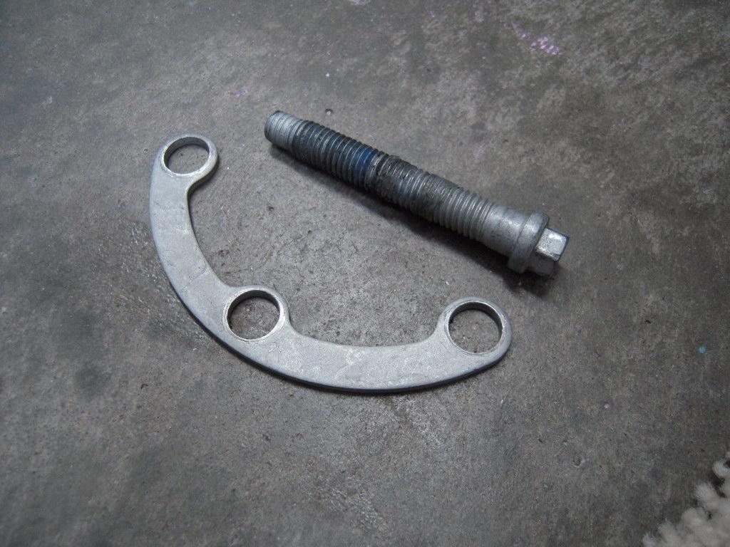

Washer plate - acts as washer under the factory pinion yoke bolts. My GT only had two plates - 6 holes for 6 pinion yoke bolts. 2nd pic is the end of the stock driveshaft (top) compared to Shaftmasters (middle) and Dynotech (bottom) ends. The thickness of these DS ends also screams the importance of making sure both the pinion yoke and DS end mating surfaces are super clean and super flat without burrs, loctite, etc.

Thanks for posting that. My plates only go on two bolts. I just got lucky and found the perfect combination of components for my car. I love the car and refused to give up. I do however fully understand anyone dropping 40k plus on a preimum being really upset. I bought a base at 6k off sticker and really good money on my old diesel truck in trade. I'm in the car really good. Ford should never have let this happen. It does seem to fall in line with the founder's arrogance however. I hope what worked for me helps someone else.
Interesting that both our cars are '17 models and have different DS components. Seems like Ford is making some effort at changing things. :shrug: Maybe if your car is not a PP, that may make the difference.

Glad you got yours straightened out. I tried the shaftmasters DS, but I got tired of trying to get the vibe out of it. The dynotech one wasn't perfect but better than SM. I monkeyed with the balance for several hours, did the trans xmember shims, and got it to 99% good. Just installed the BMR CB005 over the weekend, which didn't do much for my wheel hop but may have cured the last 1%. I'll know more on Thursday when I get it out on the highway for a longer drive. Oddly my stock DS was glass smooth. Wanted the weight and rotating mass reduction, but in hindsight I should have just left the stocker in since this has been a bit of a headache. :headbonk:
BTW, don't mean to malign the SM shaft. It's a beautiful piece and their support and return policy was fantastic... wish I could say the same about Dynotech, which doesn't seem to care if you're happy with their product or not.
