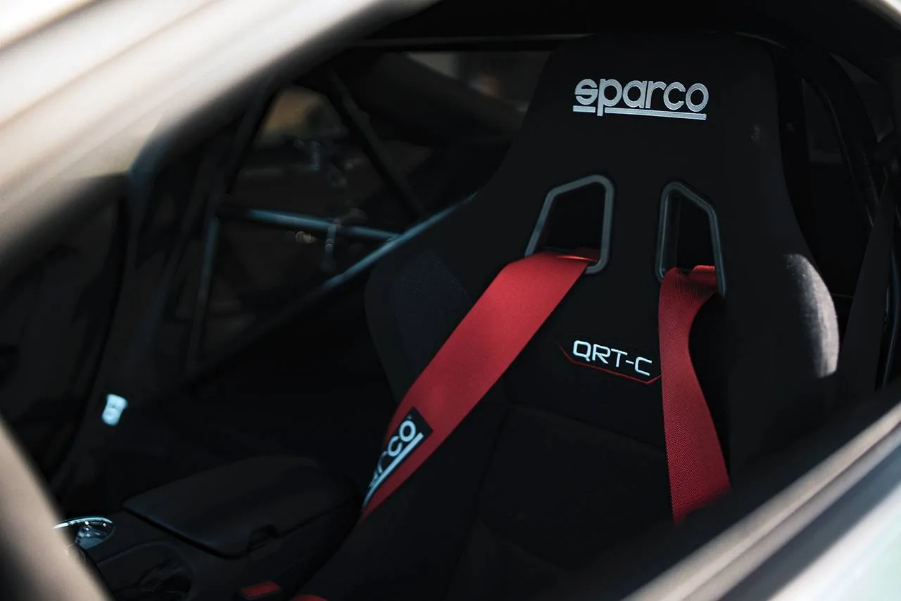

I went with a Sparco QRT-C with their 6 point harnesses and a Watson 4 point cage.
At first I was obsessed with weight savings so I only have 1 seat ATM and took everything non-essential out of the car. Still toying with the thought of HVAC removal. I'll get another seat in the off-season though.

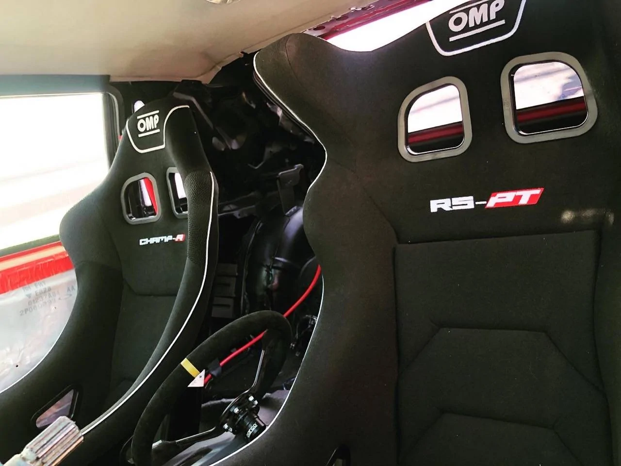

My brother in law went with an OMP set up and I have to say its pretty legit. The Champ and RS-PT seats in his Fox-body are great.
